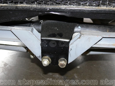

  2. The Allards of the 40's and 50's used this type of front suspension.
    The problem that arises is the large camber variation that occurs due to the arc created by the travel of the stub axle.
    A stout anti-roll bar would be in order to keep it civilized.

    You're better off with the regular straight axle, there are suspension issues that can't be overcome... I'd say spend the time and money on other parts of the build.

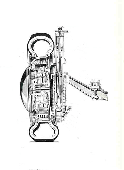

    Morgan's sliding pillar suspension should give you an independent beam axle front end and be period correct. Basically the axle stays fixed and the kingpins are sprung, giving you live hubs I think Lancia had a variation on this on the Aurelia (top pic). Did some playing around with this idea for a hot rod thirty years ago....
    Here are a couple of links:
    <cite>www.[B]morgan[/B]ownersclub.com.au/.../<wbr>OF%20SLIDING%20PILLARS%20AND%20AXLES.pdf</cite> -
    http://en.wikipedia.org/wiki/Sliding_pillar

    Here's a shot of the sliding pillar front suspension on a Lancia Appia....
    [FONT=verdana, arial][FONT=verdana, arial][FONT=verdana, arial][FONT=verdana, arial][​IMG][/FONT][/FONT][/FONT][/FONT]

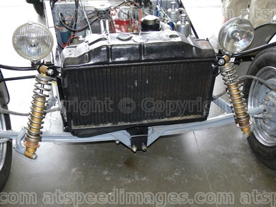

    Check out the front suspension on Allards, Designed by Leslie Bellamy in effect a beam axle cut in two and mounted centrally[​IMG]
    http://www.thoroughbred-cars.com/cars/UK/allard/Allard%20history.htm
    Apparently there conversions similar to this were available in the UK in the 50's and 60's to special builders (the next best thing to hot rodders) based on the Ford Pop and Anglias. I have seen adverts for these but I couldn't find anything with a quick search, I may try again later.

    I think that Limey Steve has restored an Allard for a customer there was a thread on here, that may help.

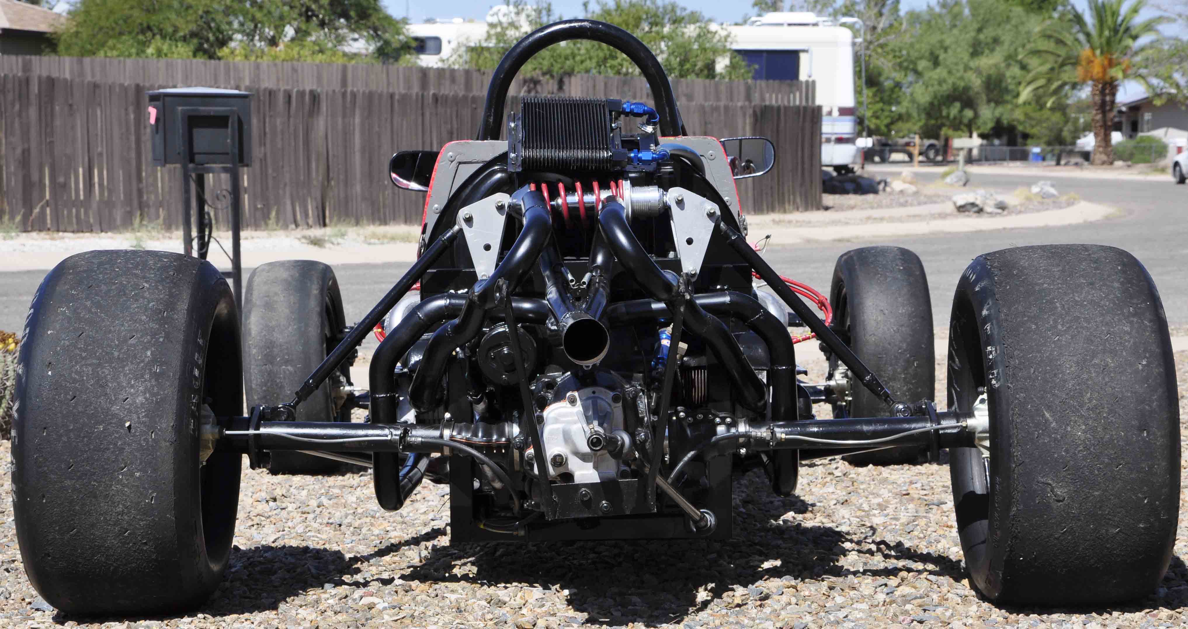

    Some more cool Info....
    Colin Chapman used twin Ibeam IFS on cars like his MK6, which were short and tucked under like the Allard.
    But also on his later and super succesful Lotus Eleven.
    ( Offset pivot points, and low rollcenter)
    The Eleven got replaced in time by the Lotus Seventeen.
    It had McPherson IFS which did not work at all, and the Seventeen did not have the succes the Eleven had.
    ( the struts were too short which was needed because of the low slung bodywork, which made them bind )
