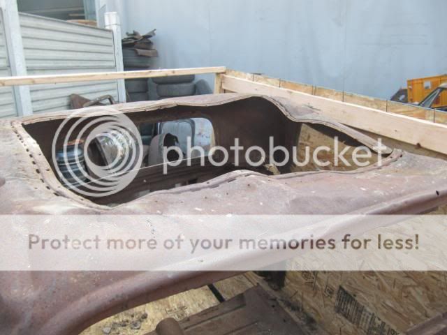

    It took a while to organzie transportation, but finally the poor 3 windows has arrived here in Italy and have started the long process of restoration.
    I have placed the warped body on a good frame, bolted the cowl and an original firewall that I had saved for a special project and have started to work from here. Found the centerline of the car, and welded a long bar to the cowl and rear crossmember. At least have some fixed point. Then took two other bars and welded them in same position to left and right of centerline, to make sure the car is square. Removed some sheetmetal in the back to help get the car back to shape, since it was warped. Then before any other work was done, took an hammer and tried to get the roof back to shape. Some progress here. Same thing was done to pass side quarter, now it's welded back to the rocker panel.
    Then started to work on the subrails, pass side was missing a good 10 inches, driver side 25 inches. Luckily Dan has provided me with a good rear floor, so can take measures and shape from this part.
    Here some pics of the car as arrived to my place

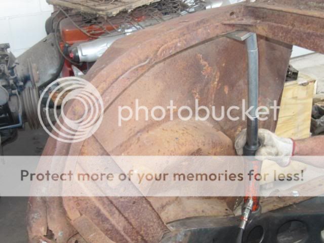

    Some bracing to put the car together

    some more bracing
