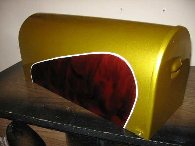

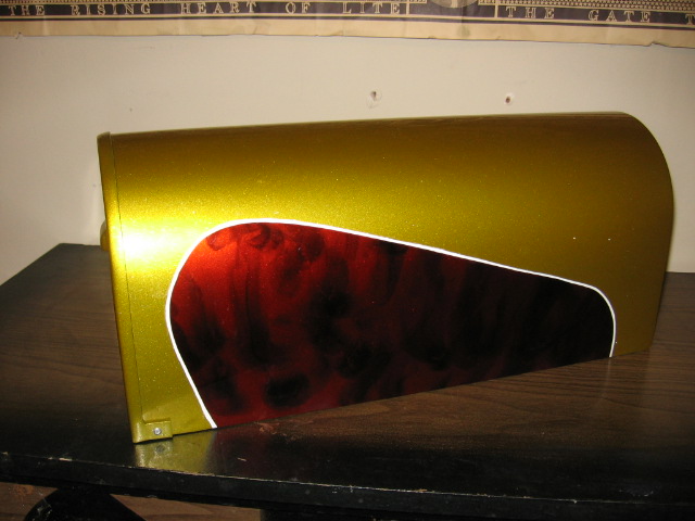

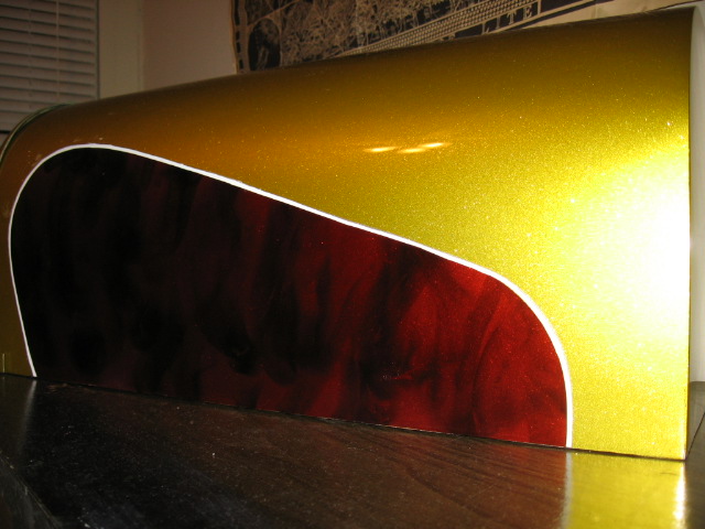

    Here is some I did on a mailbox. I think it has potential.
    Sprayed my base, and let it dry, then acetylene smoke. Then Kandy. Then Clear.
    Sorry for the awful pictures...and the awful mailbox!:p

    I've heard of the acetylene smoke trick before , done on garnish moldings & stuff . The whole dash & steering wheel looks cool , but maybe a bit much for my taste . The mailbox looks like a cool way to experiment - good job !
