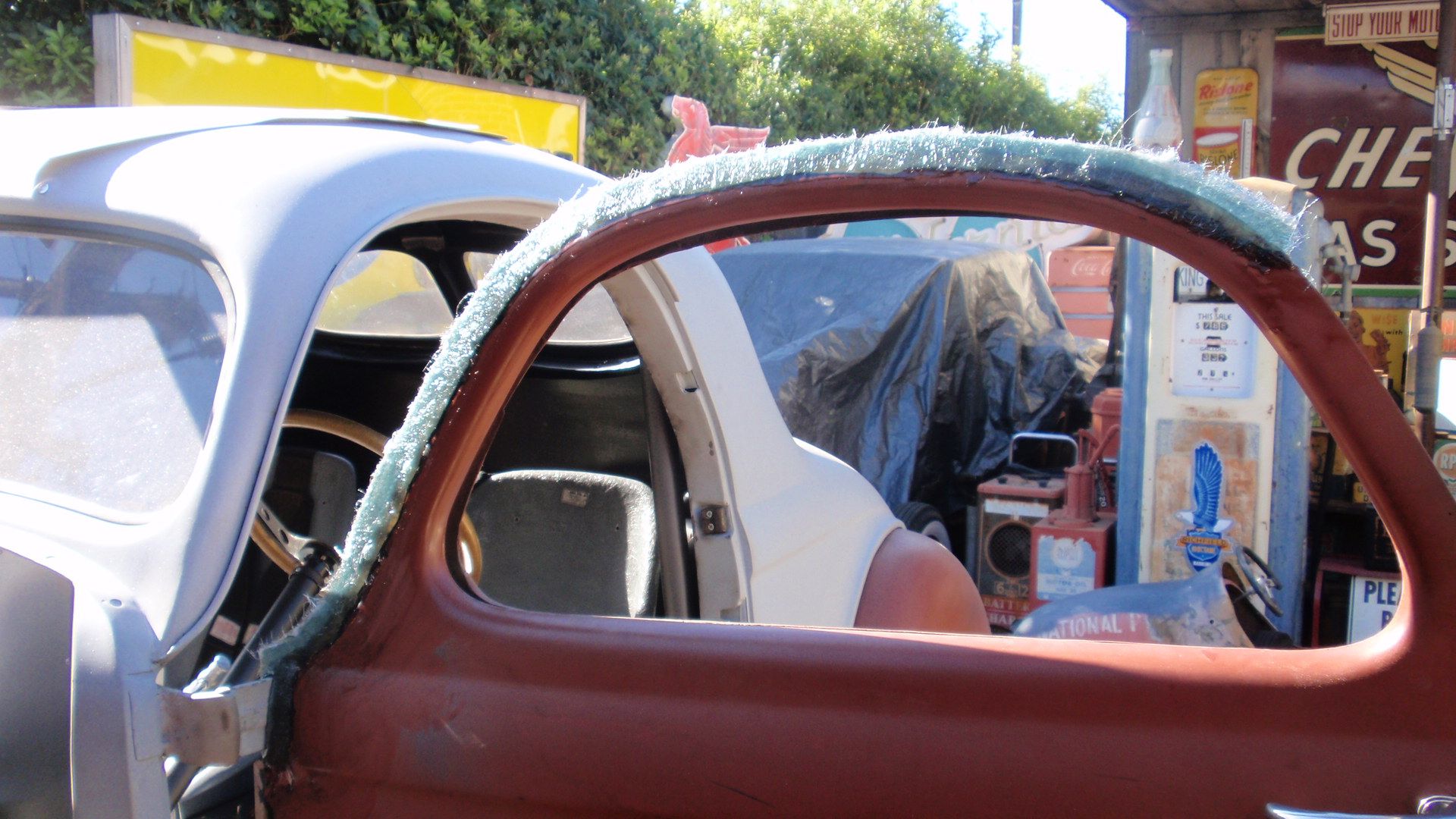

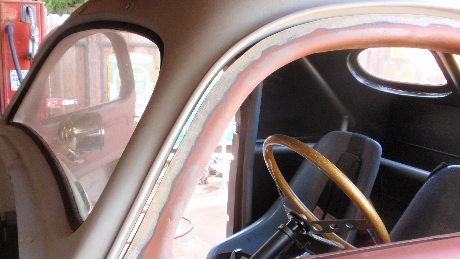

  3. The door gap on the drivers door was really big on the top front corner. You could put your finger though it so I sanded that area down and built it up with fiberglass (the doors are old race 'glass from the 60's). I don't have an "after" pic right now, will post one later.

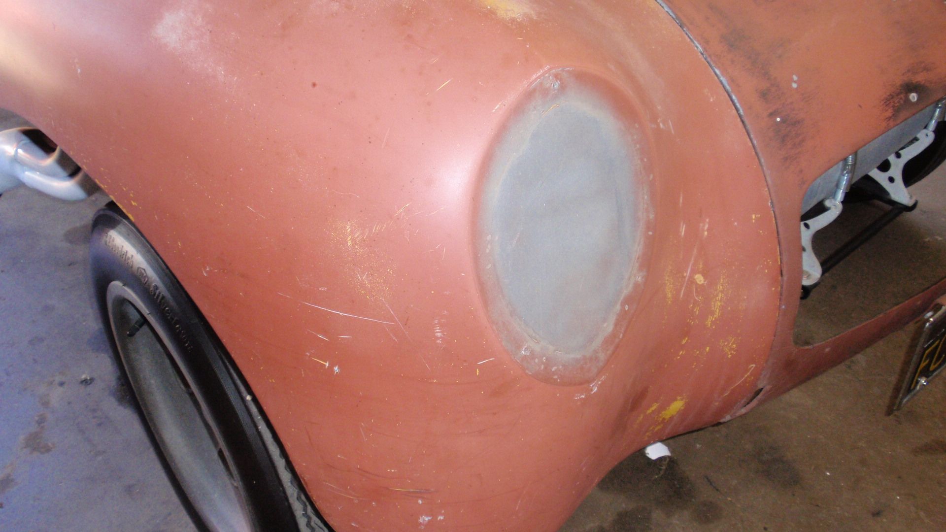

  12. The fenders had flat areas where the headlight goes . First I held the ring in place and marked the ID with a pencil and cut it out. I had two buckets that were a perfect fit but they weren't Willys parts, I think they are Ford. I bolted them in place. The tricky part was getting a sealed beam bulb in there as they were empty.
    I got a couple of headlight mounts from a 63? Chevy pickup (dual headlights) and cut them in half. I welded the same side half of each into the buckets and that gave me the mounts and adjusters. I also added a socket at the bottom for a turn signal bulb. Pretty easy and low buck.

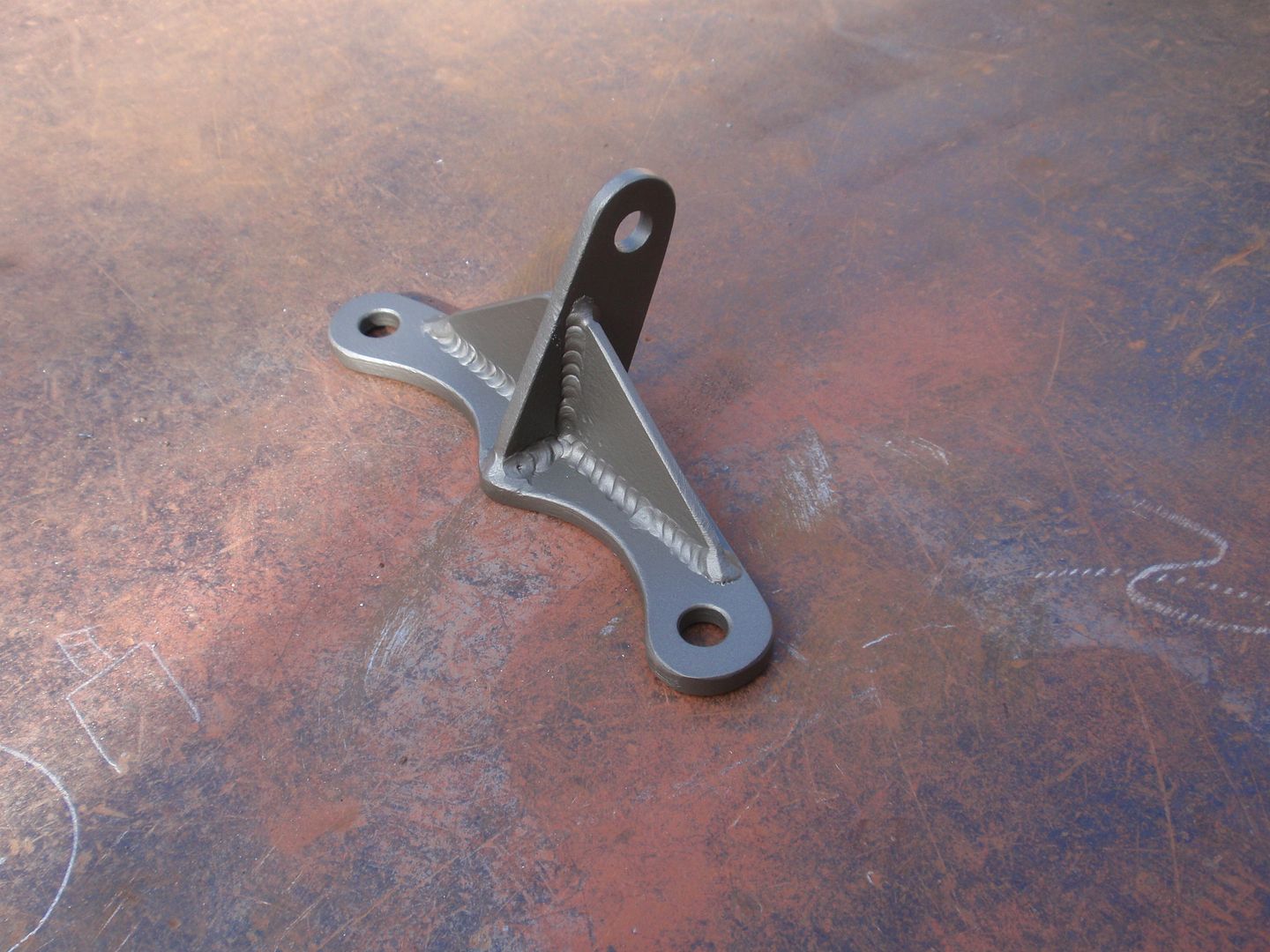

  15. Here is the alternator mount I came up with. I wouldn't call this alternator period correct but then again I don't really give a shit. I just wanted something small that I could tuck down kinda out of sight. It is from a Chevy sprint. I have tried hard to give this car a real mid 60's flavor but I am just not super picky about being period correct on every detail.
    I also made this brace for the Ansen pedal assembly because when I pushed on the brake pedal the pivot rod going through the two pedals flexed like crazy.
