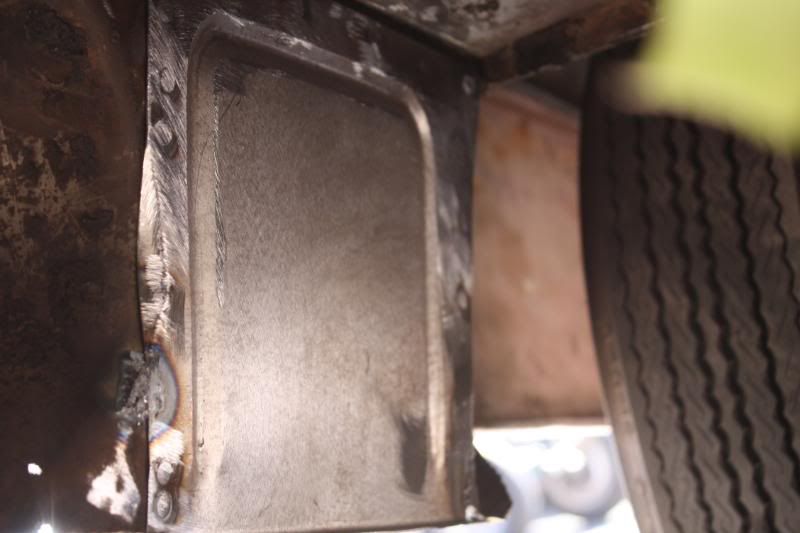

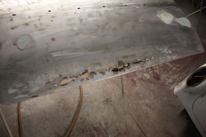

Like I said this is a very minimal rust car. Nice change of pace. The main issues where the left and right rear quarters, bottom of the passenger door, and the drivers side rocker. I wanted to get as much done as possible before i left for X-mas break. Here's the damage... Some of the stuff i didn't get pics of. This was some east bound and down shit. Here's some of the patches I fabbed... I still lack fixing the rust in the drivers side rocker. Everything was tacked with MIG, then TIG welded.

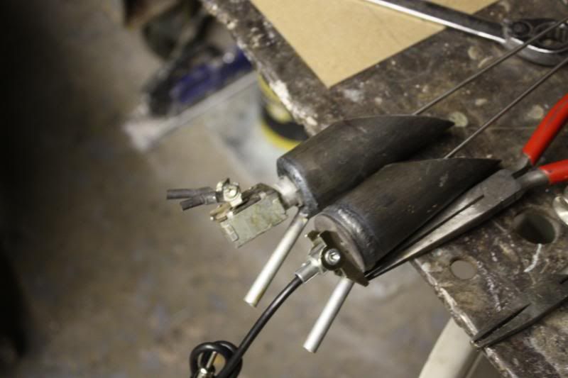

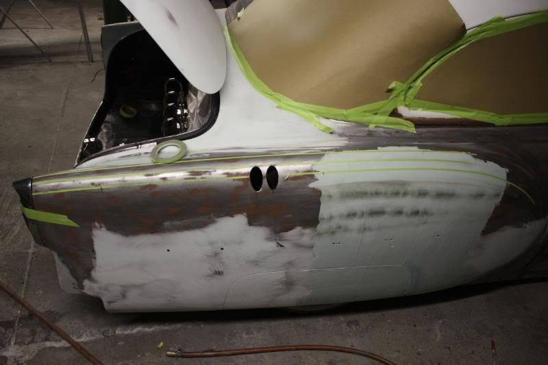

On to the custom stuff. Roger wanted the gas door, handles, badges, and lock cylinder shaved. Here's the patch for the gas door. This guy I gas welded in being it's on such a low crown panel. The whole rear of the car is already in primer, so this was the only pic I've got. Plus no pics of the holes for the handles or lock cylinder welded shut. Here's where I geeked out a bit. I've always hated that wire that come with door popper kits, plus I wanted to build this shit like a tank. There was a bunch of carb linkage stuff laying around, all ball and socket joints with threaded adjustable ends, lock nuts, 1/4 inch rod, so I used that stuff to fab all the linkage. Here's the setup mocked up on the passenger door and here's the linkage and setup on the trunk Super Massive overkill. But you know what? I doubt he'll ever get locked out. He was on the fence as far as frenched antennas. I put together a little "presentation" to try to persuade him, and he dug it. They are such a guilty pleasure for me. haha. I made the housing out of DOM tubing. I always forget to index regular tubing with that welded seam! haha. Also notice that one serves as a functioning antenna, and the other serves as a push button, for super secret shit. the antenna masts still need to be trimmed down. I know they are not electric, but it's just the way I like to do 'em, and Roger's stoked.
He also wanted to do 55 chevy headlight bezels. When we started this build I dug through my little books from 56 to 59 for inspiration, and found a 54 with the most gorgeous execution of 55 bezels in a 54. I used that pic as a guideline. I also had been givin a link from the hamb of a swap someone had done, and theirs did look good, but for the life of me i do not see how it was done in so few steps. Here's what I ended up with. Sorry for all the pics of that headlight, I just had alot of fun doing it! Not bad for 2 weeks of work. Most of the car is sitting in primer. I still got a bunch more to do. Hopefully after the holidays Roger should be helping out a bit at the shop and we can get this bad little girl knocked out. Plus I'm working on him to let me spray some of that murano I've been sitting on. We'll see what mysteries the future holds.
