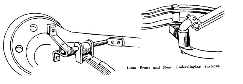

Fellas, The brackets move the axle up and out in front of the spring. Here's a rough drawing; (front brackets shown on right) As far as construction, the originals were made from manganese bronze. There were many other 'underslinging' brackets that were made the same way...

Fearnoevo & Bob, Appreciate the help. Here's what the brackets look like mounted up. (You're looking at the bracket that goes under the axle and between the spring perch and the wishbone). As I said, they originally used a bushing in the spring perch 'hole'...but I don't know if that was just a precaution that was made due to the material involved....I'm completely open to suggestion on material & construction details. Thanks
