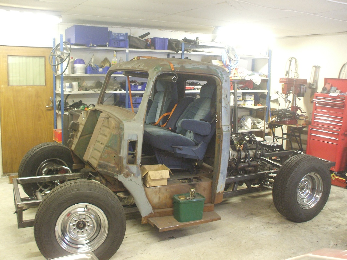

    Hi there
    I'm Toni from Sweden and I´ve been asked to present my humble project here.
    Actually, this is just some car ideas put to life to see if they will work.
    I want to build something odd, something that not are that common but still could have the label "Hot Rod" or something.
    So, 3 years ago I bought some car parts that should have been a Brittish Commer from 1951. The only one that been imported to Sweden. A pick up without most of it parts. My avatar are from an original sales broshure.
    The goal is to have a rather quick sleeper that also can handle well on the track.
    On a budget!
    No fancy stuff, can I manufacture it by myself, I'll do it. The salvage yard have almost everything I need. Renovate if necessary.
    The frame is a square steel tubing construction with the Audi V8 engine in the middle, home made independant suspension all around.
    So far the chassis is ready to 99%, the bed will have a hole so the engine will fit under a "secret box". But the sheet metal work is still to come.
    Opinions and questions are most welcome.

    That's one ugly truck. Should surprise a few folks with it's speed. Welcome aboard the HAMB. Pics when you get it together?

    Pics of what you have now too, and the current shape of things, please

    It will come, but not now. It's over midnite in the old world now and someone have to work, they say...
    Thanks for your intrest.

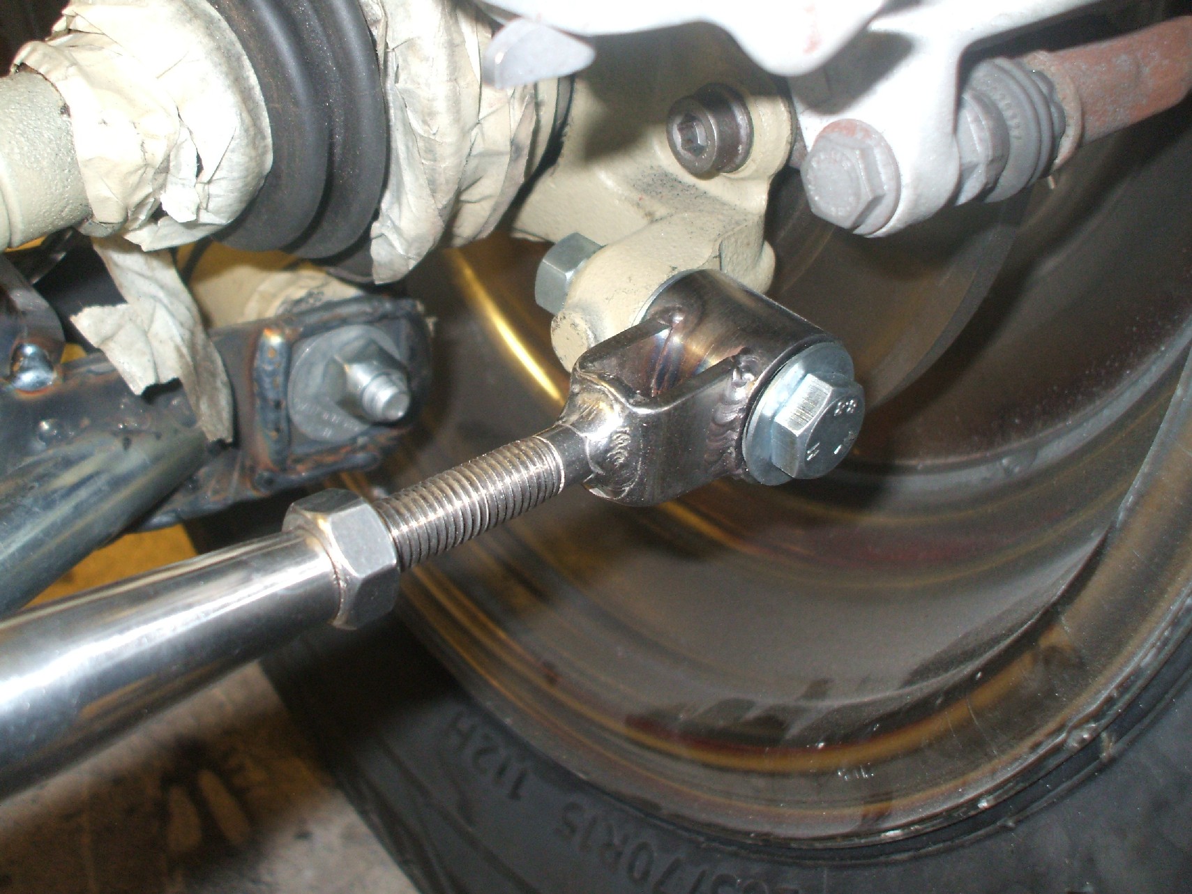

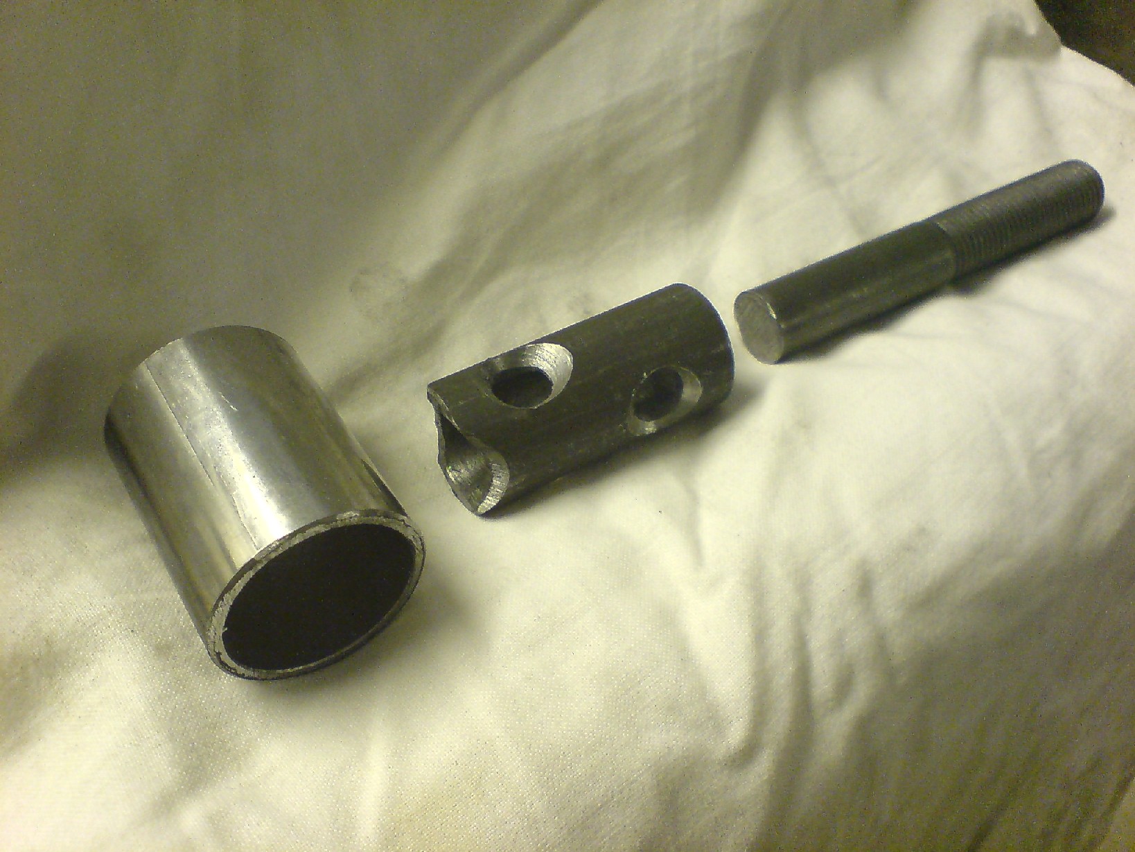

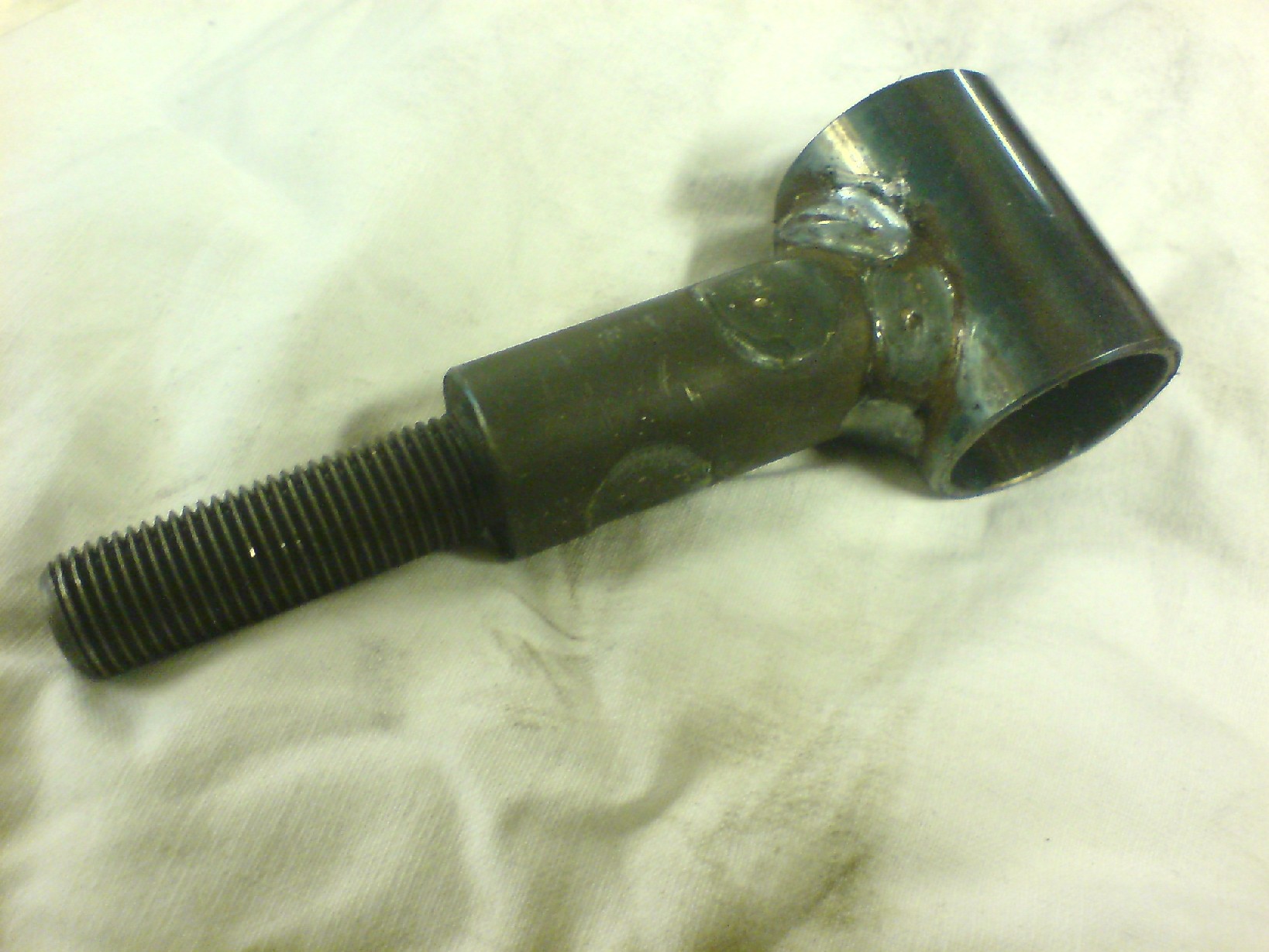

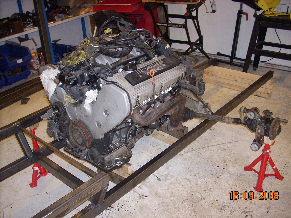

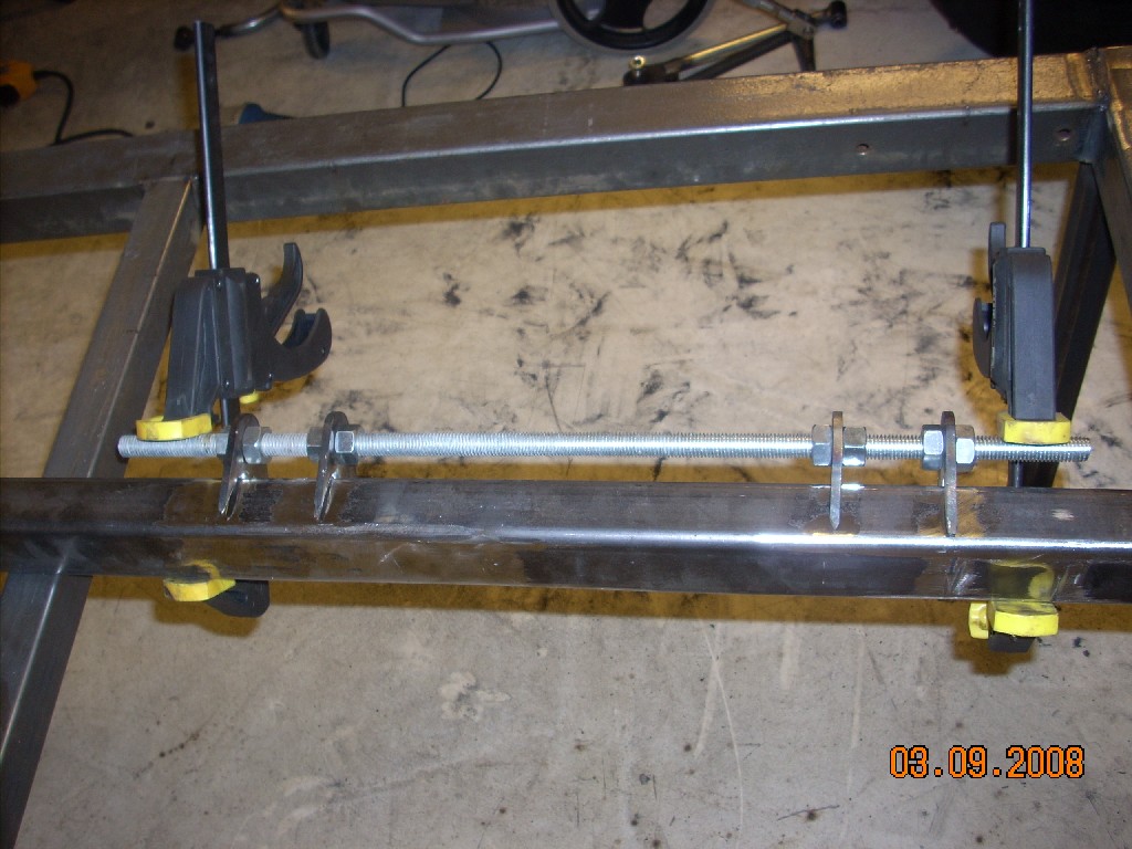

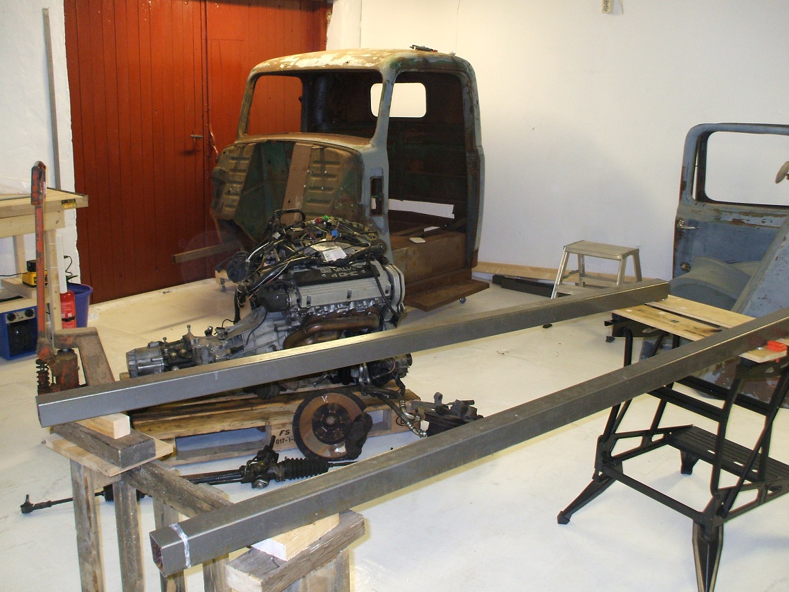

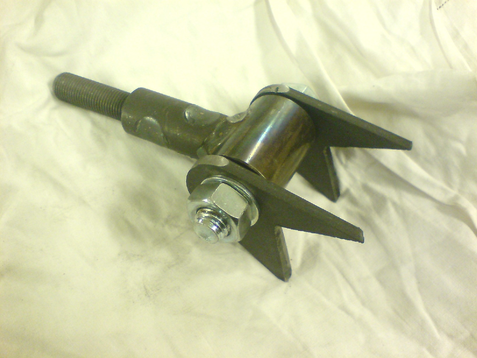

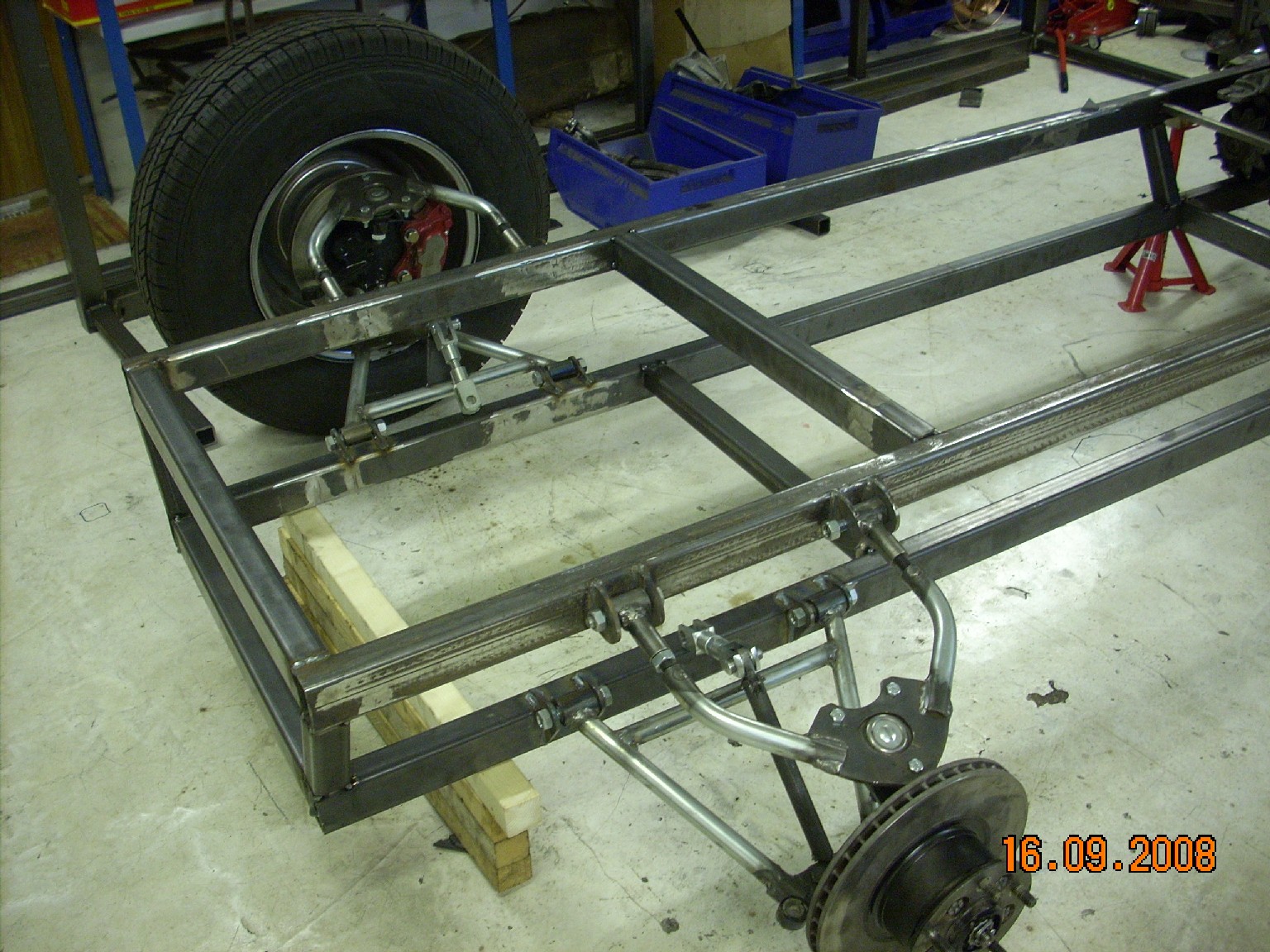

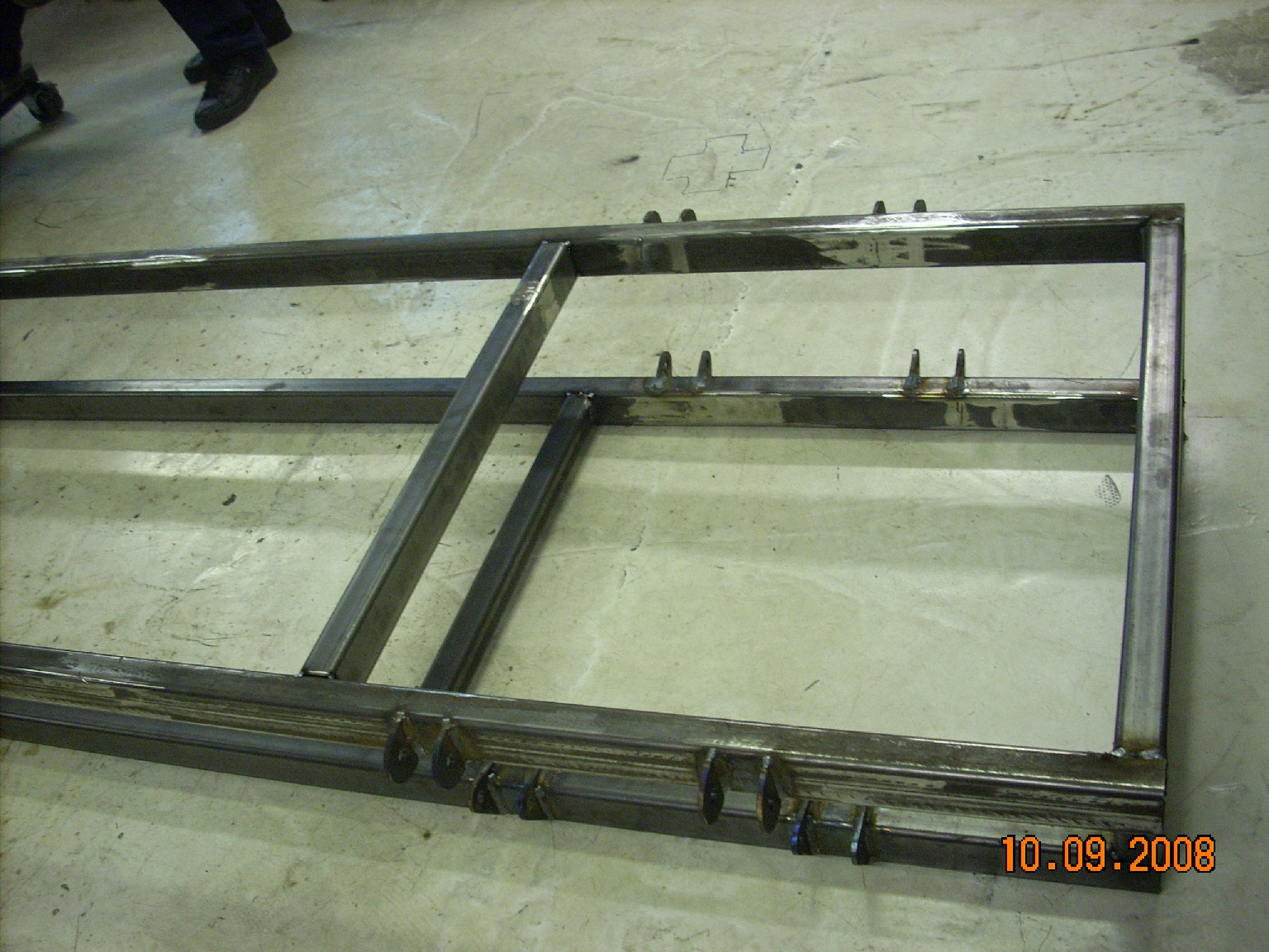

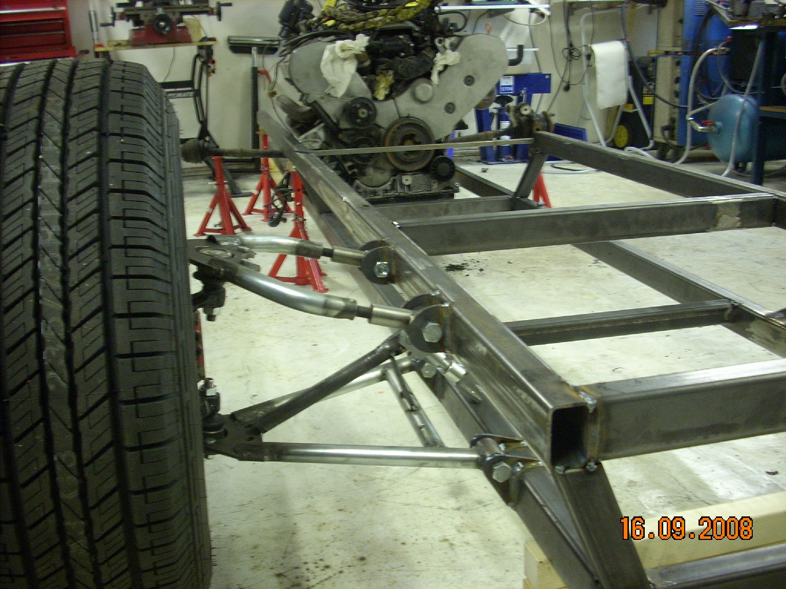

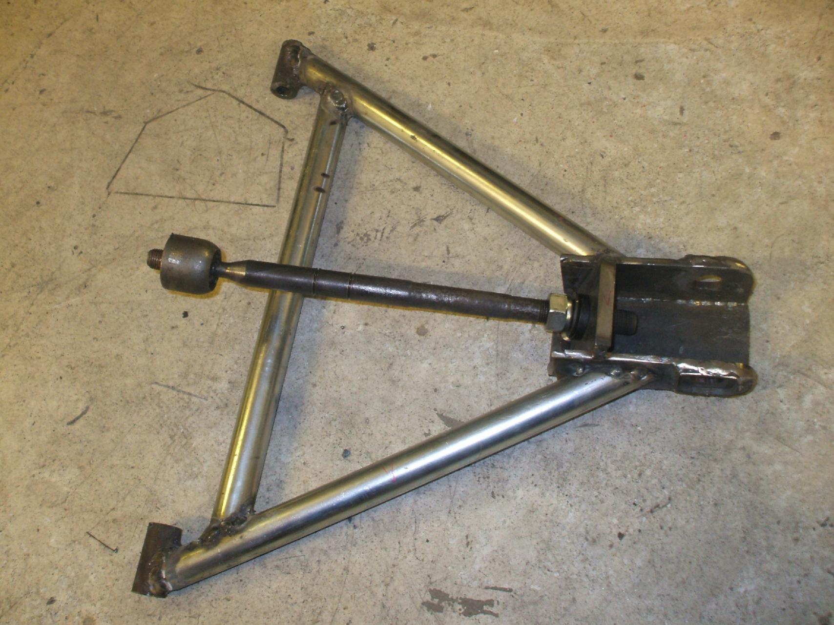

    The beginning of the build was to manufacture a frame.
    The aim was to get a low point of gravity and good cornering capabilities.
    Since i never build a car from scratch, I have stolen, copied and borrowed construction ideas from all over the world. Spells "INTERNET".
    So, two square frames on top of eachother with 170 mm space between, the upper 130 mm wider than the lower. That gives me attach points for the upper and lower A-arms (control arms) with a good geometry.
    To be able to get the vehicle thru the inspection, I have tried to document the different parts and the way I've done it. As an excuse for maybe too much details...!

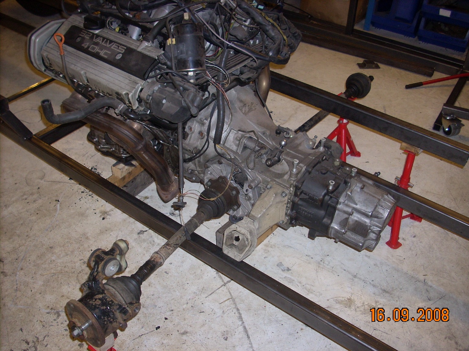

    The drive train comes from:
    Audi 200 -92 (engine),
    Gearbox 6 speed man. and driveshafts from Audi 100 2,5 diesel 1994 front wheel drive
    Rear uprights with brakes from Audi A6 2003 four wheel drive.

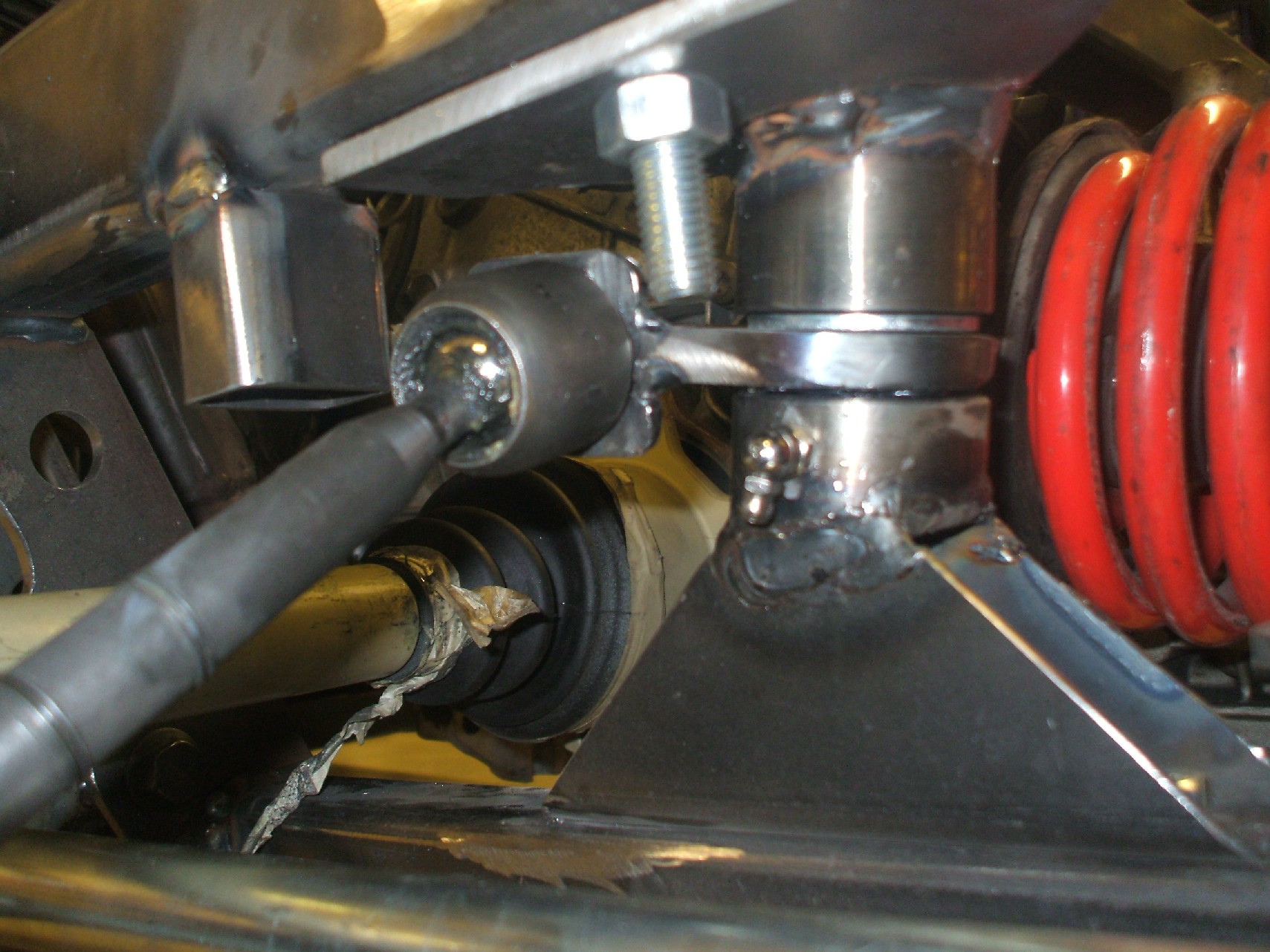

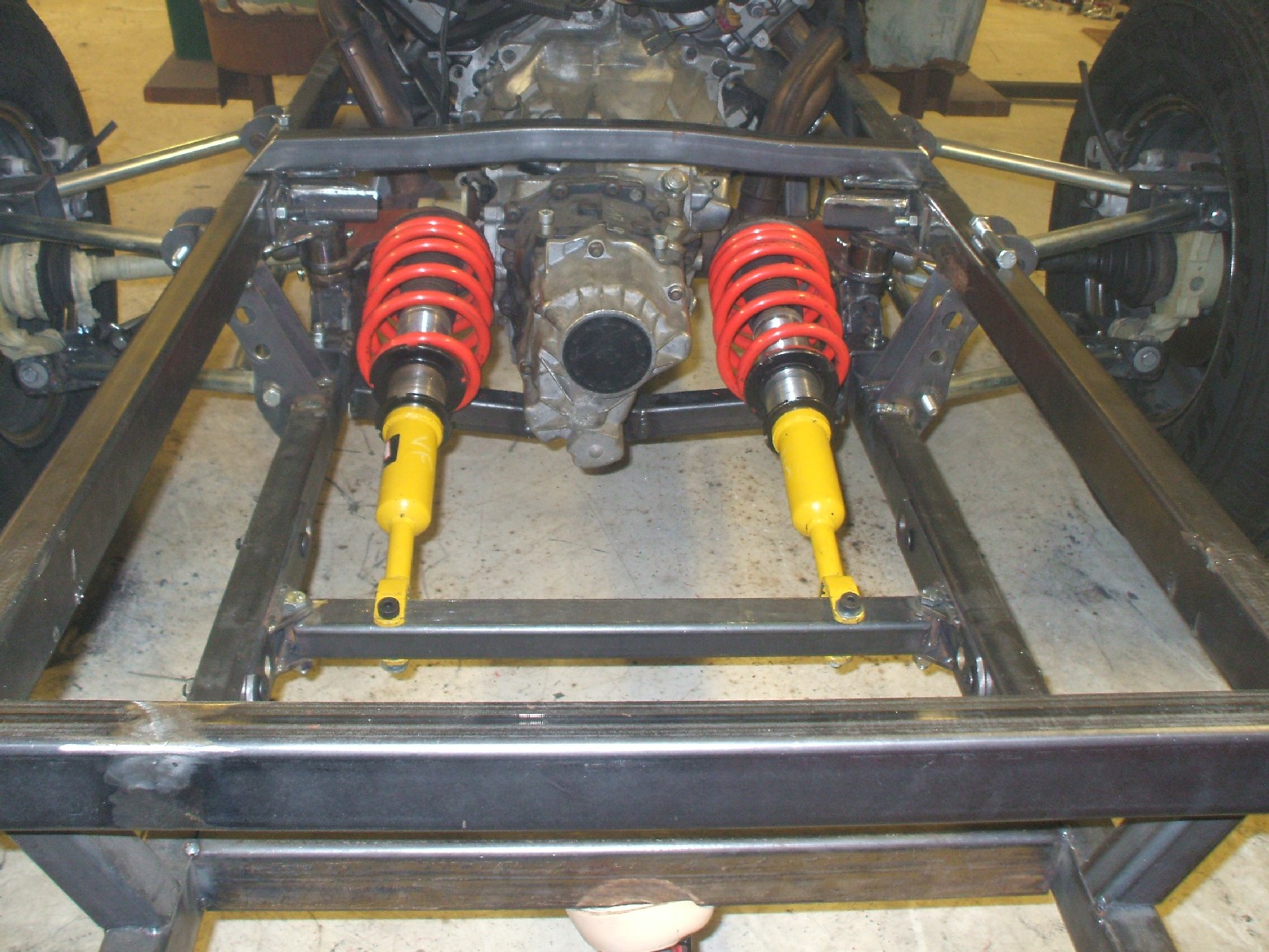

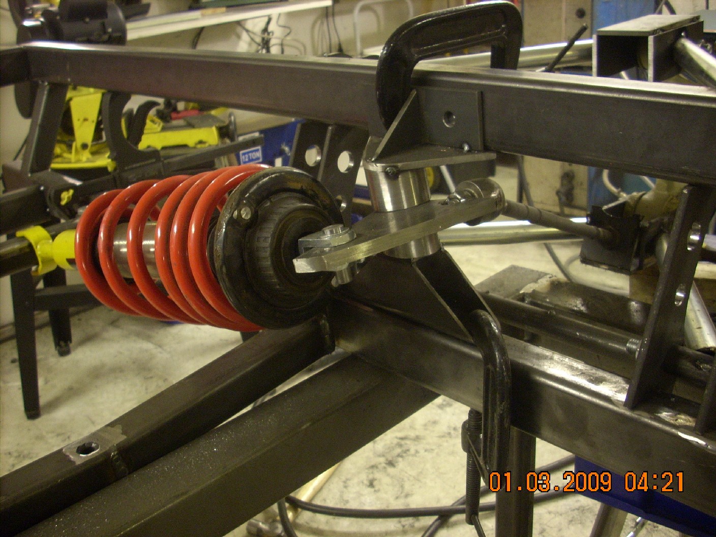

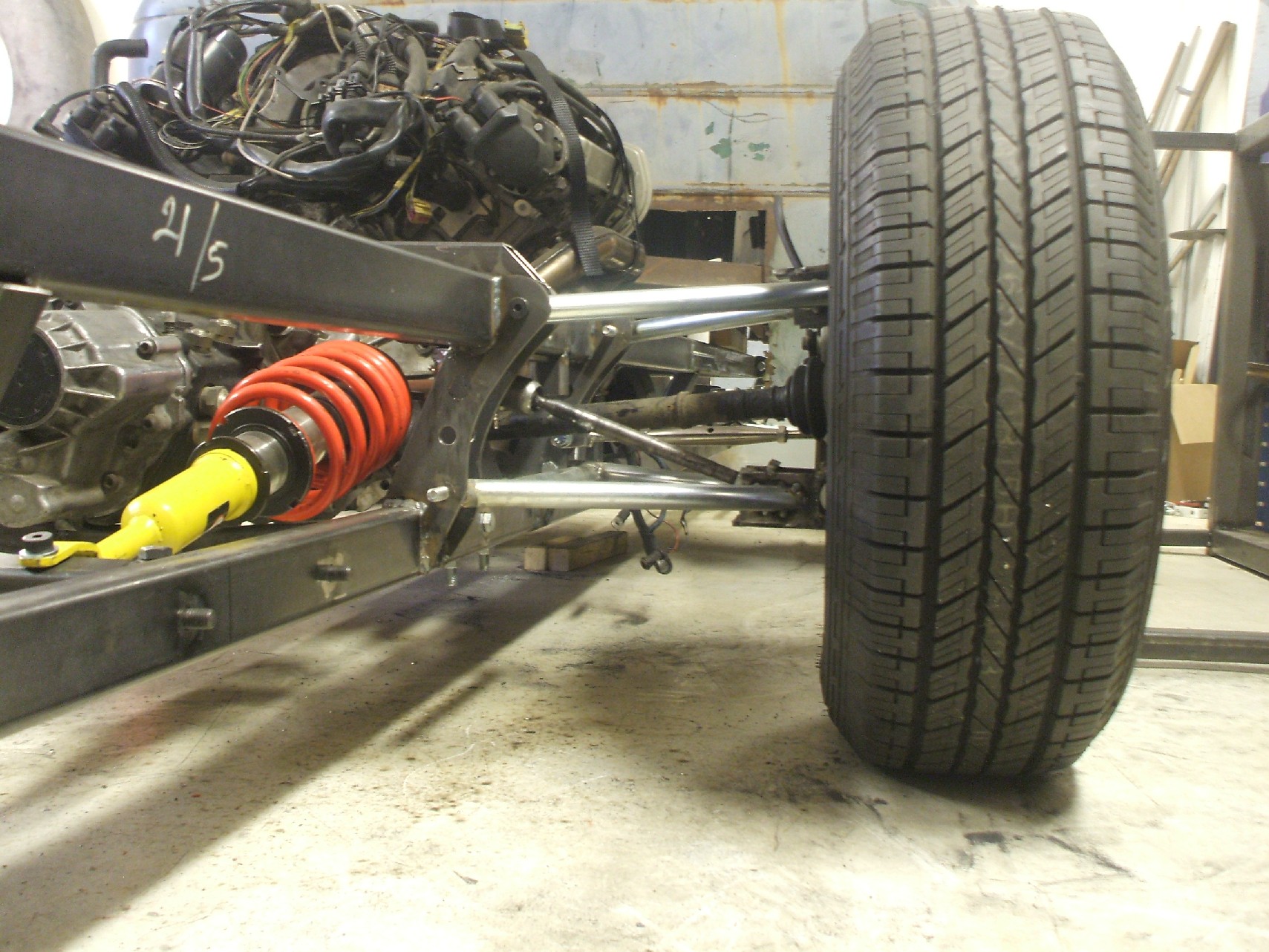

    I have looked a little bit on the Formula cars when I designed the rear spring "department".
    Unfortunately the real titan, carbonfibre and other excusive materials was slightly above my budget, so I took what the salvage yard could offer me.
    The rear springs comes from an Audi A4 that somebody first tuned with front sport struts and then wrecked the car. Thanks alot, buddy!
    Now I have adjustable springs and stiffer dampers.

  21. Commer
    Joined: Aug 12, 2010
    Posts: 77
    Commer
    James D, yes I considered that for a brief moment, but I thought it was complicated enough!
    The Four wheel drive gearbox have the longtitudal (?) driveshaft pointing backward, so it had to be... very complicated.
    But maybe next build!
    B t w, the Audi components just fit perfectly together even they are from different cars. If you want to do it even more simple, take the whole drive train package from a front wheel car and move it backwards.
    Thanks
    Toni

    QUESTION! I'm confused about what the drive train is... That is a Front Wheel Drive transmission from an Audi 200 or just the engine is from an Audi 200 and the transmission (or is that a transaxle???) is from an Audi 100 orrrr..... Quattro?? Orr??? What the hell??! I think I need more clarification... HAHA! :eek:

  28. Commer
    Posts: 77
    Commer
    Sorry for the confusion, Mixed up transmission and transaxle. Let's just call it "trans" :confused:
    The engine comes from a 4-wheel drive Audi 200 Quattro.
    The gearbox and drive shafts comes from a front wheel drive Audi 100.
    That package is moved back to the rear wheels.
    The rear uprights comes from a 4-wheel drive Audi A6, the rear wheels of course.
    And it all fits without any modifications...!
    Since the transaxle comes from a 2,5 litre diesel, it should be able to take the load from the V8. For a while...
