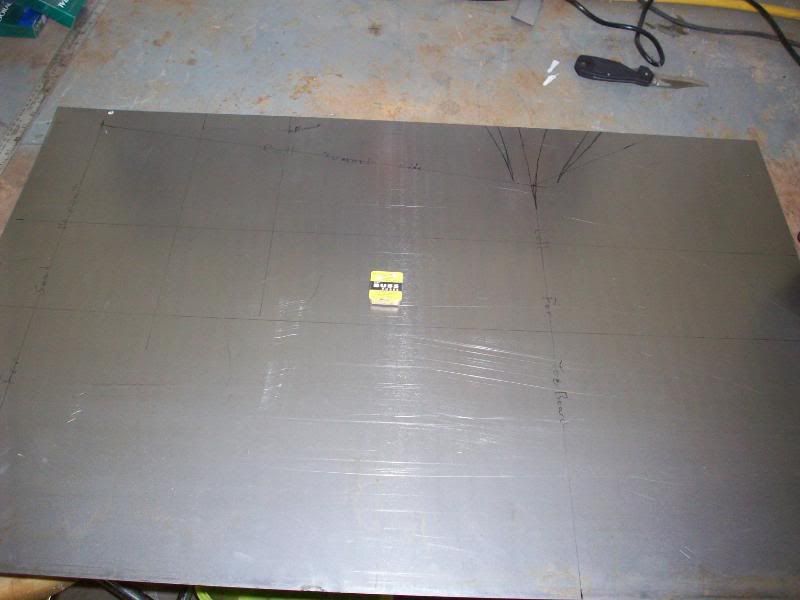

I used 20 guage for the patches, I like it for floors it welds sorta ok and is plenty easy to work. With a decent welding job its very strong.
After transfering the pattern to the sheet you should end up with something like this. Marking the location of braces and framerails is so that you know where to NOT bead the floor. The areas that are welded to braces etc dont need any stiffening, and beading these areas may make it a pain in the ass to get patch to lay flat.

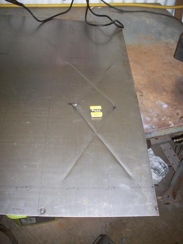

You should also avoid putting beads in the places where the floor is to be bent, these places are plenty strong and putting a bead acroos them will only make it harder to control the bend and the beads will end up flattened anywho.
This is the point where I pull out my bead roller and have some fun, but since I cant use it,, part of the challenge ya know....

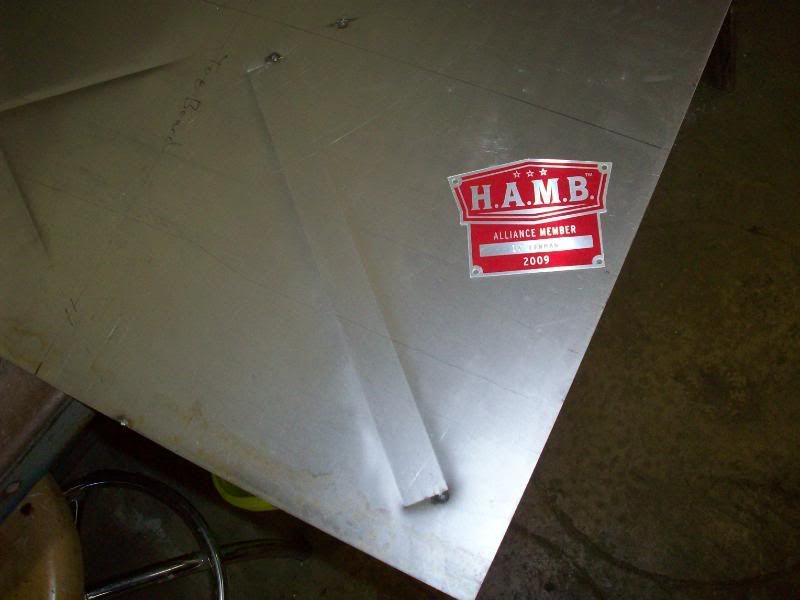

I used a piece of 3/16" solid round stock bent in the middle to make the beads. Making sure to avoid the frame and brace areas tack the rod to the patch.
Find a nice flat spot on the concrete and turn the patch so that the rod is on the bottom. Mark your start and stop points for the beads on the side you can see.
Grab your favorite deadblow and have at it!!
Cut the rod loose and flip it over and retack.
set it back on floor and whack away again,, should end up with something like this:

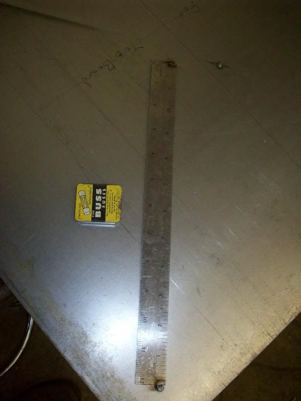

As an alternative to the round stock I tried this out too,,
I did not prestretch nor did I spend a lot of time making nice whacks at it, so there are some hammer marks and some warping. I wasnt all that worried about appearence as its gonna get undercoated and painted on the bottom and carpeted on the top....

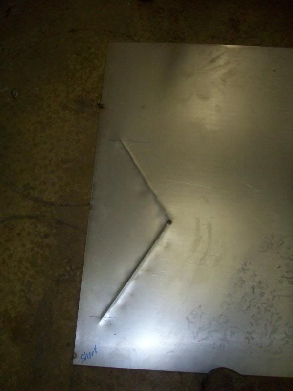

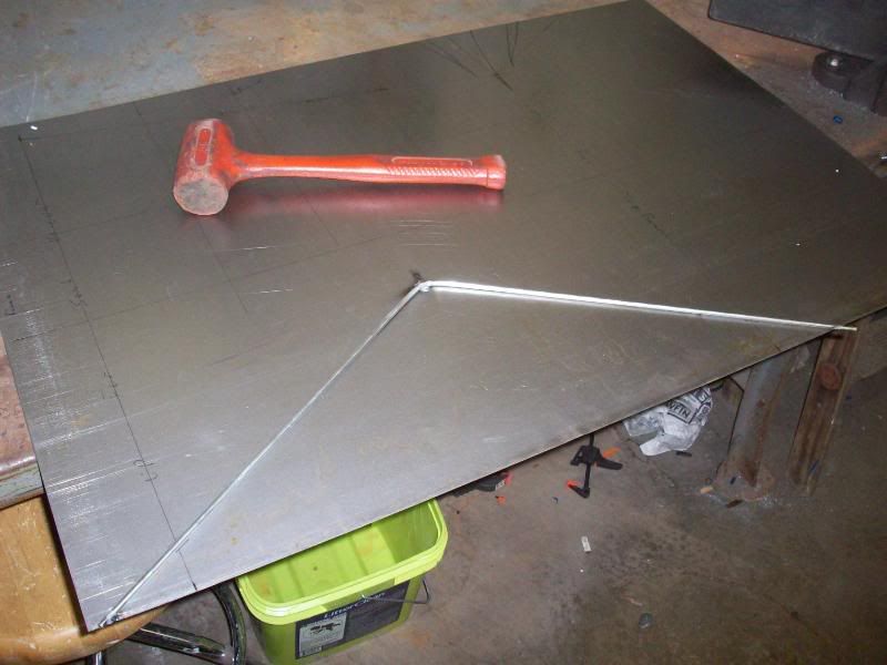

You are now ready for the some bending, but how to know how much bend??? Easy, make another pattern. Take a piece of scrap and trim it so that one end matches the angle of the toeboard and framerails,
cut the other end to match the rise onto the tunnel,,
if you havent cut the pie for the corner get it done as we are ready to use the fancy new flintstone brake,,,
When you bend the patch you can use the angle pattern to make sure you got the right bend.
I welded the pie closed before welding the patch in so it would be easier to control the angle as the weld shrinks.
