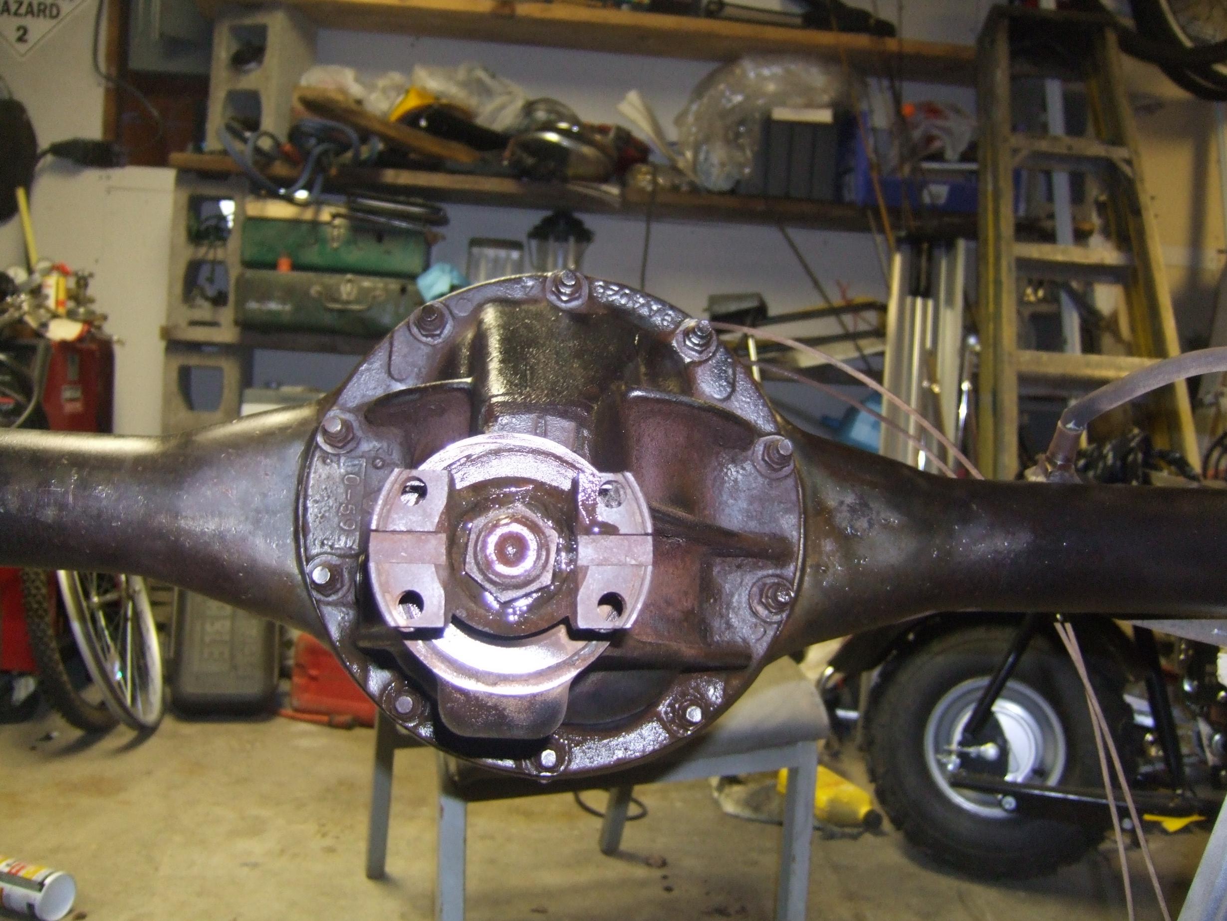

    from Spokane

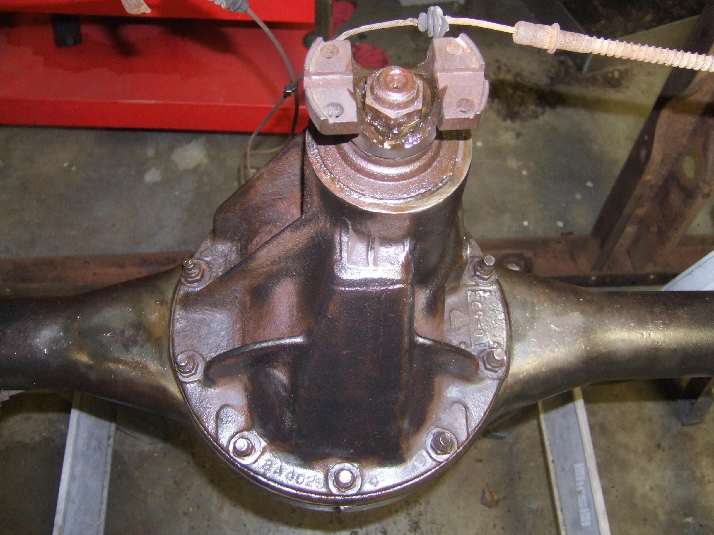

    When I bought this the guy said it was outta a 58 or 59 ranchero, he also said it was an 8", but with all the searching I have done on the internet it seems to be a 9".
    There is no tag on it but cast in the front of the 3rd member is the # 8A4025 then a 4 after the bolt. on the side of the yolk is an I in a diamond with 0-59 under it.
    Any help would be great.

    looks like 49-56 ford passenger car (not wagon)
    he pulled a fast one on you

    Now that we have established what it aint. can anyone tell me what it is?
    It's ok that it aint a 9", I wanted an 8" to begin with. but I want to know what I got:confused:

    It's been awhile since I looked at one but I didn't think the pinion on these was offset like this one is. Maybe the ones I had were oddballs.

    Its not an 8" either, the 8", like the 9" had 6 bolts around pinion...

    How many splines are on the shafts? 28 or 31 are Fords. (8" and/or 9") earlier may differ.

  11. Looks like the stocker that was in my 56 Fairlane - not an 8" or 9"

    Looks EXACTLY like the one in the wife's '56 Ford sedan.

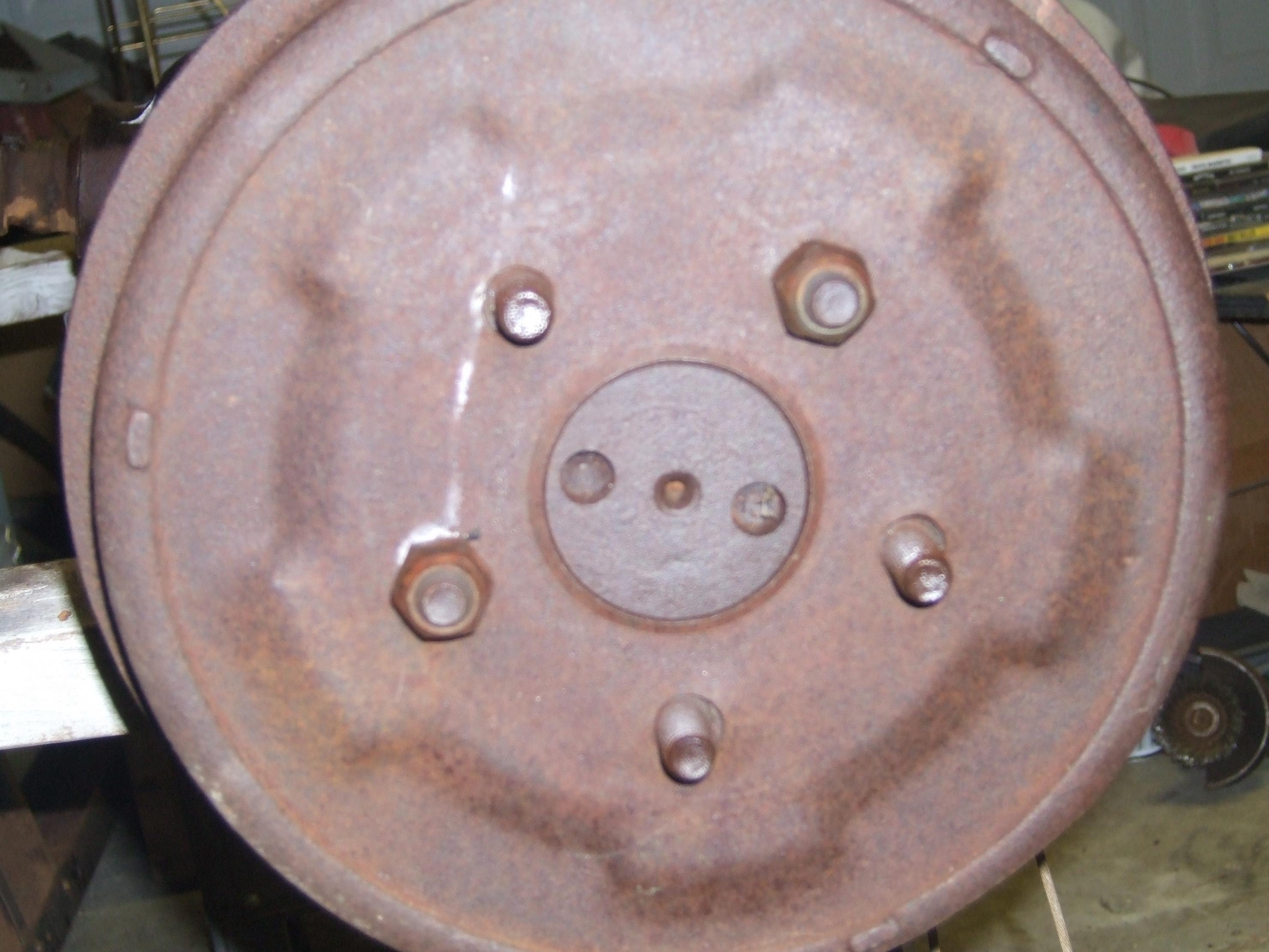

    What lug pat. ? does it have left and right hand lug studs on it?

    I'm pretty sure squirrel nailed it.

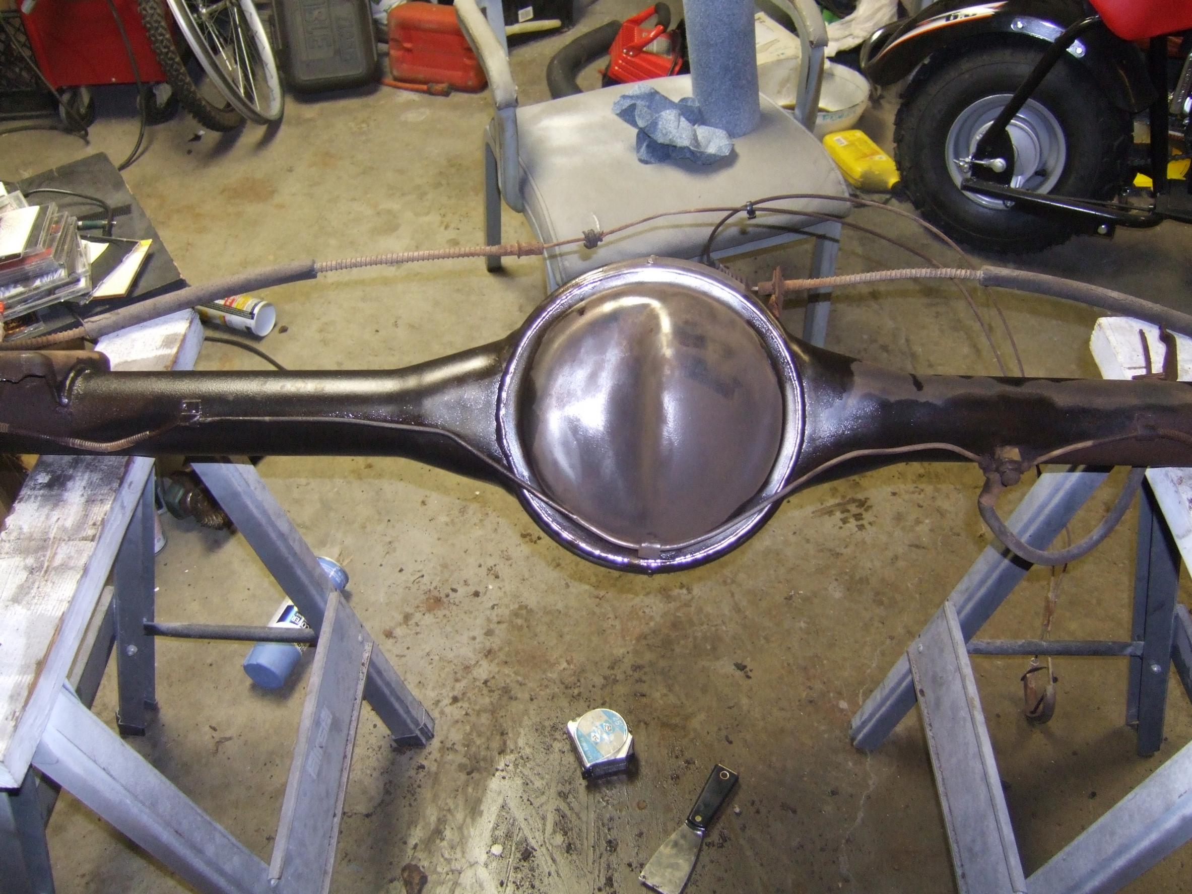

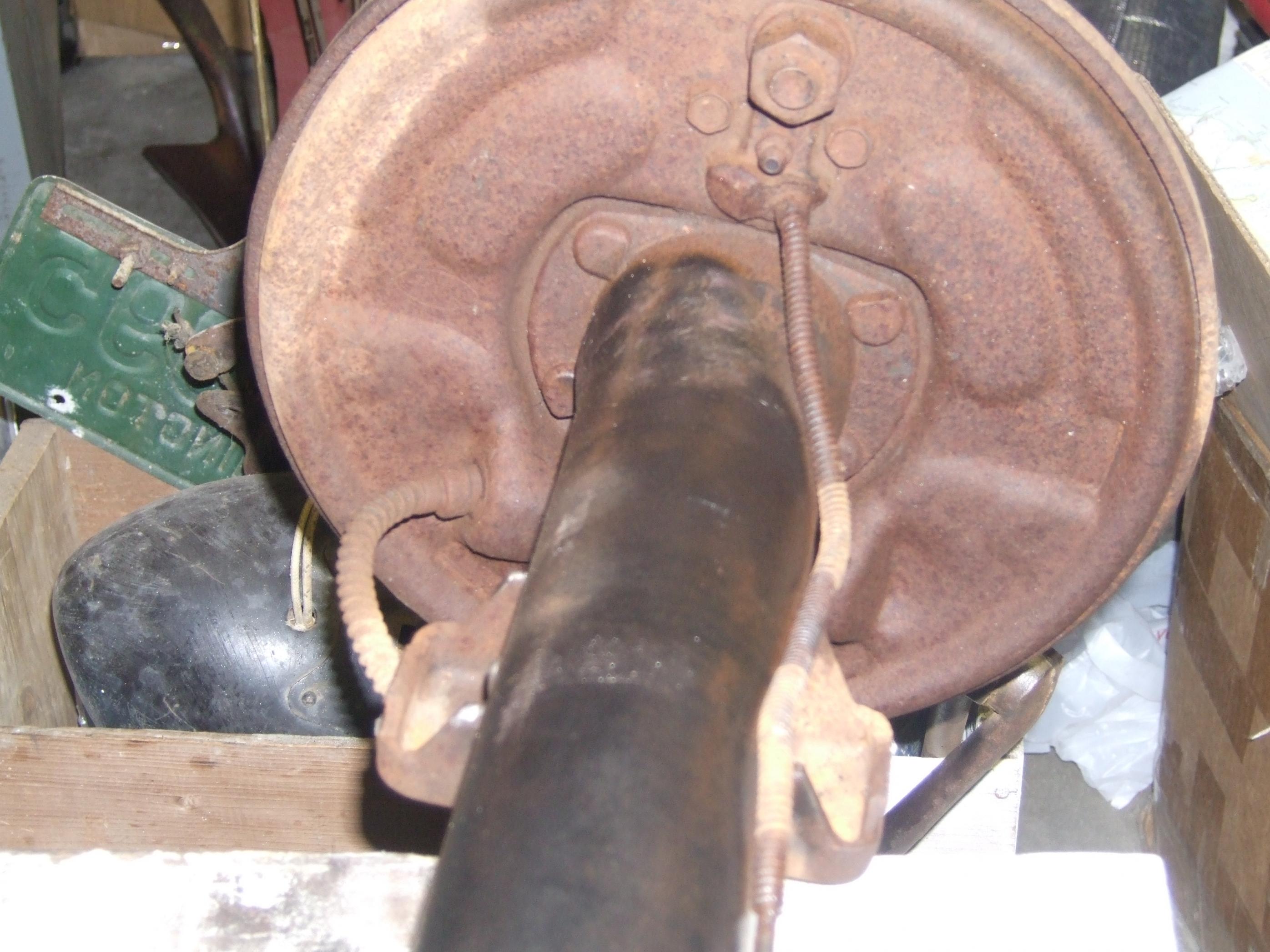

    Here are a few more pics. The bolt pattern is 5 X 4 1/2.

  20. that looks exactly like the rear i pulled out of a `50 Ford

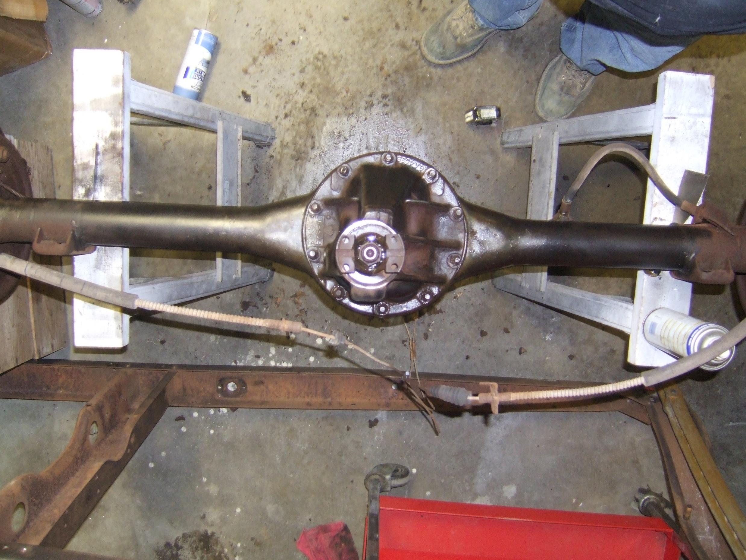

    Well, I found it in an old "Motors" manual .....Drum roll!!!...... it is a 1949 to 1951 ford rear end. It didn't give a size, so still not sure on that.
