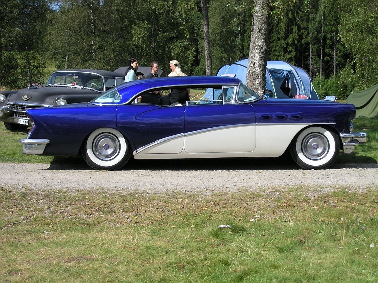

    Some photos I found on the internet some time ago... Heavy chop
  5. Ooof! Heavy chop indeed.

    A picture is worth a thousand words. I think your much better off leaving the roof alone and finding other little ways to make it you own. The car James D posted looks way better than the one Rickster found. I think that is the only picture Rick has ever posted that I haven't liked.

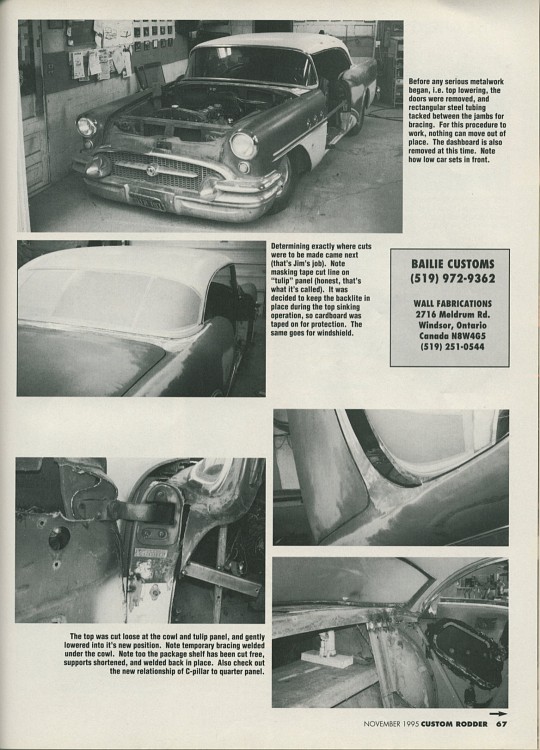

    Here is an article on chopping same year Oldsmobile... all scans by Paul Kelly.

    Larry Erickson designed this Buick for himself...
    Jim Bailie did the body work.
    Scans by Paul Kelly...
