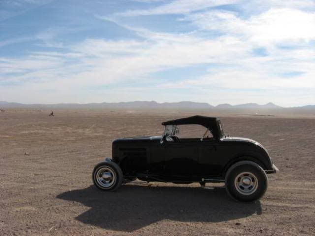

    I vote with staying at or slightly above the scrub line. That's not saying that the 48 didn't go many miles at below the scrub line. Bent running boards from hitting a pothole while going past Salt Lake City on the freeway. Getting hung up leaving a grocery store parking lot and screwing up fresh chrome on the front bumper, bending the cross member under the bell housing while hitting something. Oh yea it's fun being real low.
    The Model A pictured above couldn't make it from my garage to up on the highway in front of the house on a bet. While not being a real tank trap my 400 ft driveway has too many dips in it plus the lip that the guys who paved the road at the end of the driveway.
    I love low rigs and won't run bags on any of mine but I still have to be practical enough to have the car/truck sit at a ride height that won't get it hung up during normal driving and won't be a constant threat to get me a ticket. As a local State Patrol man told me. If that truck has a flat on the road I have to be able to push you off the road with the patrol car. Meaning I had better not have anything below the scrub line to get hung up on.
