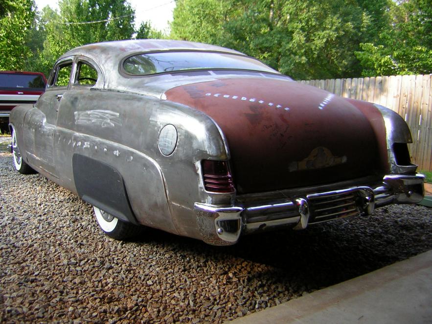

  1. Here is one way to install 54 Merc taillights into your project. I will be showing how I put them in my 51 Merc build. The same technique can be used in many other models. The biggest issue with this taillight is the fact that the lense is relatively narrow. I will show a little trick later in the tech to get you past that problem.
    I first purchased a few lenses from one of the parts suppliers, a couple extra just in case. A lense surround was fabricated out of 3/8 solid bar stock.

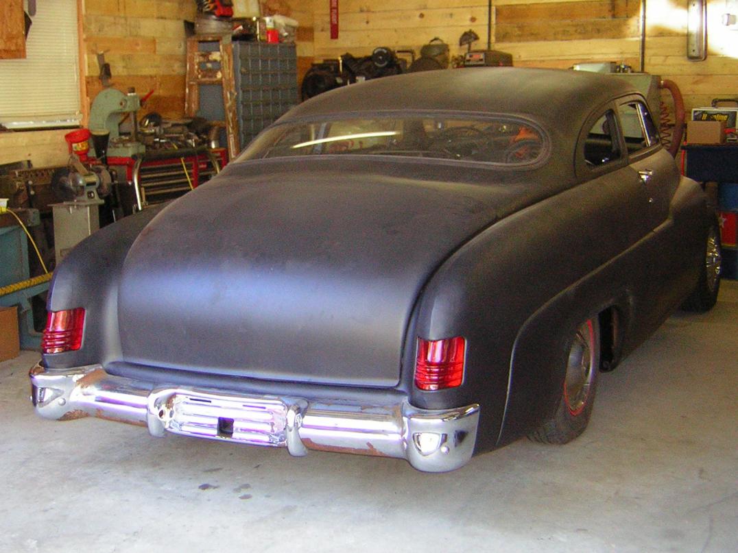

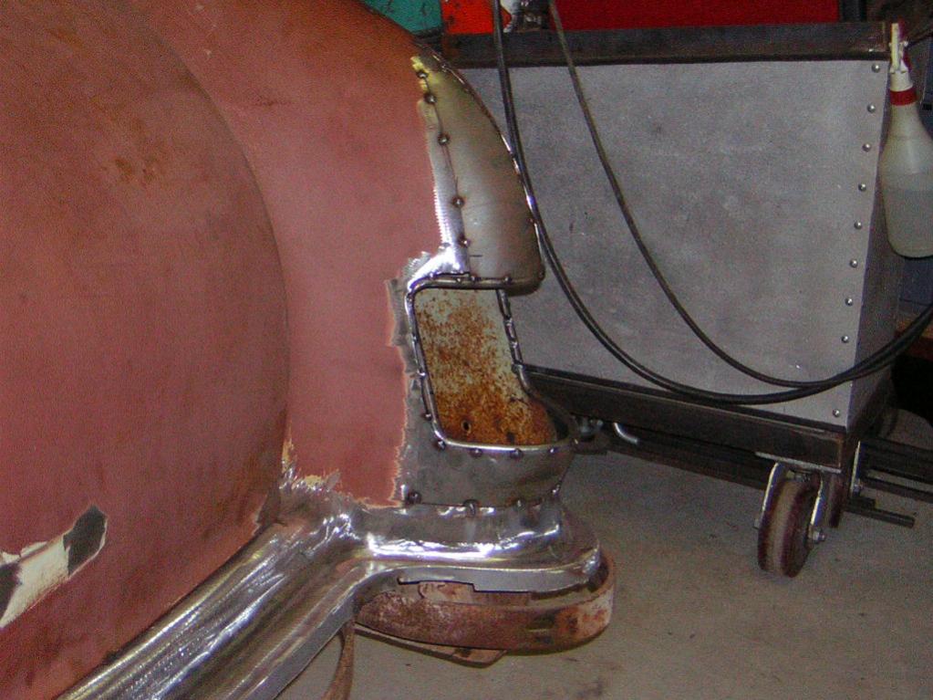

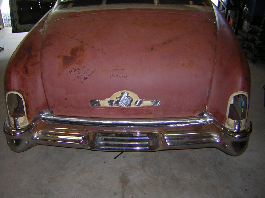

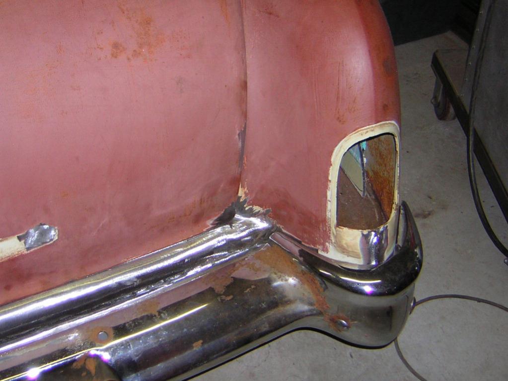

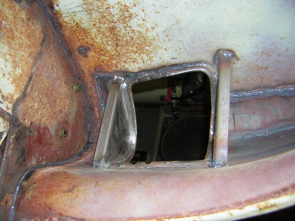

  2. Here is the back of the Merc before I started. I trimmed the taillight extension on the Merc to fit the 3/8 frame I previously made. The 3/8 lense frame had to be widened to fit the rear of the car. This is where it is important to take your time and measure. Also stand back and look at it to make sure it is flowing. Oxy welding rod was tacked to the top to help in visual and to assist when extending quarter panel.

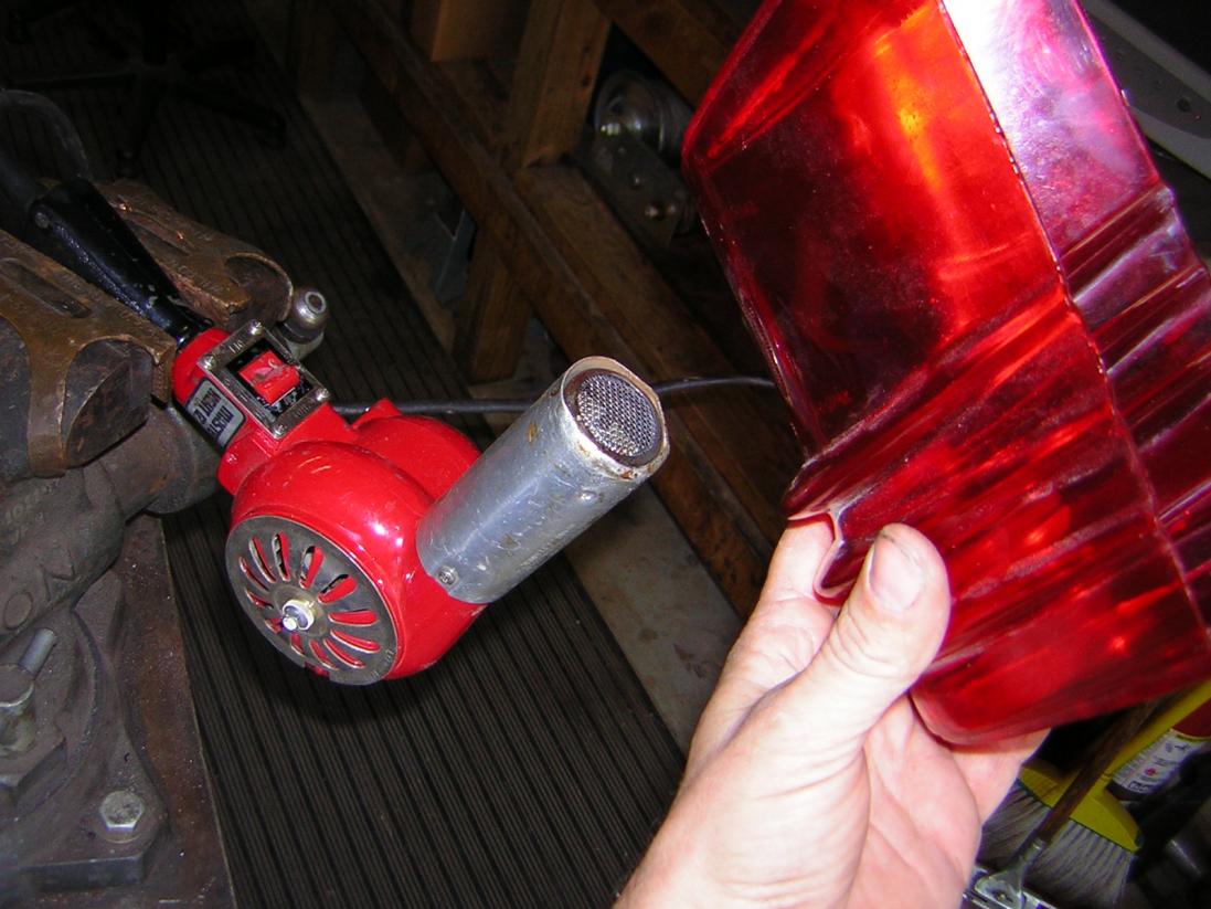

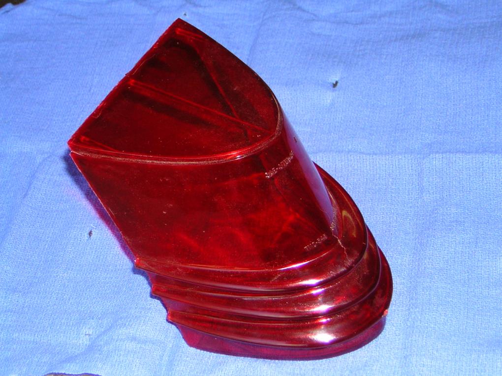

  3. Now that the frame is tacked into place, we have to deal with the fact that the frames were widened to fit the quarter. Here is where it gets a little tricky. We have to widen the lenses. This process can be used to narrow the lenses also but is probobly a rare situation.

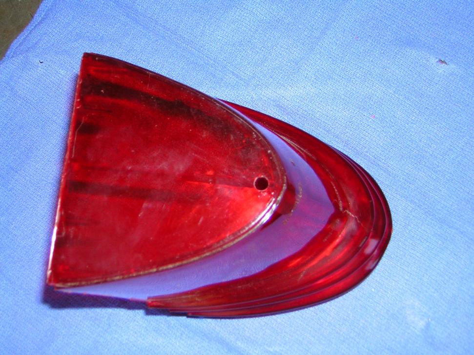

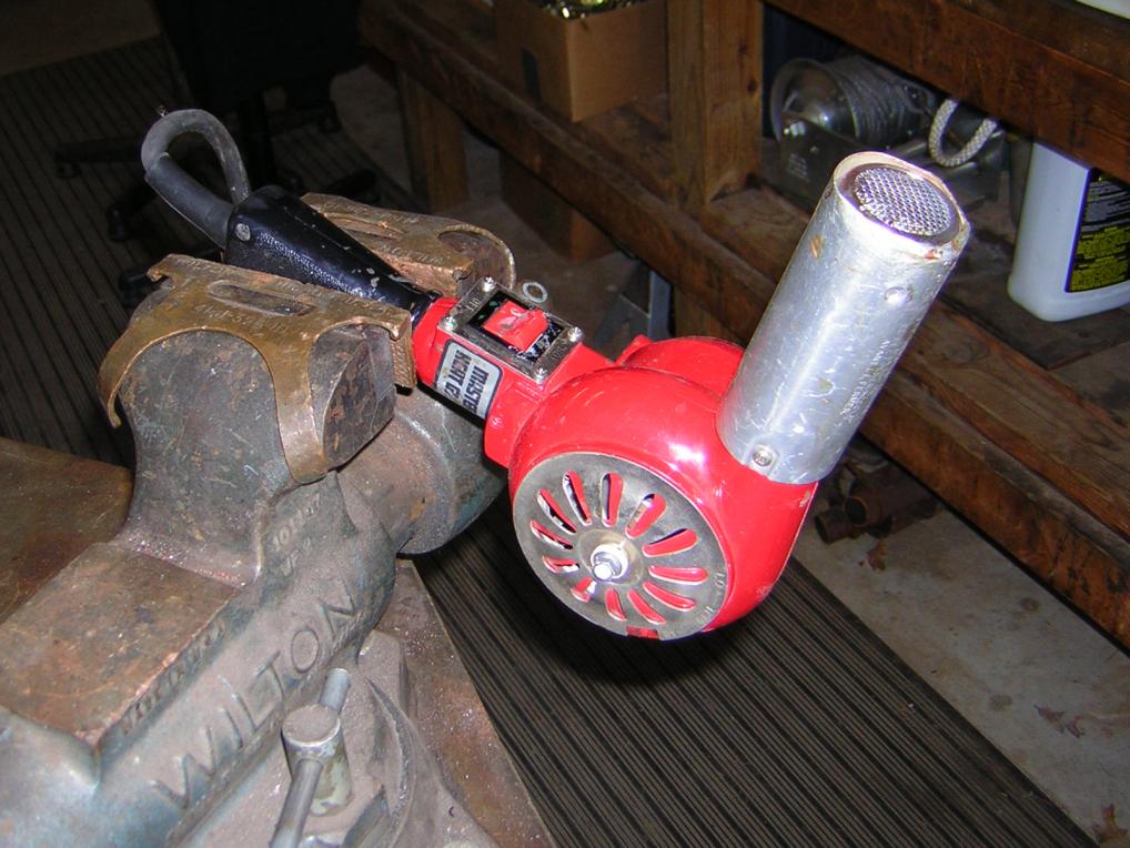

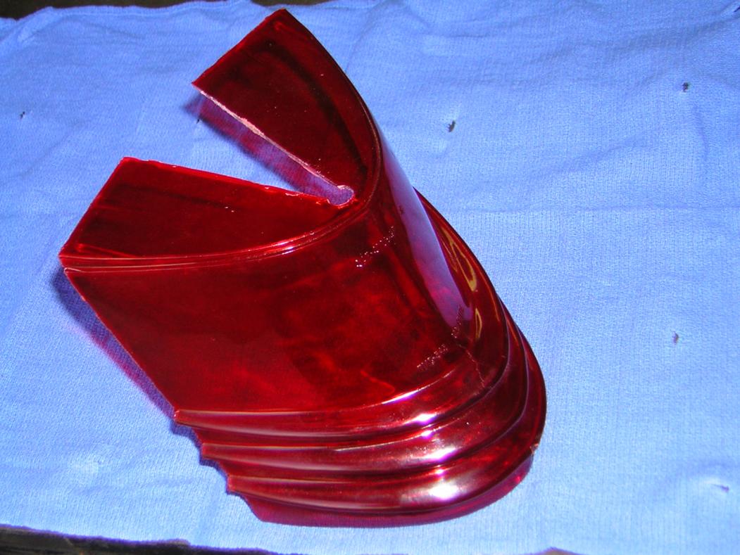

    First I drilled a 1/4 inch hole about 3/8 from the edge of the lense on top and bottom. Right down the middle, I used a cutoff wheel to split the lense from the edge to the hole. Using an industrial heat gun, I slowly heated the lense and applied pressure till it started to move. This takes a little time and is easy to heat it up too much (dont ask how I know) so take your time. Check for fitment in the lense frame. I also used a rotary file on the frame to make the reliefs for the 3 ribs on the lens. Some people have heated the ribs at the ends and flattened them with a pliers. This is your choice. After the lense is fit we will be time for final welding everything so its a good time to step back and check it out.

  4. Here is how the lenses look in the frames after widening. You can use some lense material to glue to the inside of the lense to keep it from cracking. A lense from a late model car in the junkyars works great, one that is flat. Im going to use some of the glue that Hagans sells for glueing in some of their flush tailight lenses.

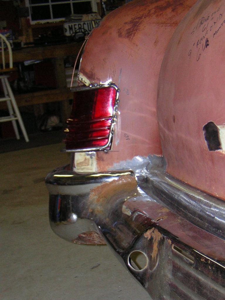

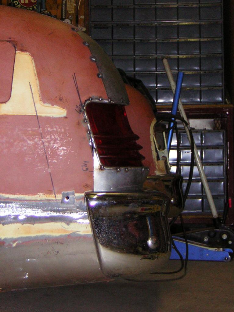

  5. I made patterns out of stiff paper (sorry no picks of the patterns) that transitioned from the wire to the side of the quarter, traced them onto some 18 guage flat sheet steel and trimmed. The steel filler pieces needed a little massaging to get the compound curve to fit the area. With the top tacked, I did the same on the bottom. Step back and make sure all is flowing and final weld the lens frame and fillers.
    Final weld and grind. I also used some 3/4 round bar stock and hit it on the side with a hammer against the bottom fillers to get the bumper relief.

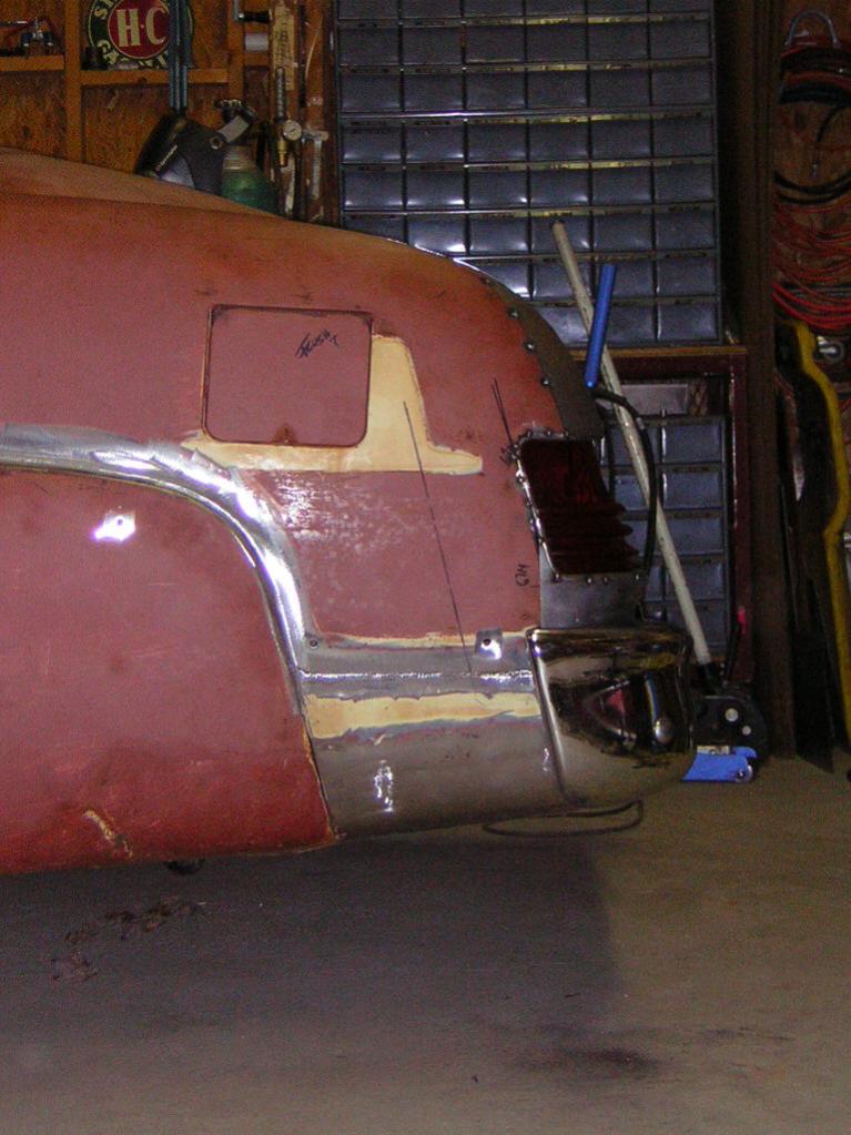

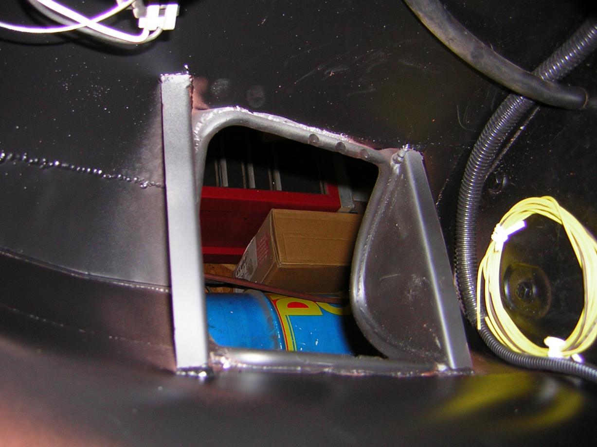

  8. The lens needs something to sit on and seal it on the top and bottom. Templates were made to fit the contour of the quarter. They were transfered to 18 guage steel and an extra 1/2 inch left on the edge for material to bend over for an attachment flange. They were then welded into the quarters.

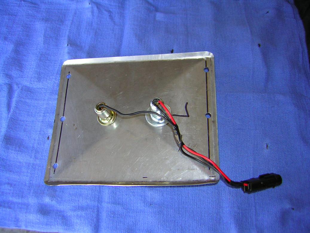

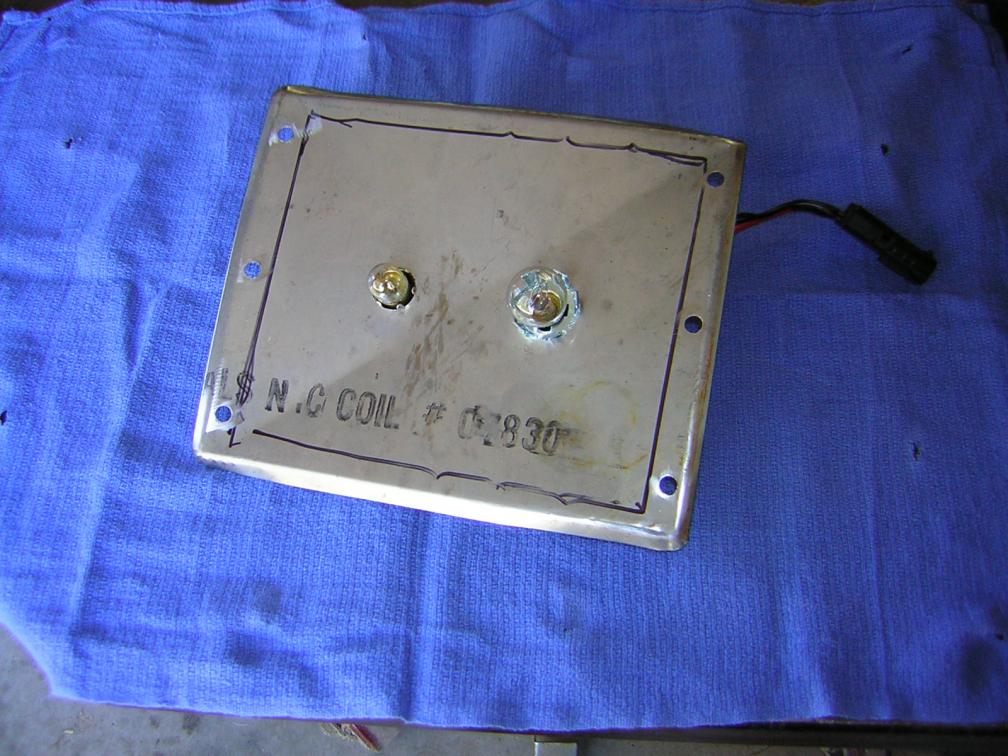

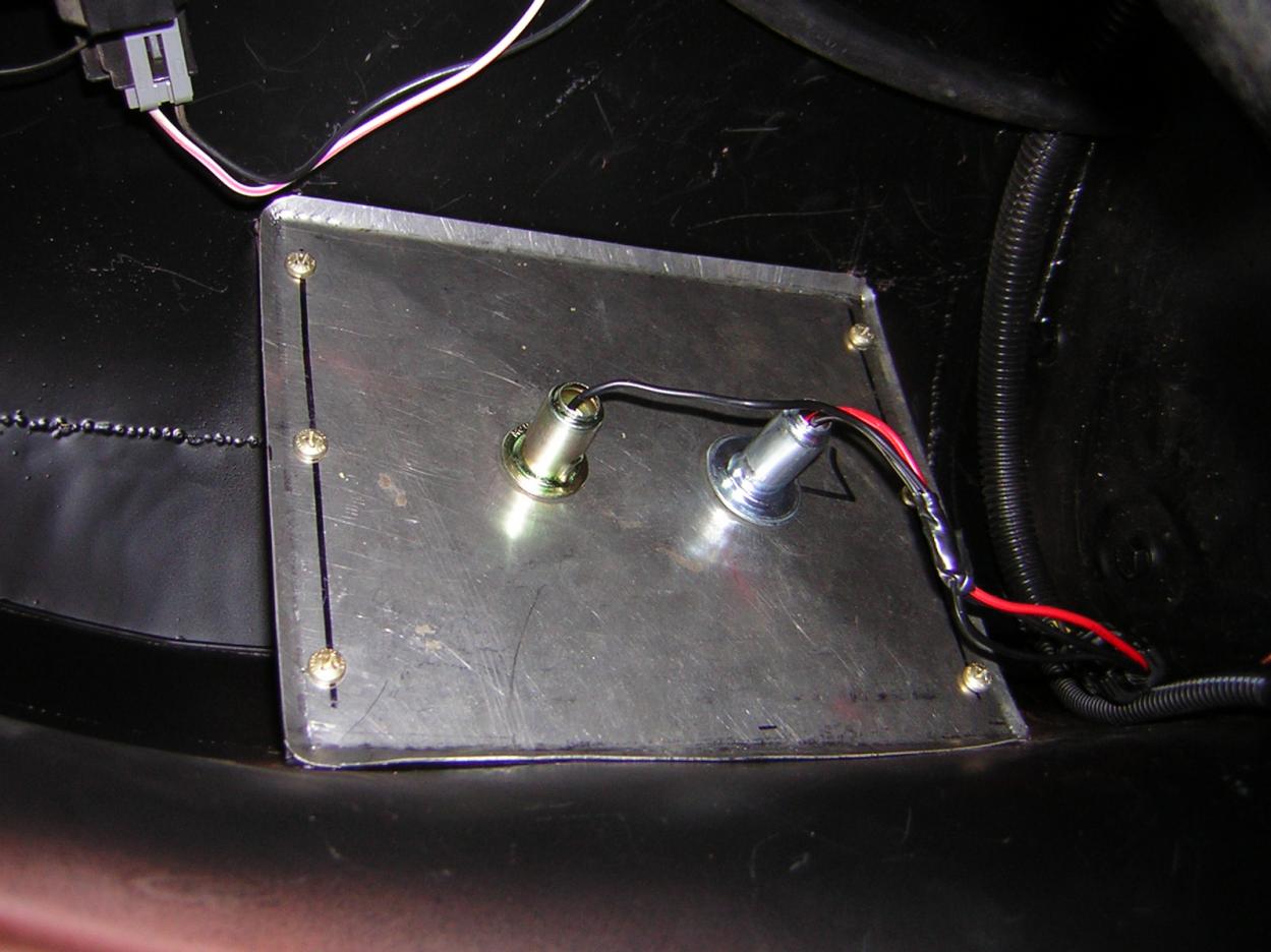

  12. Now for the back plate and light sockets. I cut a piece of .050 301 stainless steel the size of the area to be filled. The plate was bent in a crisscross pattern for strength and to aid diffusing the light. I then bent the edges a little to aid in stiffness. Three holes drilled in the top and bottom are used to locate the areas of attachment to the back of the lens shelf. After locating the holes I drilled the shelfs and installed rivnuts.
    You can purchase the light sockets at a local autoparts store. I used a marker light socket on top and a marker/stop on the bottom by drilling the holes in the backing plate with a step drill.

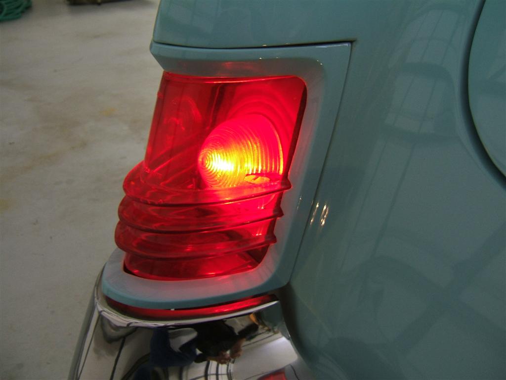

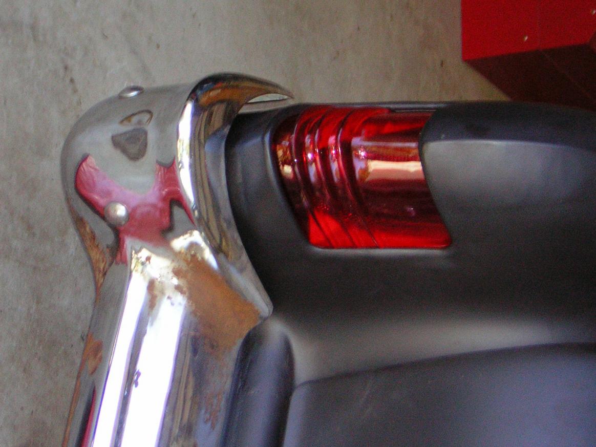

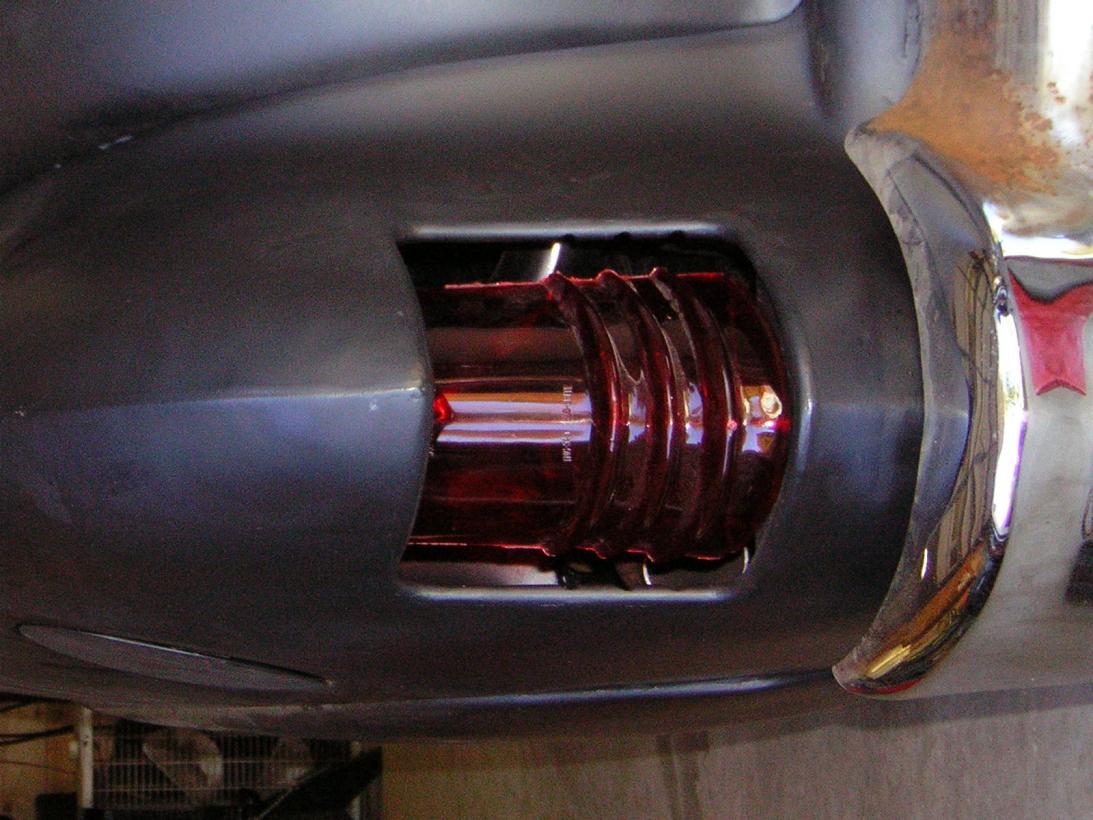

  13. Here is the finished product after a little wiring. I will be using that black windshield caulk to seal the lenses in place when we paint the Merc. I plan on painting the merc black so it wont be so obvious. Im trying to find the red diffuser material to make a set of inner lenses so you dont see the light sockets threw the 54 merc taillights. Anyone??

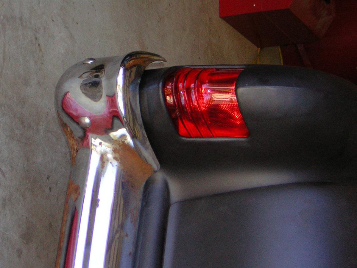

  16. Tinman, Are you talking about red or clear? I am looking for some red diffuser material. Clear is worth a shot but I like the blood red look of the taillight with the red one. Right now I have a set from a 55 Chevy behind the Merc lenses, It looks great but doesnt fill the width of the lense back plate. You can barely make it out in this pic. ETHER
