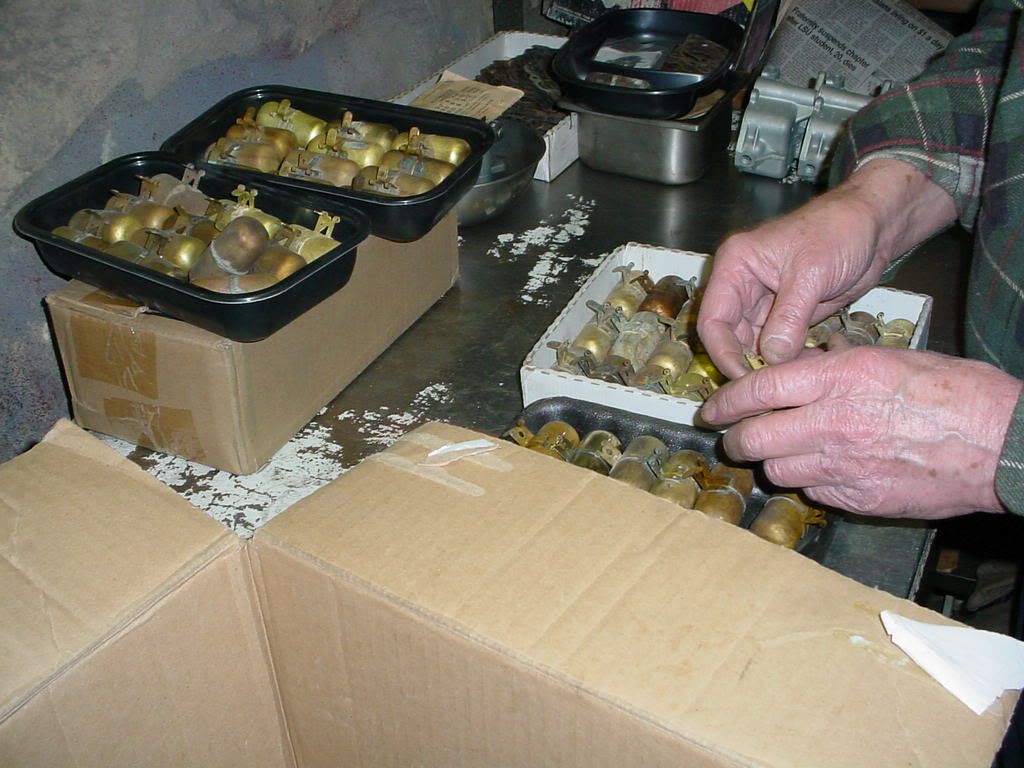

    George Asche is the B&B man. I took these pictures on my last visit to his shop.
  19. panic
    Joined: Jan 3, 2004
    Posts: 1,450
    panic
    Those appear to be Carter BBR-2 "Special Heavy Duty" Series used 1939–60, with a letter/number combination stamped on side of airhorn vane.
    If yes, the throttle is 1-11/16" (1.688"), the venturi is 1-11/32" (1.344"), flow is about 150 CFM each.
    This is going to restrict peak power, not sure how much. Unfortunately, these early carbs were made to SAE standard sizes, and the next size larger carb very likely has a different bolt pattern.
    What's the bolt pattern between centers?
