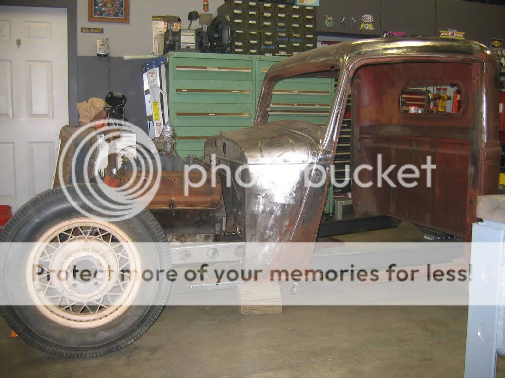

    First things first I'm only 19 years old so dont be too hard on me... Everything is still kinda mocked-up, especially the front end. There's still a lot of work to but we're gettin there.
    PS, I NEED A DRIVERS SIDE DOOR!!

    The last picture is an old one, before the frame. I was going to run a 40 front axle suicide but i decided against it. I decided to go with a new dropped axle, quarter elliptical front end.. I am still using the 35 wires all the way around.

    Looks good to me no matter what your age. Are your frame rails tapered or the holes being differant sizes make it look tapered. Good job. Wish to hell I was 19. TP

    Great work so far, Love the fab work on the brackets and lightening holes, Great to see the Hemi in a Dodge instead of going the simple route with a SBC

    TP: The front rails are tapered. We pie cut the rails then welded em back up.. I'll try to find soe pictures. Ive got some somewhere...

    Is it ok to use leaf springs in that manner, welded to the frame? I've never seen that done before.

    The springs are bolted to a plate and the plate is welded to the frame. The sole purpose of that plate is for mock-up purpose only. I plan on cutting a square opening in the bottom of the frame and weld a 1/2''x4" block into the bottom of the frame and drill and tap two holes in it. Then im using two 5/8 bolts to go up through the springs into the frame. In another week or so i'll have the springs done.. I'll post some updated pics then...

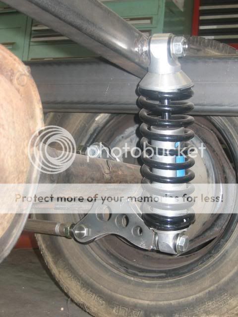

    Nice to see you didn't run the front axle sticking out two feet in front of the engine as so many seem to be doing. Although you did some real pretty work on the rear axle, sure would have been nice if you did quarter elliptics back there insteaed of coil overs. Don't get me wrong, nice work, just a little too modern for my taste. If the bed covers it up, it's a moot point anyway. Still a nice project, especially for a guy your age.

    What locates the front axle besides the springs ?

    Unkl Ian: Im using shocks too. In one picture you can see one on the drivers side. They mount to the headlight brackets...
    Blackmopar: Nothing is prefabbed. The spreader bar is made out of 1 1/2 solid stock. I cut two pieces of 1 1/2 stock to length and milled the ends to the angle i had determined. We then welded to bars into the v shape and i ground the welds smooth. To drill the holes i first used an end mill (size of my desired hole) to spot-face the bar (because it was in the vise on an angle you cant use a drill). Then i drilled a pilot hole followed by a 1/2 (same size as end mill). As for the rails ill find those pics somewhere....
    I cant take all of the fabricating credit. My dad is a machinist and my older brother has lots of fabbing experience as well. So i've always had someone to at least show me how to do something, although i usually try my way first, just to realize i should have listened to dad in the first place..

    Richard D: I agree with what you say about the rear suspension, It would have been neat to go quarter elliptical all the way around but part of being 19 is surviving off a paycheck of a 19 year old.. haha im sure you know what i mean.. And someone offered me free coilovers so I compromised. Plus like you mentioned, they will be hidden!
