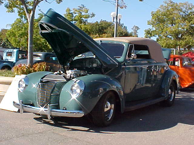

    Love your 40's. Do you have a photo of a forty done in tropical green 39 Ford color ?
    thanks
    Larry
    Phx AZ
