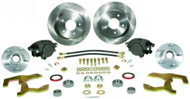

    Just wanted to throw out there that there is a real nice kit that you can get from Jamco Suspension. Jamco sells for $699.

    I've also come across one offered by ABS Power Brake, #B23 for early fifties cads with 12" rotors : they say it should fit stock 15" rims, but I'd rather see a picture or get independent confirmation before ordering a kit of any kind...
    At Scarebird they did not want to commit on stock rim fit, and at AAJ Brakes I did not get a reply on early cad kit availability (they offer a kit with 11" rotors but for later cars)...
