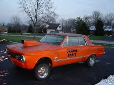

    other Valiants
  5. Hope these help.

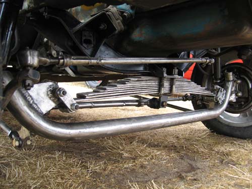

    Here are some pic's of Mr Rich's "RAMBLER"
    I know it aint no A-Body but the way the front suspension was created was Cool.
    Hair pins and all!
    Sorry only the one pic available of the suspension.

    Guess we just get a straight axle, some leafs ..and make mounts ?
    Those pics help some ..That rambler is different ?
