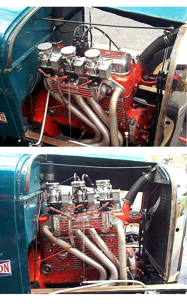

    1 Would it be too far behind the times --or outside of the original spirit? :rolleyes:
    2 Can an era-equipped OHV Model A/B be allowed to compete against the flattie V-8's and the In-liners ?
    3 Could a 'built' 80-100 horse flathead Banger keep up with the class?
    Thoughts....

    BRENT in 10-uh-C
    Generally speaking, a short block will go in at under 200 lbs, and a fully built (minus F/W) will be about 250 lbs. If I were throwing out a guess, I would think that an iron OHV on a block complete with dual carbs & manifold, plus ignitions, flywheel, clutch & housing, and etc. will likely be in the 400 lb. range. My gut feeling is that I could be about 100-150 lbs lighter than others running the buzzin' half-dozens and the 8 cylinders. Am I close?

    That all sounds reasonable...and I don't feel that HP numbers adequately cover drag times with bangers and flatheads. They can't produce big HP numbers because they are below the mathematical point in the formula that derives HP where numbers start climbing...but the lower end of the torque curve is much fatter relatively than modern engines. ET's hence better than expected, MPH lower than ET would suggest...

    Are we really talking Apples-to-Apples here??:eek: In a short slingshot weighing-in at about 850 lbs, then I can see those numbers. I was thinking that Wes & Kong ran those kind of numbers with a turbo-ed 4port Riley on a .155" over B engine.. (I own that block BTW:p ) In a HA/GR, I don't see it. I think a flathead banger busting into the 12's would be something to cause a few cheers from the bystanders. I would also think that an Overhead on a Banger block would likely be in the mid-twelves (+/-).
    OOooohh, and I'll tell you right now that I ain't sure I have the "kahoonas" to be driving a HAMBster HA/GR into the mid-tens based off of the rides/specs I see everyone else building to!!:confused: I was thinking someone had said that 11:99 was the limit --and 11:98 and you were put on the trailer.
    Just out of curiosity, I see where the "Gas Rail Gurus" will be in having a showdown at high-noon this Saturday at the GoodGuys Meet in TX. Is this something that is (or will) growing into something where we will have a HA/GR class to run on a regular basis at the GG Drag Events?

    BRENT in 10-uh-C
    Only that it was set up with inserts on the bottom end, a stock deburred B crank w/o counterweights that was drilled for pressure, a set of rods that were polished and had been boxed, and valve seat area that had a couple of cracks. I did not get the head or anything other than the short block.
