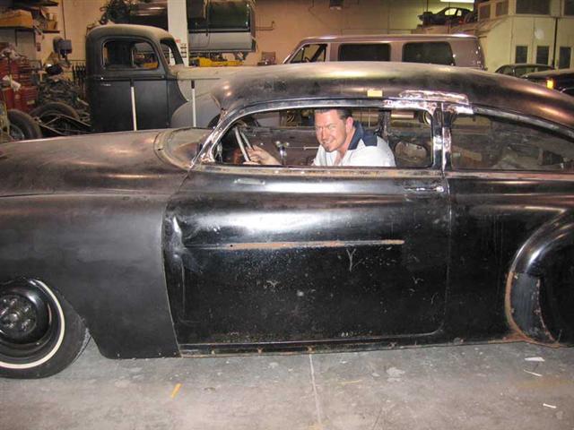

    Do a search here on the hamb chop, last fall we chopped stickylifters fleetline, I think it's even a 49. Basically he cut from the a pillar all the way to the bottom of the decklid and slid the WHOLE thing down. That way you avoid messing with the rear window. Plus you get really cool lines from the rear quarters. It's a bunch of work.

    Me and MarkX did a chop on a 52 fleetline a while back and then the hamb chop did it again. I think markx had a few pics up of how we did it but the thread is from about nov. 04 or so.
    We cut below the decklid and moved everythiing forward and then tacked the pillars together where they needed to go. Then we got the back half all braced and just started to fill in the gaps. It took alot of time and creativity but the lines are unreal.

    Also check out Tex Smith's "How to Chop Tops". It has a section on fastbacks. Everything I've read says that this body style is the hardest to chop, in terms of getting it to go back together. The best advice I've heard is to keep the rear window intact, as a unit, and to get your windshield done first, and make the metal fit the glass.

    Check out the threads on sticky lifters 50 fleetline chop.
    You can get more of an idea of where the car was chopped.

    i would definitly do the chop like "50 Chevy" shows it looks bad ass! those curves on a fleetline are perfect how they are stock just needs to be closer to the ground. thats how im going to do my fleetline
