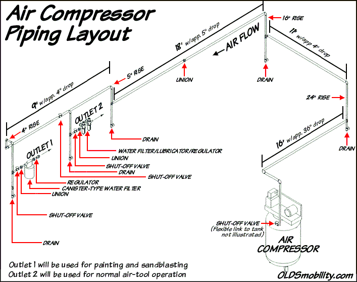

    Anyhow, now I need to set it up. Any advice, piping layout, what filters should I get, hose size? I am looking to use it mainly for painting (using HVLP-on my way to harbor freight) and some sanders. That ol' Ford needs some new skin...Thanks

    I got some advice here about a year and a half ago.
    Worked KILLER!
    Don't use the PVC...can explode when under pressure and gets impacted by something. Also it doesn't efficiently condense the water vapor from the warm air the compressor pumps out.
    My setup...with a similar compressor to yours and humid conditions, has yet to give out ONE DROP of condensation!
    I ran 1/2 inch copper hard line vertical to the ceiling and 1/2 ways across the garage, then down into another 60 gal receiver tank hidden under my workbench. The outlet from the second receiver tank is equipped with a water separator and from that the line goes vertical and continues onward to the wall opposite the compressor. It drops straight down to a bleed valve at floor level to drain any residual condensation. This vertical drop has a "T" fitting 4 feet from the floor that redirects the HP air along the wall to two more outlets...the last one in the line having an additional drop bleed valve.
    The quick disconnects themselves are mounted to short vertical branch lines with a 90* fitting at the top. Thats so any liquid water condensed in the line will flow freely along the pipe but clean air will be able to reach the quick connects.
    The extra tank makes an incredible difference in moisture content. The tank is cool and the moist air can "hang around" long enough for all the water to condense befor it even gets to the lines.
    Trade off: The compressor must run longer for both tanks to fill...but, it takes longer for the air pressure to drop to the point that the compressor cuts in so its liveable.
    With this setup, I have yet to see a single water droplet from air tools or spray gun and I don't have a refrigerated water separator or anything!
    I'll see can I draw a pic...

  5. Hackerbilt
    Joined: Aug 13, 2001
    Posts: 6,254
    Hackerbilt
    Heres a pic....I HOPE!

    One tip is to take the drops off horizontal runs off the top of the line. Use 2 90's out of a tee and then use 2 45's to get the drop back to the wall. This way liquid water does on run down the drop.
    Also run the line down past where you want to take air off with a tee, and the put in a ball valve. Run another short 12" or so and put in another ball valve. Keep the top valve open until you want to drain the drop. Shut off the top valve and drain the bottom one. That way you dont blow the water all over with full line pressure.

    1. Use galvanized steel pipe. Mount main line as high as necessary to allow vertical work drops.
    2. Mount main line regulator/filter at least 20' from compressor allowing air to cool.
    3. Main line should slope down 1/8" per foot.
    Also dont run painting equipment from the same drop line as air tools. Install oil and water filters as well as drains as needed.
    Nice thing about threaded pipe is that it is easy to change as you needed. I included several extra T's in the main line and plugged off the drops, quick and easy expansion capability.
    DONT use PVC. If you want to use copper be sure it is type L along with the heavier cast fittings/couplings. Costs more than galvy tho.

    1. Kustom Painters
    Tricks to help keep out moisture. Run all your lines downhill, as suggested, and put a valve at the end of the run to drain off water. At each "T" where you come off with an air fitting, face the take-off UP. then put a street ell off it to go OUT, with your quick connect. Keeps stray water from going into your hose. Water don't like to go up. I also use a secondary filter, far from the main one, where I do my spraying. Doesn't hurt, to be safe. It does collect some water, too.

    FYI look what I found....
  22. 53choptop
    Joined: Mar 5, 2001
    Posts: 1,203
    53choptop
    Some more samples...
  23. 53choptop
    Joined: Mar 5, 2001
    Posts: 1,203
    53choptop
    Last one....
    Now I can picture what you guys are saying.....thanks

    That's exacttly the way my compressor is set up, did it about 8 years ago, it was a commercial shop up till three years ago, never had any water problems. I suppose eventually the steel pipe could rust, but I've never heard of anyone having problems with it.

    Excellent drawings.
    [ QUOTE ]
    Doesn't galvanize pipe corrode?
    [/ QUOTE ]
    Nope, galvanized pipe and fittings don't corrode. However when galvanized pipe is cut it opens a spot for some corrosion.
    Blowing out the system every once and a while (I blow my system out every week) will keep the system fairly free of moisture.

    Set up the piping this weekend, went with black ¾ inch pipe, it was cheaper than galvanized at Home Depot. Ran 3 drops with all long pipe in a slight downward angle, the pic is pretty bad, but that is the overall routing. That 1st drop really catches the water. The second has almost no water, 3rd has no water at all and the filter finishes it off. The filter is a harbor freight one, I was able to get it at half off, it is the big blue canister one.
    I bought PVC, but took it back, I just didn't feel comfortable with it. Everything turned out better than I expected, had no leaks the first time through, I used pipe thread caulk stick all the way. Anyhow, I just wanted to thank you for your help guys.
