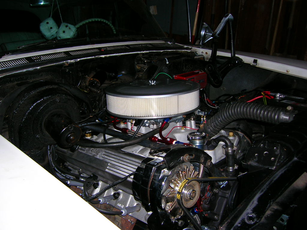

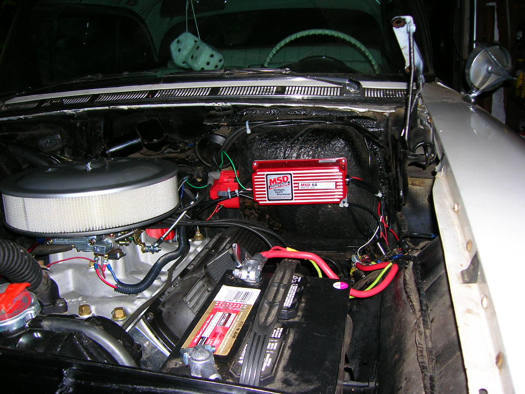

    They are a great engine, DO NOT run a HV oil pump in them they have a oil return problem can be worked around with restrictors, if you get serious about building one do some research, other than the oiling issues they can produce alot of power. I think they look a little industrial this is one I built for a car of mine and did some clean up to make it look better, this pic has some brackets I was building for a PC set up, Car is NOT FITTING for this site I know but the engines can be cleaned up.
