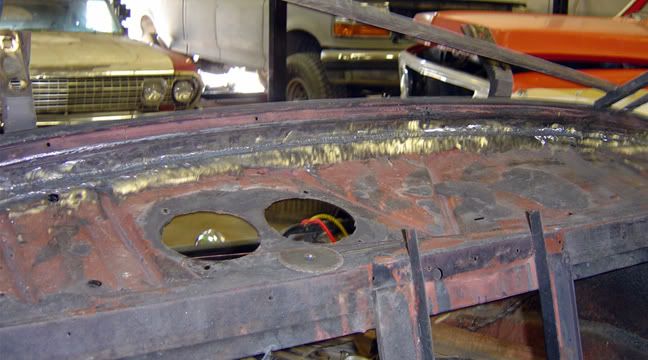

    Started on the inside/rear to get all the structure solid and welded the package tray back up. It took about a 2.5 inch strip across the inside there.
    After all the mess of structural metal and interior stuff was done around the rear window, I moved to the outside. This also required about a 2.5 inch strip to be welded in to fill the gap. Because of the new lean on the rear window, there was penty to work with on the top it was just no longer shaped correctly. I took the slices in order to bring the center of the roof up the meet the top of the window, but the rest was still a mess. Notice the rear side window behind the C-pillar. The chop pretty much eliminates it. I'll get to that later.
    Heres a shot of all that welded up with the TIG, so I could get it hammered out without to much warpage.

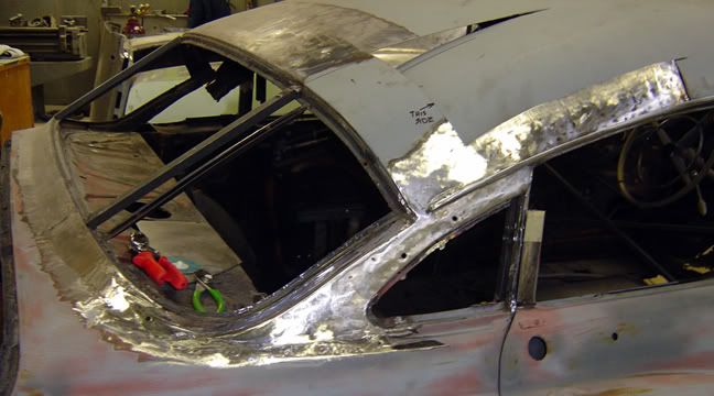

  7. I'm ready to wrap this one up.

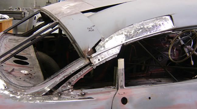

    So, at this point, I was ready to tackle the rear corners. I started by cutting out a good section of the roof and drip rail in order to reshape it and bring the line of the rail back up and flow into the rear window again. I had to cut enough to work with so I could achieve a nice flowing line through the entire length of the drip rail.
    I had to make multiple cuts on the bottom of the piece in the door jam area and shrink the top to get the curvature to change enough. Here it is all tacked back into place. Also at this point I began restructuring the small rear window. I didnt want it to go away.
    Here I have it all welded back into place and looking pretty decent. Also finished up the area there around the little rear window.
    After I got that all finished and straightened up a bit it was time to fix the roof. I did that by cutting a big hole in it, after rolling a new piece out on the wheel to go in its place.
    Here it is all welded into place, you can also see I started to get the rear door fit as well. I also tipped the c-pillar a bit. Did that a few steps ago, but you can see it well now that the door is in place and matched.
    And here it is, one side all but finished. I did the same stuff to the other side.
