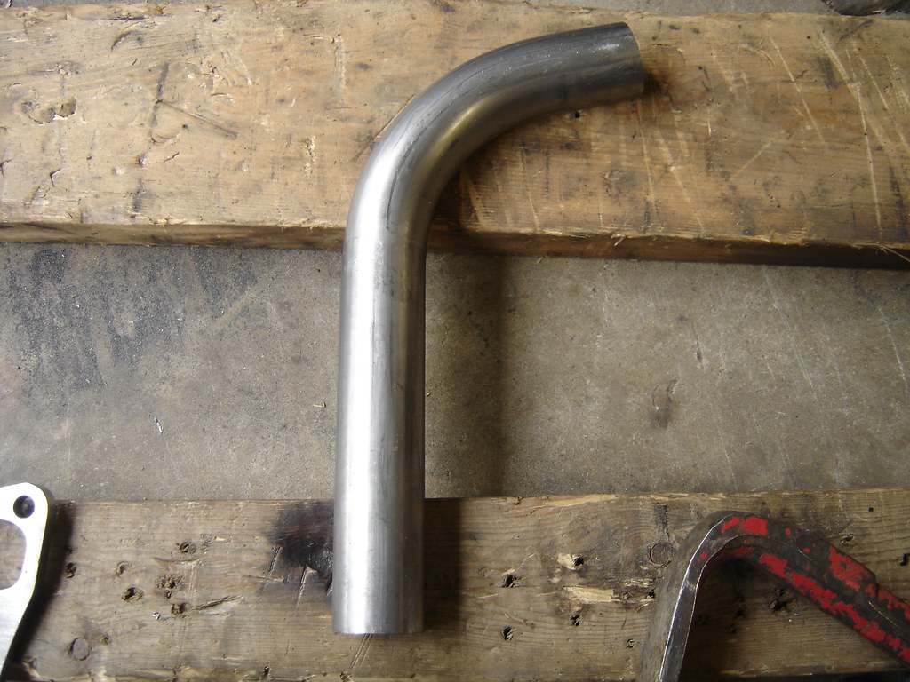

    Not sure if it's really a tech, but someone might appreciate it. It's my first time messing with headers, so I kept it pretty simple. I bought a Speedway lakes pipe kit for an SBC and was going to use my flanges for a Studebaker. I like the zoomie look a lot better than the lakes pipe, so I just used the 1.5" pipes from the kit.
    Sorry if the pics are too big, Flickr either has huge or smallish pics. I like huge pics better.
    Pipes from Speedway
    Cut 'em up
    Smack the hell out of the end with something blunt until the round peg fits the square hole.
    The middle pipe takes a bit more work. Square up the end the same, but do a little slice and dice.
    I needed a fancy little doo-woppy-type curve to clear the steering arm, so I had to cut the pipe and turn it up and sideways then down.
    Bit o' welding and patching
    Flap wheel, filing, DA, sandpaper, and a bunch of cursing

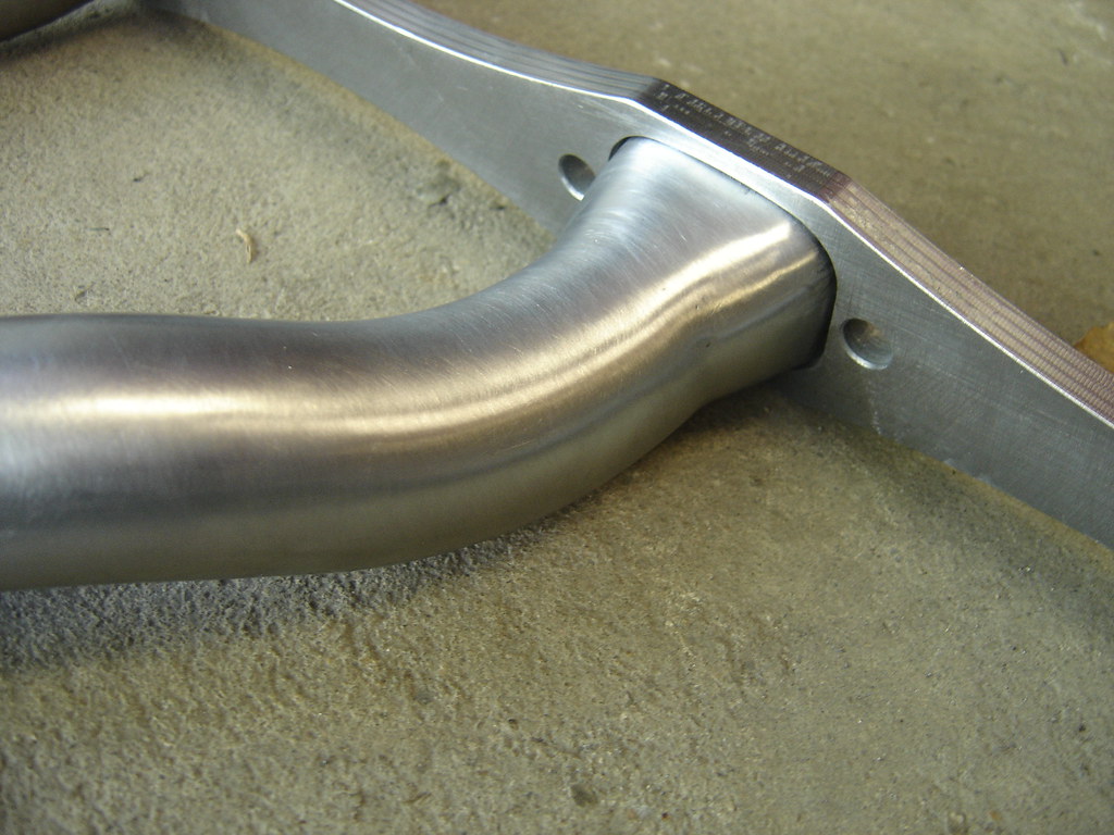

    Final product. I'm pretty pleased with it. I think I will paint them black, maybe get them coated.

    I have a few little pits here and there, would they be filled in if it was coated or chromed, or will I have to put little tacks on those spots and grind them back smooth?

    You sure are one major league shitter! Your headers look amazing. When I got done with my car one of my biggest regrets was not spending any extra time on the headers. Yours look so good I would spend the extra time to fix the pinholes and maybe get them chromed. Even if you dont chrome them I would still fix all the holes and get them jet hot coated.

    Oh, and if you do decide to get them chromed you will most definately have to make them perfect. Chrome shows everything.
