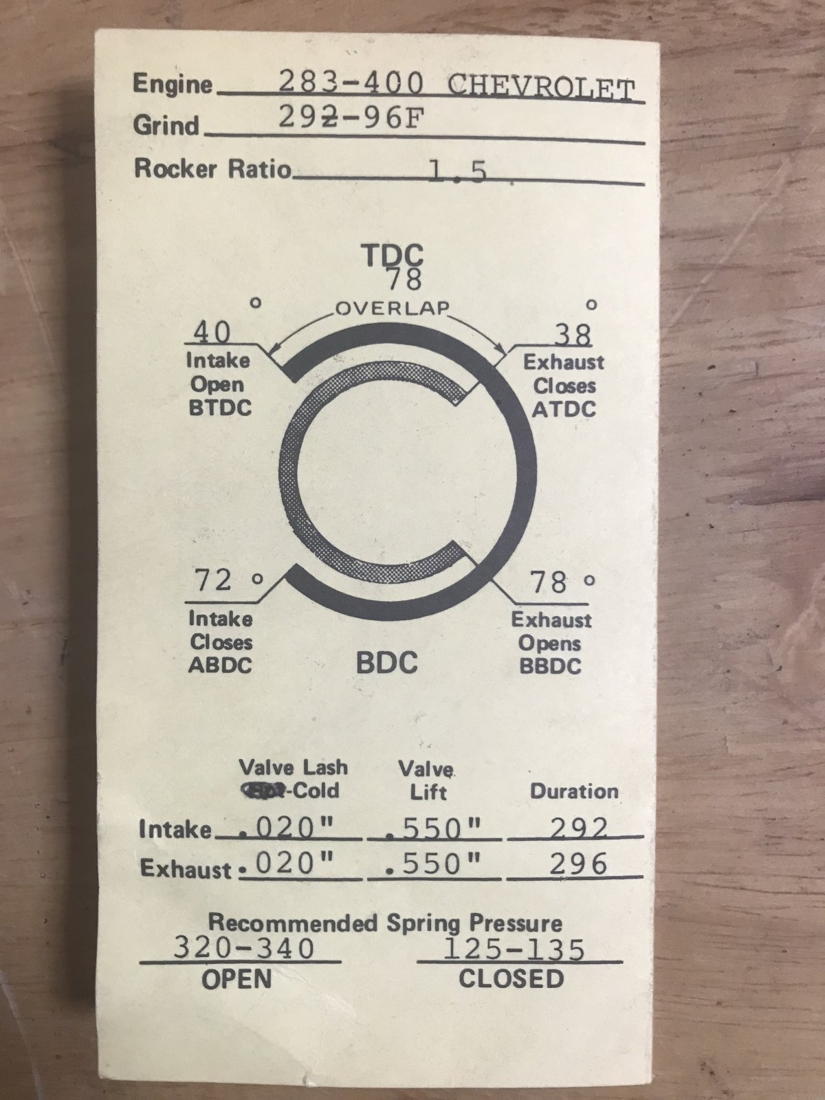

    Pretty much...I prefer to use the specs provide by someone that has been grinding cams for 60+ years., rather than the know-it-alls floating around in cyberspace...
    My cam ground to the information I provided about the engine: iron block/alum heads, roller rockers Etc. IMG_7512.JPG
