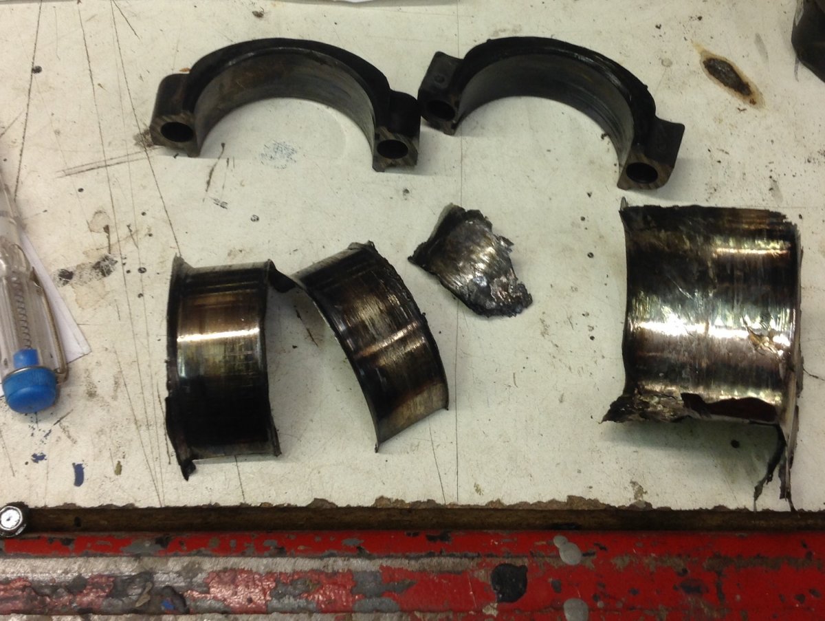

  1. Arrived with dead battery .
    Stated died on highway - no crank, no start.
    I Charged the battery, hit the starter and got the thuuuuuuug sound.
    Breaker bar on balancer confirmed no rotation.
    He said ,
    " I just stopped for gas, checked the oil and added some. Got back on the highway for about 2 miles and it quit"
    I asked "any noises?
    He said "No. It was running great"
    Crank is cooked, rod caps are cooked, and the top 1/2 of the bearings are welded together.
    It had to be knocking to beat the band For miles. The little Chevy fought hard before it died

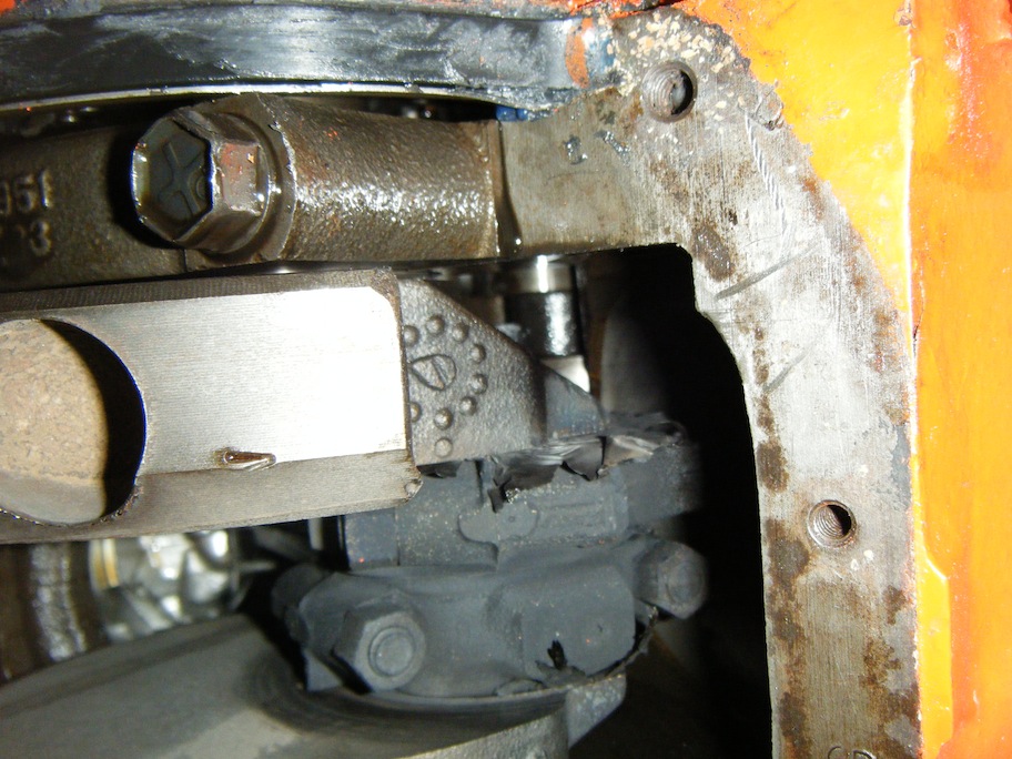

  19. This pic is from your thread,
    It was exactly as this is pictured. I could have taken it - right down to the same expensive shade of purplish grey cooked the oil off the caps color and the location and shape of the extruded bearing.
