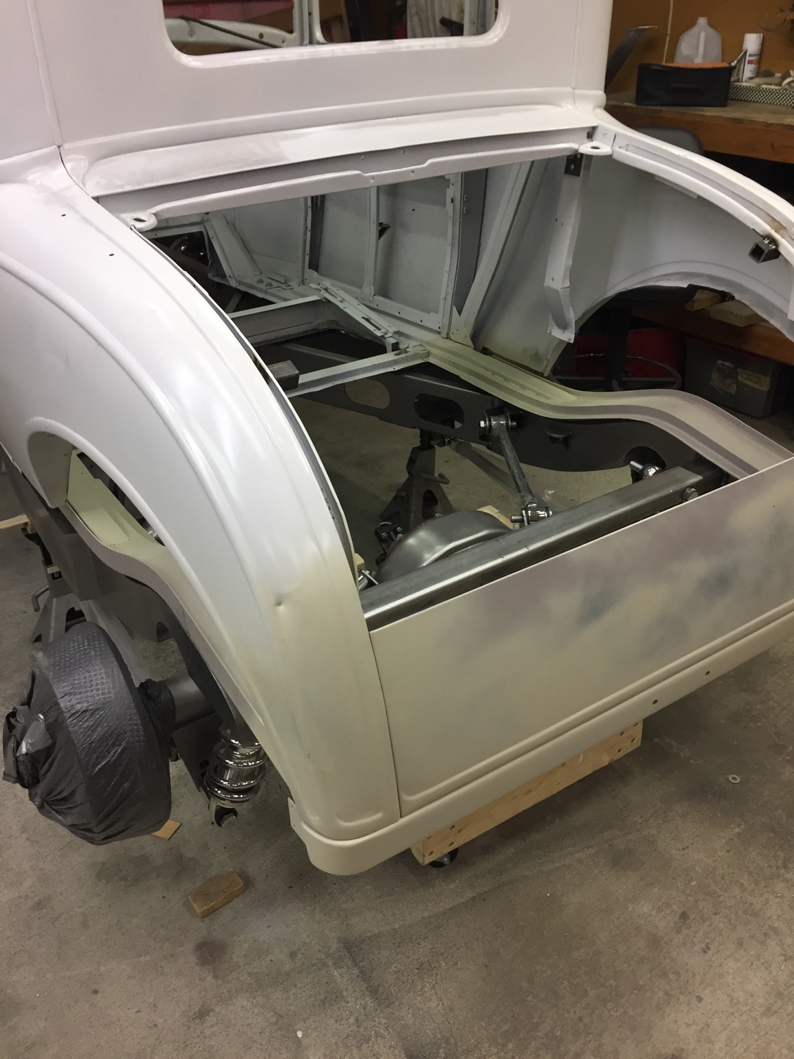

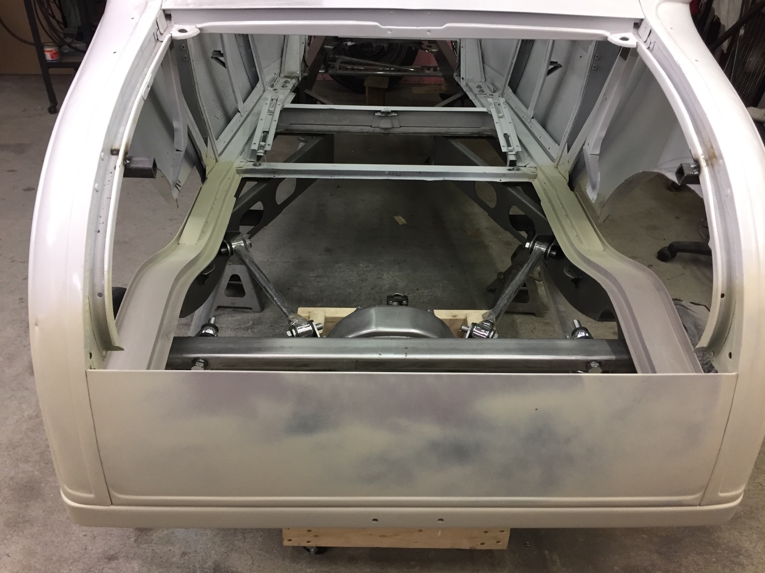

    Thanks to the Jalopy Journal for all the cool information and Swap meet. IMG_20170503_113517.jpg IMG_20170503_083404.jpg IMG_20170503_113528.jpg IMG_20170503_113632.jpg I bought a really nice coupe and had to put it on duece rails like every one else. I find pictures very helpful. Along with all the other threads I hope this is helpful too. My progress so far.

    The biggest question I had from the other threads was how to cut the subframe and what was left afterwards. I realize you have to figure out some things on your own, but I never had an unrusted model a before and didn't want to ruin my good one. I used a saber saw with a long blade and cut through the wheel well also, making the IMG_20170503_113543.jpg IMG_20170503_113649.jpg IMG_20170503_113552.jpg IMG_20170503_111056.jpg job easier for me at least and I can weld the wheel well cuts up and smooth them. I hope the pictures help others.

    I used a steadfast kit for the sub rails, really nice kit. Those wheel wells are in great shape, you'll still going to have to cut the bottom to Match the kick up on the chassis.

    It's a good idea to brace the body especially in the rear before you cut the subrail, body is very flexible. Not trying to hijack your thread, just trying to help, good luck with it

    Double check the deck lid in the opening for proper shape and gap before welding anything. The back end of an A coupe will wiggle all over when the sub rails are removed.
  9. ^^^^yes, I would fit that deck lid and check/set clearances and brace it up good as it will take off on you for sure. I would X brace the body temporarily up by the package tray area to stiffen it up.

    I agree, the steadfast kit is pricey, all you really need to do is match the curve of the kick up and weld it into the original subrail. The steadfast kit is made to run a 32 tank, so the ends extend below the rear subrail crossmember. Makes extra work if you don't want to run a 32 tank which I don't.
    If you have the panel below the deck lid, clamp it in place to line up the ass end. Hope that helps.[​IMG][​IMG]
