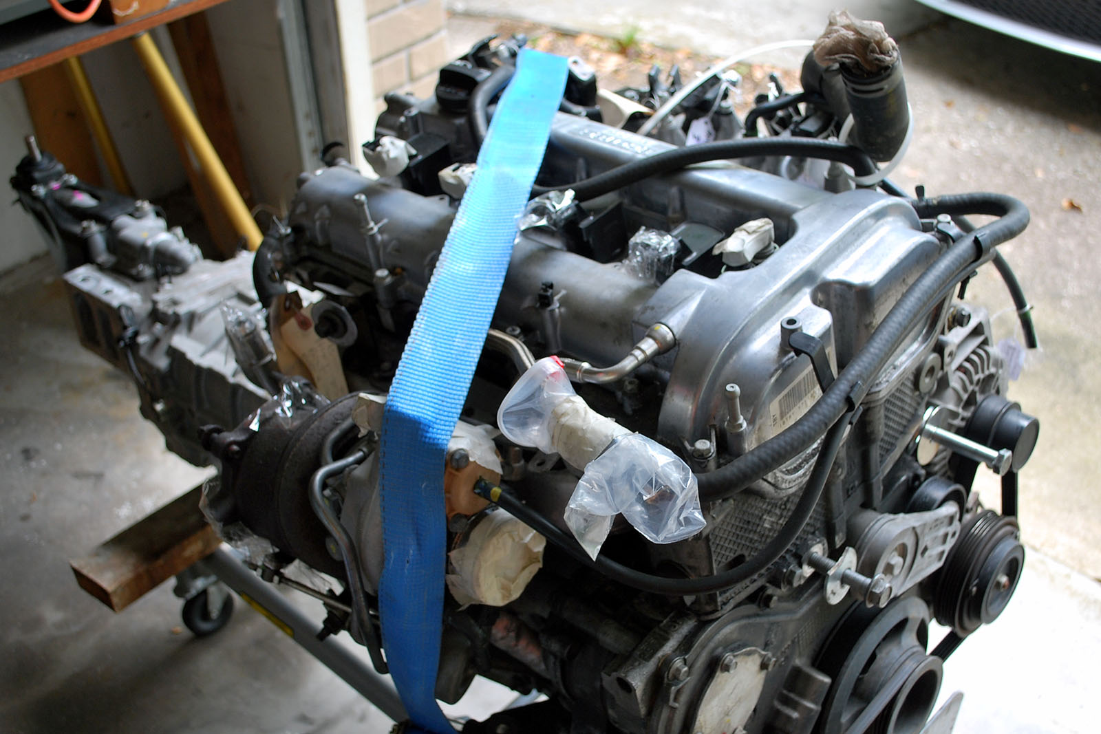

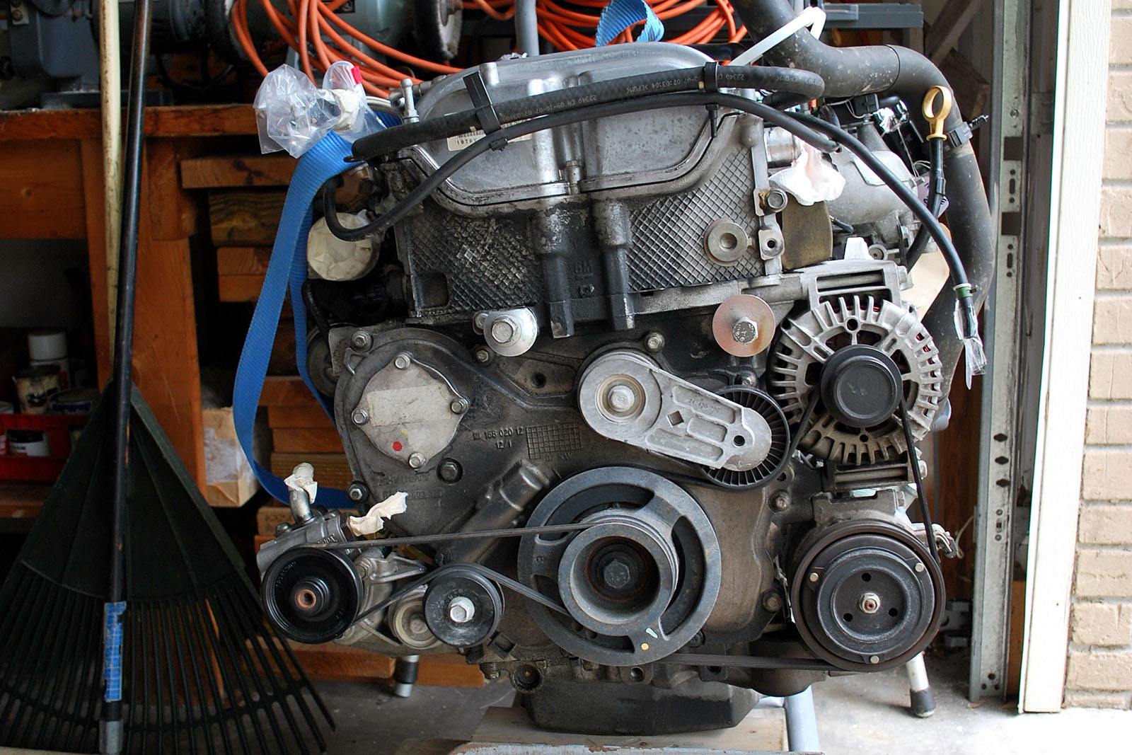

    Here are some pix of the 2.0T Ecotec. Sure reminds me of my old Alfa! And not too filthy for 64K miles. I like the fact that the motor is "flat" at the front, nothing extra will need to be bolted to the front end. The AC and Alternator are all behind the front plane of the block. That should make fitting the radiator / shroud / fan a lot easier. The motor is nice and compact, about 21" long to the bellhousing, 49-50" over all, 15" wide at the bellhousing, 11-12" wide mid-tranny, and 24" tall. Next up is a good bath and then I want to build some sort of cradle / stand with wheels that will hold the whole deal where I expect it to be at ride height. Gary

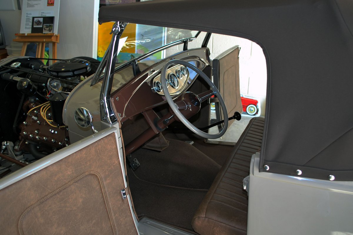

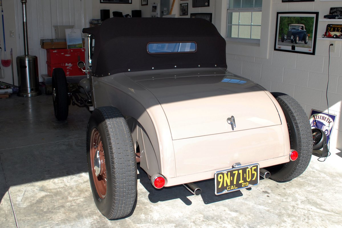

    I got to meet the owner of this little cutie last week. Bob's a nice guy and the car is quite an inspiration. The frame was done by a fellow I'm going to visit in a few days during the PRI at Indy. It just might be time to get off the snide and get cracking on my A, eh? I saw Bob's car in some recent mags and was lucky enough to track him down and then get to see his car before I leave for Indy. Gary

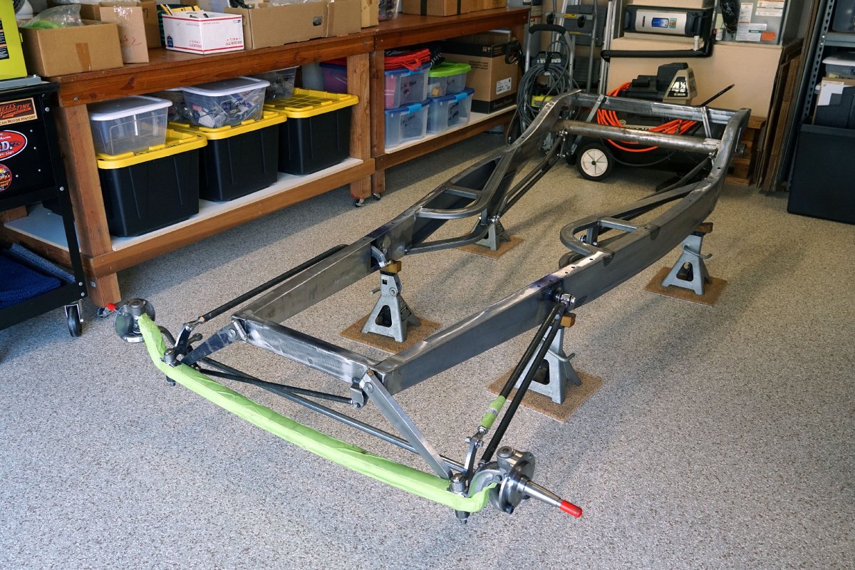

    Phase 3 of lumpy gravy... this just in... new frame for the coupe has arrived! Torsion bar front end but just a mocked up diff with exhaust tubing. The axle droop is because I cut the bailing wire used to hold up the axle to a more normal ride height, just to get a feel for travel, etc.. After all these years, and a recent garage rehab, the A is finally on the way! Perhaps I should start another thread? Gary

    Further, got the frame dolly built today at ride height, about 6.5" at the cowl and 7.25" at the kickup, or 1.5 degrees of rake. Front spindle height is about 12.5" and the rear will be around 14.5" - for 25-26" and 29-30" diameter tires, respectively. That's the plan, anyway, for now. Next up, skinning the OEM body off the chassis. Gary

    Mind sharing who you purchased chassis from. The torsion setup looks interesting.
  12. gnichols
    Joined: Mar 6, 2008
    Posts: 11,355
    gnichols
    from Tampa, FL
    I got the frame from Steve's Auto Fab (Steve Panarites), Jamestown, IN 46147. 765-676-5081. He's a couple of small towns west of Brownsburg. Gary
