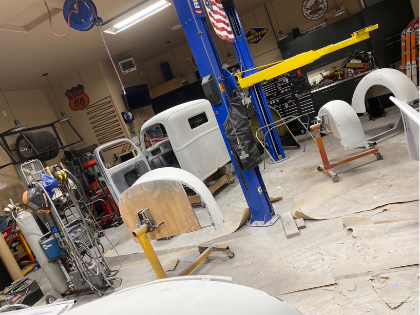

  7. Looking at this photo and thinking in my head. How's he going to paint the bolt flange where he has the fenders bolted to the plywood? Then I notice the very nice shape of the wood that matches fender shape. Just hang the fenders to the other side of the wood, well planned out Billy.

    Uh, yeah…that’s what I was thinking all along.

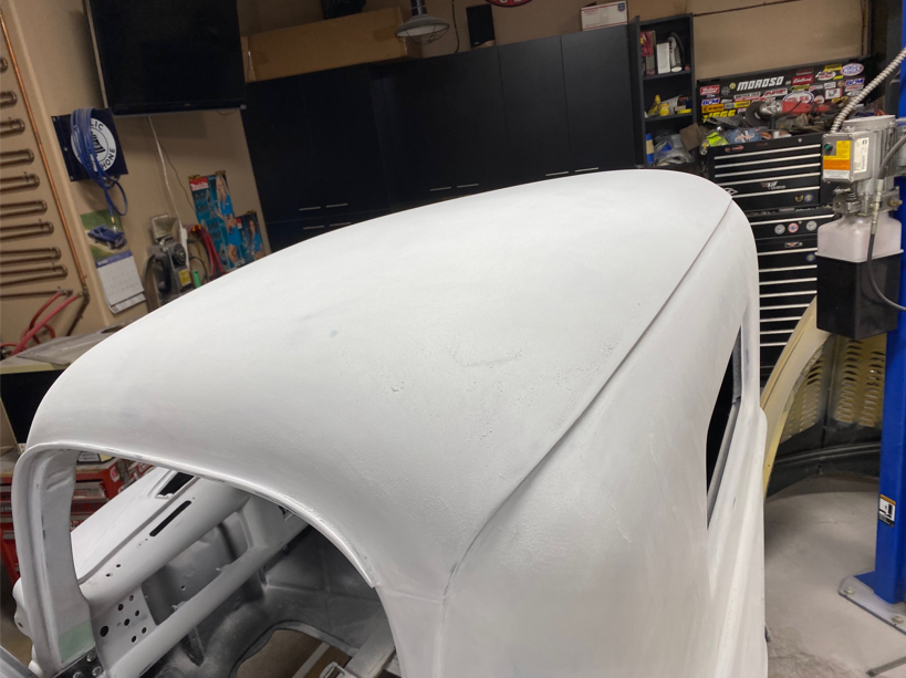

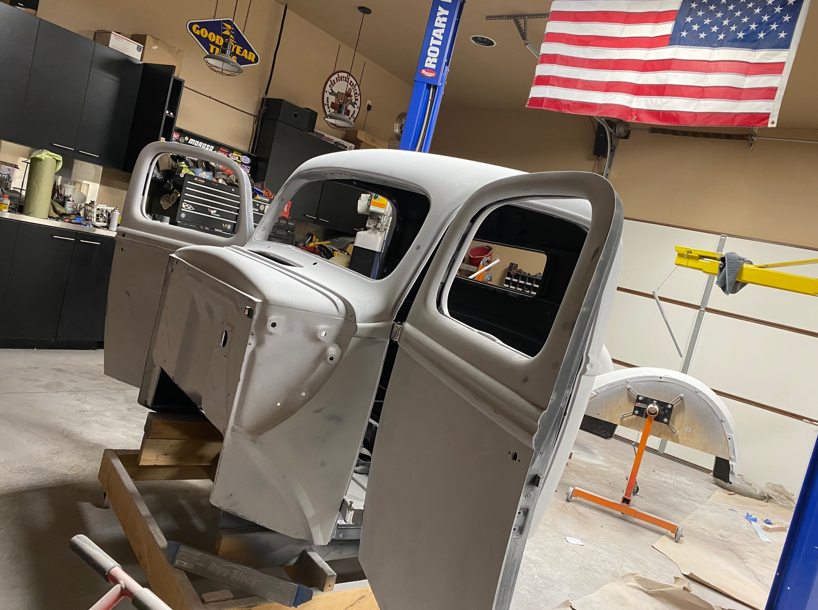

    I had to take a bit of time off for my birthday but I am back at it. Everything is now blocked down with 220, tomorrow I start the 320. The guide coat easily sanded away. I think I have it straight finally.
    Sure doesn't look like much but crap, I am tired of sanding! I don't remember what a clean garage floor looks like.
    The roof came out very nice. It had some sizable dents, very happy with the results
    Jams, dash, cowl and firewall are in 220 as well.

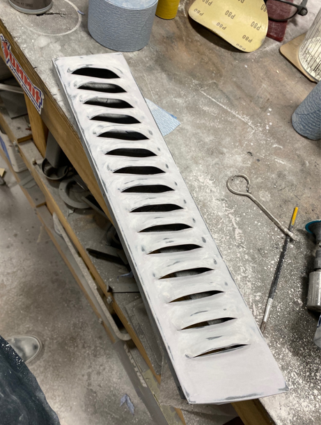

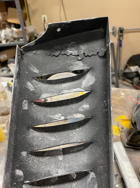

    Here is a bit of a problem solved. These are the lower bed fillers that I had louvered. They are side specific and somehow one of them got punched going the wrong direction (the louvers are canted to match the hood layout I did). Out with the cut off wheel and welder, chop the ends off and switch them...problem solved. All is right with the world.
    Shadow Creek, The 39 guy, Tim and 6 others like this.
  20. Good catch on the bed filler panel.
