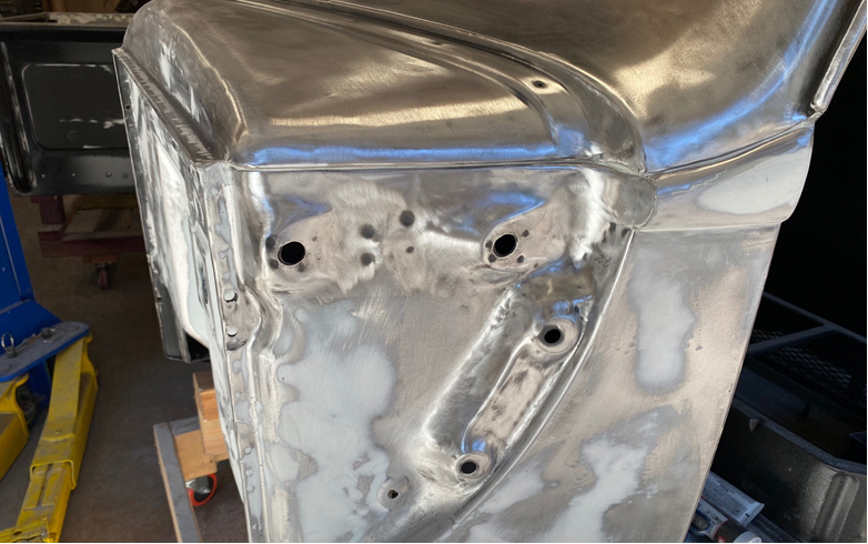

    I hate body work. I have always held this as a fact, I will always hold it as such. That said, more of the same.
    This old truck had a mirror or something attached through the left cowl. 2 bolt holes, welded and smoothed. There was also a gaping hole in the middle of the trim reveal...odd but whatever.
    I also had a half dozen dings and crap in the back of the cab, maybe a flatbed for a bit of it's life? Anyway, they are history now.
    Seems sealed, dents filled, hinges off, window channels and cowl channel cleaned and prepped. There was a little lead work in that left rear corner. Former repair. The body work in the center above the window is my dome light bracket I welded in. I seem to have good penetration (she said that...really).
    I plan on skipping a bit of work tomorrow and finish the dash as it gets painted at the same time. I think, with that complete, the cab is ready to primer. By weeks end I need all pieces in primer.

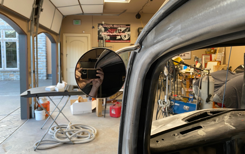

    Speakers mounted ahead of the seat riser. Holes are for motor access, mid range, tweeter, crossover and volume knob. Don't fret just yet, you will like what comes later. Promise! (I always have a plan). Woofer going under the seat, firing out the back of that mesh seat riser I built. All of this is blue tooth so no head unit or evidence of stereo....or anything else modern, when I am done. Nut Zerts installed will attach my...wait for it.
    Mmmmm, peep mirrors

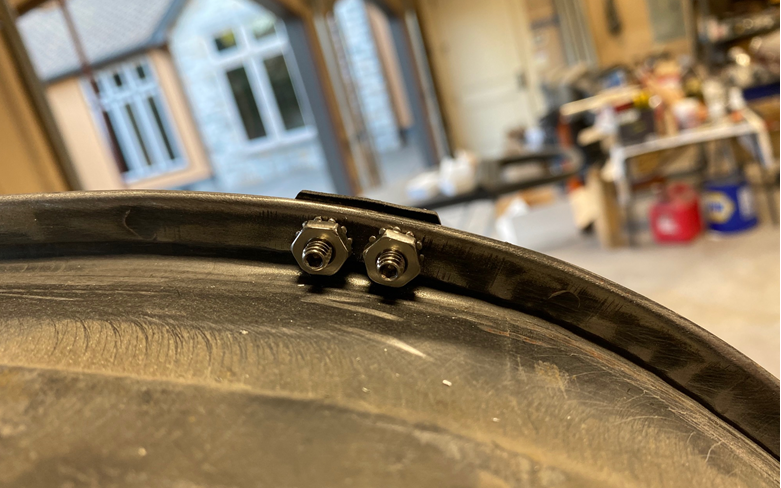

    Not just any mirrors, Hagan convex mirrors.
    These mirrors don't clamp on, they bolt on. Definitely a task to do prior to paint.

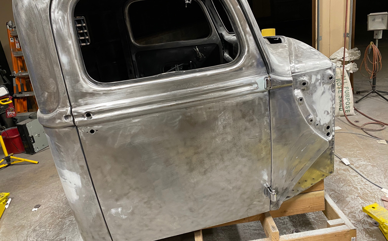

  18. Bandit Billy
    Joined: Sep 16, 2014
    Posts: 12,363
    Bandit Billy
    I will be right up front and admit I diod not get all of the projects completed today. I had to take a break and go to the eye doctor. I was grinding (yes, with safety glasses on) and a frag got past them and nick my left eye. After Making sure there was no metal in the eye I grabbed dinner and returned to the garage. While I did not get to the wipers I did strip the right door inside and out, repaired some body damage (oddly by the door striker), opened up the door jamb loom hole, added the window tracks, installed the mirror, cut the speakers holes and added nut zerts like the left door. Added the chrome hinges and pinned it in place.
    I am so tired of stripping truck panels. Fortunately this was the last one!!!!
    The front gap on this door is a bit tight. I need to address that prior to paint.
    I am so glad to be finished for the night. I am going to go take a hot shower, pour myself some dinner and relax.

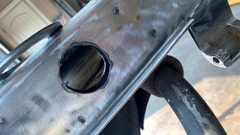

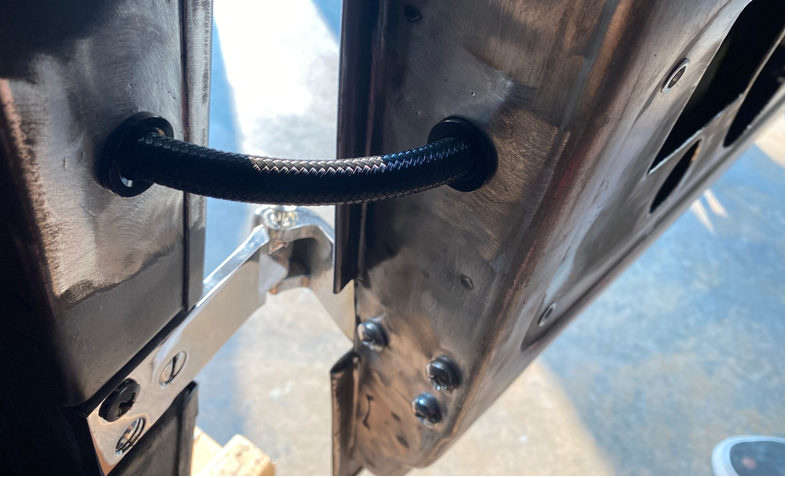

    Small stuff that must get taken care of prior to painting, like the wire loom in the door jamb.
    I reamed out the holes in the doors for the stock door stops to give me room to work, this holes is already much too large for the looms.
    Then used the plasma cutter to cut the hole to accommodate a 1.5" steel washer with an appropriate size hole in the center. Much more better!
    Then the same to the cab door jamb
    And that worked well. I bought these looms in black hoping they won't be too noticeable or distracting. I will add a 1/2" rubber hose stop to them to limit the door travel so they are both looms and stops.
    And yes, I have one hinge screw that isn't chrome plated, the chrome one needs a bit of thread repair.

    The looms are cheapy Amazon $24 stuff. The looms work by sliding one end (either A pillar or door depending on installation) through the aluminum fitting that installs in that hole I created. There is a plug at the end of the SS tubing to keep it from sliding all the way out of the fittings. That made me think of adding an adjustable stop on that SS hose to limit the door travel.
    I was yakking to @Pist-n-Broke last night about my clever idea and he told me he that years ago on his car (I am always late to the party). He dropped an obstruction through the tube (missing the wiring) that limits the door travel. It wouldn't take much to stop that hose from sliding through the fittings. I was thinking rubber stop like on an air hose but smaller. Anything that can clamp a 1/2" line and stay put.

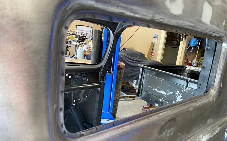

    Bandit Billy
    I worked on the truck a few hours yesterday and got the left door jamb done, stripped all of my window motors, switches, mirrors and wire looms to prepare for paint. The last fabrication was the Newport wipers. Wow, they make this project easy. Kit comes with a steel drilling guide so you get the right side hole in the correct spot and the guide includes the pattern to enlarge the existing left side hole. I used a small drill to get started and then air file with an acorn burr that did a tidy job of fitting the wiper transmissions in the cowl. I read in the box that if I send the drilling guide back to them they will reward me with a free Tee Shirt. Woo hoo! Something new I can destroy in the shop.
    Of course having the cab dismounted and no cowl vent in the way made it even easier.
    Fabrication projects complete. Now, let's make it black!
