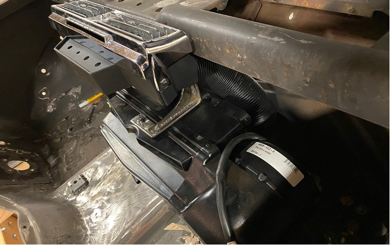

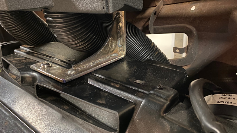

    Working on the inside of the firewall, mounting all of the crap that goes into one, trying not to forget anything important that will require a hole in my neat firewall or new floors. The brackets that came with the Air Vintique AC system were a joke...
    I say were because they are in the garbage by now. Now this is how you mount an under dash AC system if you don't like rattles and shakes. That's the rear bracket that attaches to a stud I welded in earlier. This is the front.
    I picked up the same holes that mount the AC vent I built and it had to move around the vent hoses, thus the jog. It is over built and will be powder coated semi-flat black when finished. Here it is mounted.
    And a close up so you can see the issue with the vent hoses. Overbuilt is built right! Of course it would cost about 20K to have an AC system like this installed... but that is why we build them ourselves!
    brEad, Tim, GordonC and 11 others like this.

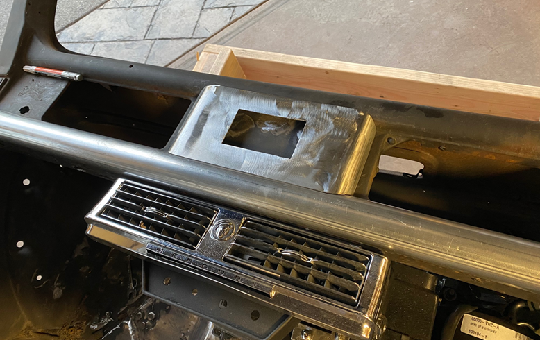

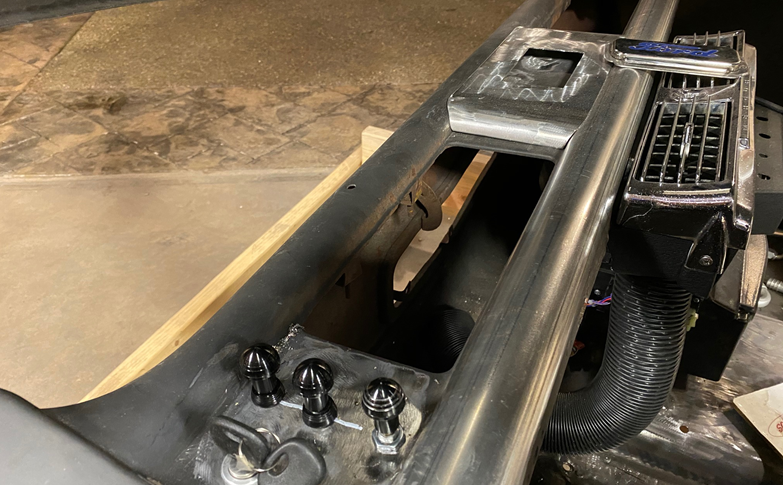

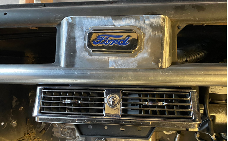

    I could have chopped out the truck dash and replaced it with a deluxe car dash but it has been done...a lot. I wanted something a bit more "me" and hide some OT stuff while giving the dash an original"ish" appearance.
    I started by filling every hole on it and then attacked the lower bar. On a 40/41 they have a break in the middle that looks unfinished. I bought 4 feet of 2" exhaust pipe and rather than trying to blend in the center section I just overlaid it.
    I boxed the ends and the Wizzard stopped by to see how I was fairing and he suggested losing those ends and rounding the tube over a 2" trailer ball. So I cut them open and followed his advice.
    Much more better! You can see I also have been working on a center fill to add some dimension to the dash rather just being flat all the way across. That took some time and Crown to figure out but I like it.
    Ass I mentioned in a post above, there are switches and such that I need access to but do not want to look at them all the time, plus they would just ruin the dash. A 41 (different from the 40) has a rectangular dash emblem that on its own was not quite big enough to conceal my OT items. So I crafted a plate to attach the emblem to and it will hinge from the dash.
    Not bad if you saw how I did that. I still have to source a small zero clearance hinge and a magnetic catch to make this functional but it will be cool and very discreet.
    So next step is weld the center section up, grind it smooth and cut the access hole under the emblem.
    And with the emblem just sitting there for now to get the look.
    I think I am going to weld studs inside the lower tube and bolt this to the dash rather than weld it and make a mess. If it was a removable dash I would weld it but this is a welded in piece so the nut and bolt method is a go. The seams are tight! But I will still finish them with sealer and paint.

    Next up was the required controls, this is the layout I decided on and I am happy with hit.
    All of the switches are mount and there is plenty of room to wire and service things in the future.
    GM style headlight switch is on top, fog light switch middle and a New port Wiper switch bottom. Those things are massive behind the dash so I chose this location. The keyed ignition is on the left. I mounted it high enough and with nothing below it so the keys could dangle without interference.
    The knobs are cool, black 40 style from SoCal but I really want to add three silver stripes to them like this
    I tried on the wiper switch but that took forever with a file and I am not satisfied with the result. Anyone have any hot ideas on how I can pull this off on 7 Knobs? A lathe and a fine braided wire? Any advice is appreciated.

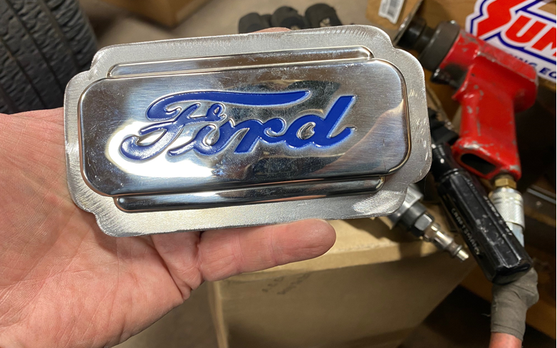

  10. I'd paint that rectangular Ford emblem's blue script black or white to go with your paint scheme.
    Nice usage of the exhaust tubing.

    Oh for sure! Not only is that blue paint not where I am going but it is very poorly done!

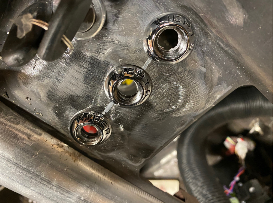

    I bought these bezels a while back, ford truck stuff, 50's? Anyhoo, i had to tenderly shave the back of them flat which took some doing. I left a locator pin (that was the thickness of the metal I cut away) that prevents them from turning in the dash.
    I drilled the dash at 6 o'clock for the pins and added the headlight switch recess to lock it in place.
    And when it it is said and done it will look like this
    Somewhere in the boxes of parts is an amber indicator which i will add alongside the middle fog light switch.
    The wiper switch is that huge Newport unit and the post is add shaped so I had to drill out a SS washer to make the fit nice and snug, you can see it there in that pic. Black knobs with silver stripes against those bezels...cool. I will bevel and polish the ignition switch bezel to match.
    That doesn't look like it took all evening...BUT IT DID!

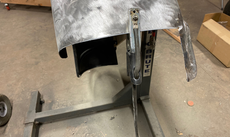

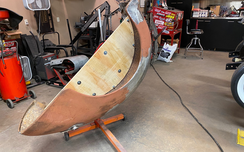

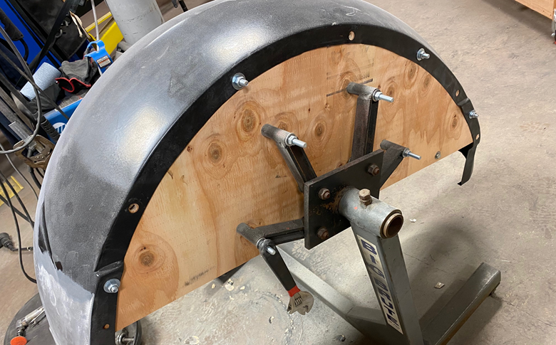

    This was fun. Time to work on the fenders, which are round and don't sit still well for hammering, welding, grinding, etc. Enter the frame rotisserie...again. I love these engine stands! The only issue is they needed to be taller, the fender doesn't quite have room to rotate 360 so you have to pull it out (careful) turn it over and reinsert (I said careful!).
    I went to Home Despot (LOL) and had them rip a sheet of plywood into 2 foot chunks. Laid the fender on top of one and outlined the fender and marked the holes, then bolted it up.
    To the other side I bolted the engine receiver/head/whatchamacallit. Then slip it into the stand.
    Note to self, make them taller next time!
    Seriously, how easy is that? They roll around, spin easily and let you weld in position!
    I may go on shark tank with this one!
  18. You're going to score well with that one. Good idea.

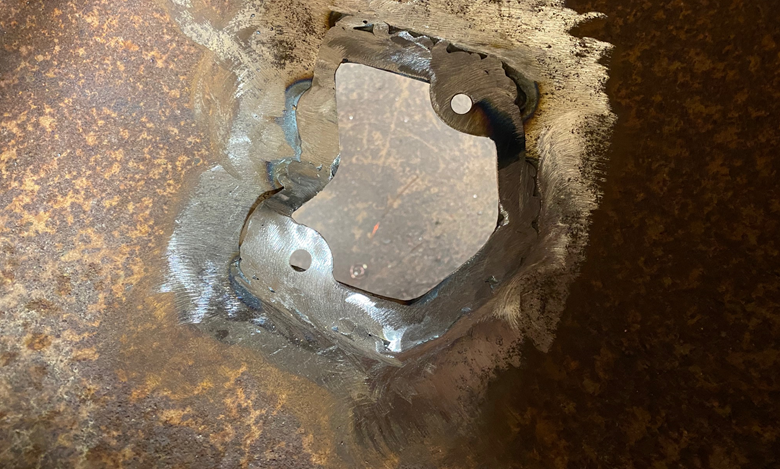

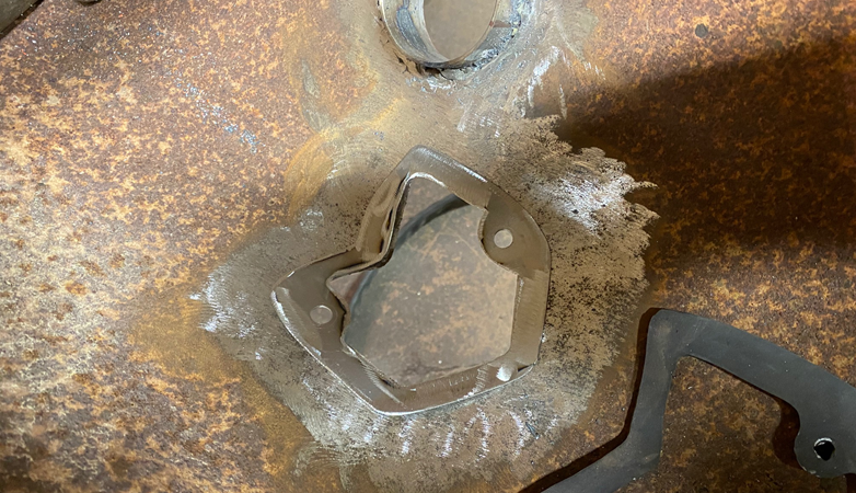

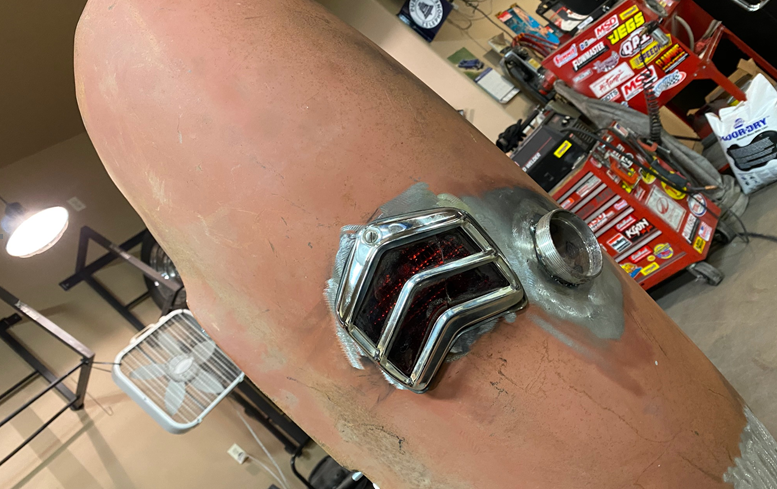

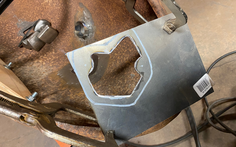

    And while we are on the topic of welding in position (segue) the holes for the passenger car tail lights were already cut. One by the PO and I matched the height on the right fender. But they needed the inner support to bolt to and reinforce them. I had asked a HAMB buddy up north for some pics of these things and he sent them to me that showed what I needed to do. I followed the pictures but added my own twist a bit.
    Disregard the surface rust, it is headed to the blaster soon. I sketched out the basics using the gasket as a template
    And clamped it to the fender and hit it with the plasma cutter just any craftsman would do...
    I did the middle first so I didn't burn my hands trying to hang onto it and cut (I really need a steel table)
    I did pirty it up a bit but here is where I deviated slightly. I wanted more depth to the mounting holes so the tail light would be held firmly against the fender so I bent the new support bracket to create a cavity.
    Then I welded in. This will all be Rhino lined soon!
    OH CRAP! IT"S UPSIDE DOWN!
    Ok, the fender I upside down in the picture. But had ya going! :cool:

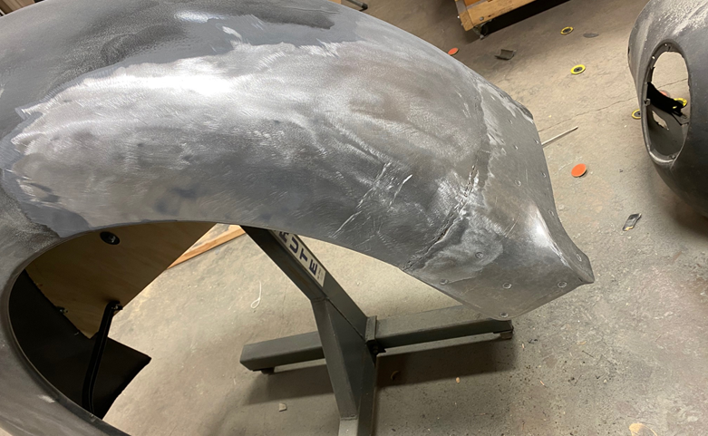

    It will make body work/blocking easier and I am going to use them to paint the fenders as well

    That fender rotisserie is a great idea!

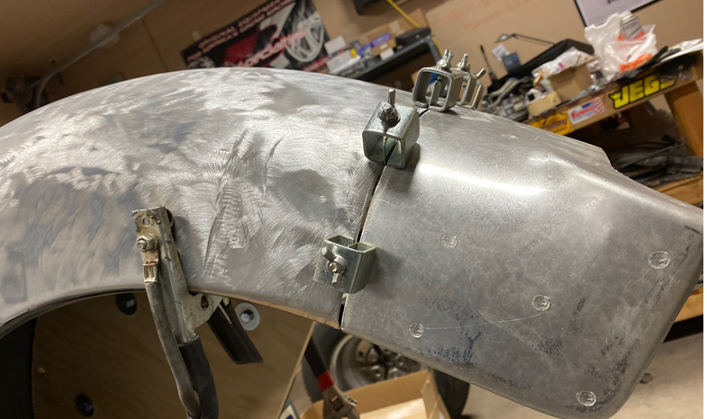

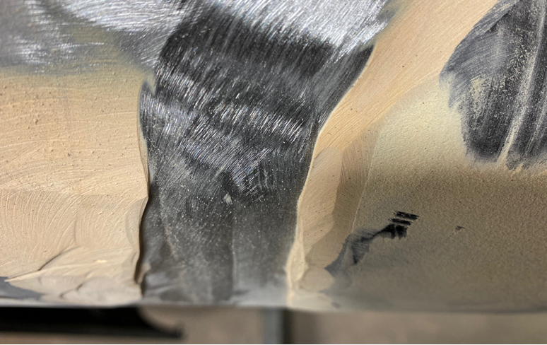

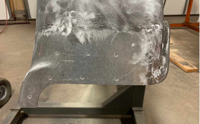

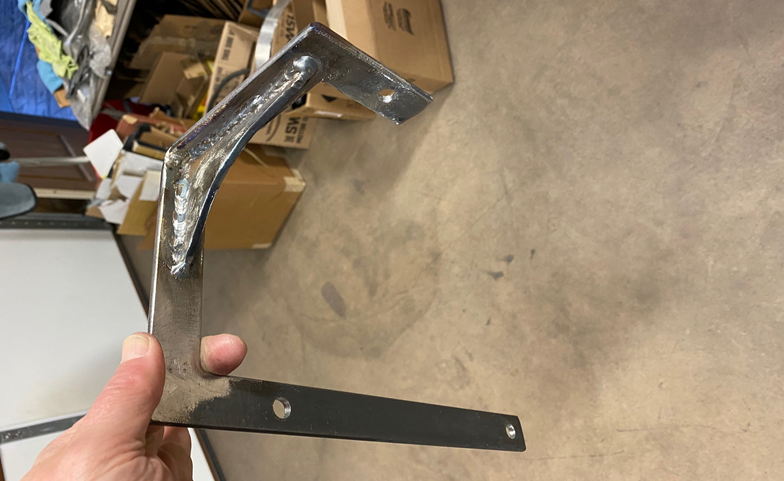

    Another day, another fender mounted on the "Fender Bandit"...(just trying it out).
    This one has a welded nut and bolt for infinite adjustability (and the long bolts make a handy place to hang the metric panel bender I use to adjust it.
    This fender had been previously "repaired"
    I am not a professional (but I play one on TV) but this isn't quite right
    The word "filler" should never be confused with the word "construction material".

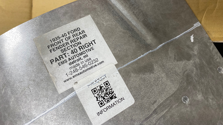

    Anyway, I had purchased a lower fender extension for this side since it was a later model fender and had a different running board mount. So I tackled it last night.
    Made in Detroit USA. What a coincidence. Since there was no damage on the fender after all of the mud was removed I cut this panel off just below that indentation so I didn't have to mess with it.
    Cutoff wheel was deployed on the fender next.
    I saved the inside corner where I had bumped it out to match the lower bed filler panel.
    Clampy, clampy, weldy, weldy.
    And once tacked I moved to that inside corner, the metal slightly overlapped so I made a cut through both panels so they would match perfectly. Then some welding and grinding. I do this different than most probably, I like to take my gloves off so I can feel the heat on the fender for 2 reasons; first it is fricken cold in my garage and second I can tell if I am getting the metal too hot upload_2020-12-31_12-15-0.png
    Now isn't that better? And it weighs less!
    Today I will roll the fender around, weld up the fender lip and tidy up inside and then move to the tail light support bracket.
