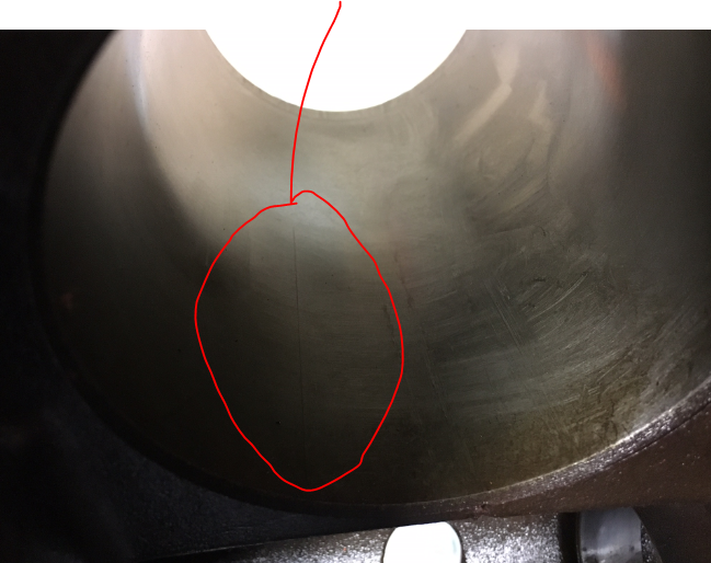

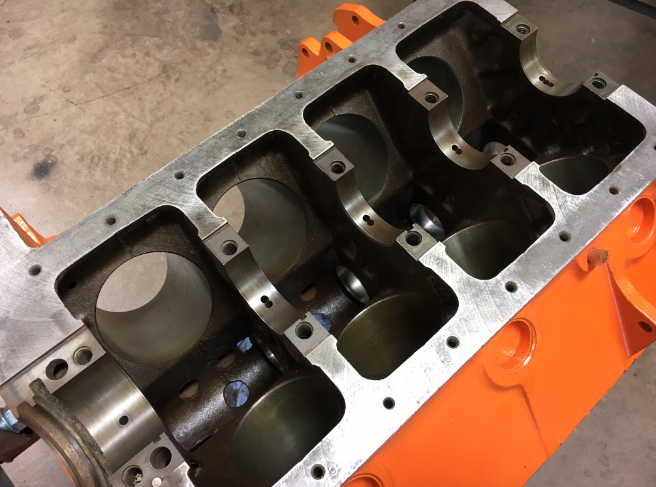

    upload_2018-7-1_21-3-7.png I cleaned up the block tonight. It was machined in 87 according to the receipts.
    I ran there ball hone through the bores with plenty of oil. cleaned up nicely. There is a ridge but is minuscule.
    The slight surface rust I removed using only 10/40 and emery paper.
    Should I be concerned with this groove in the cylinder wall?
    Hombre, kidcampbell71, Deuces and 3 others like this.

  15. the groove will fill up with carbon they used to say:rolleyes:
    Nice score by the way.....
    Hombre, loudbang and czuch like this.
  16. Way to go Billy, and I'd stick it in that Bird also. If the rings are Cast Iron that little mark wouldn't bother me at all. Even if they are a Cast/Chrome and that's the only one, I wouldn't loose any sleep. What machine shop did the work on it?

    Nope! Don't sweat that small shit....
