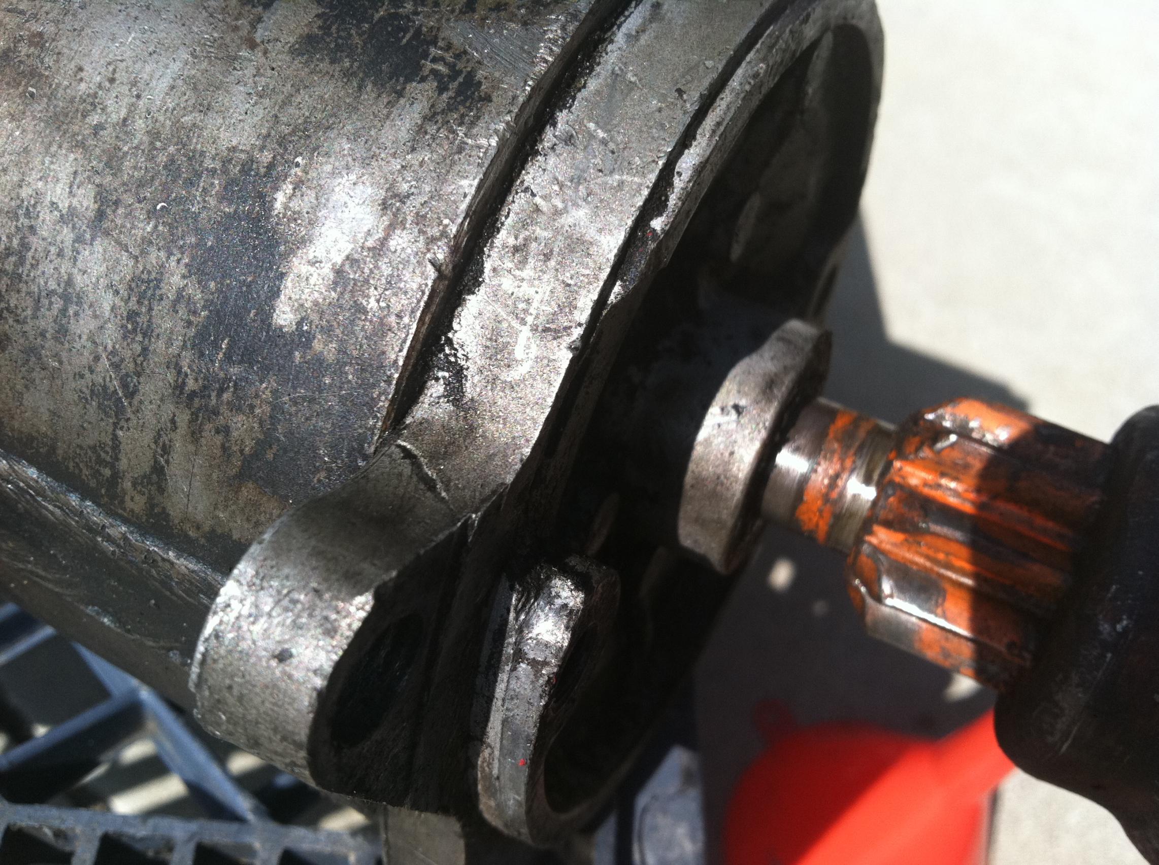

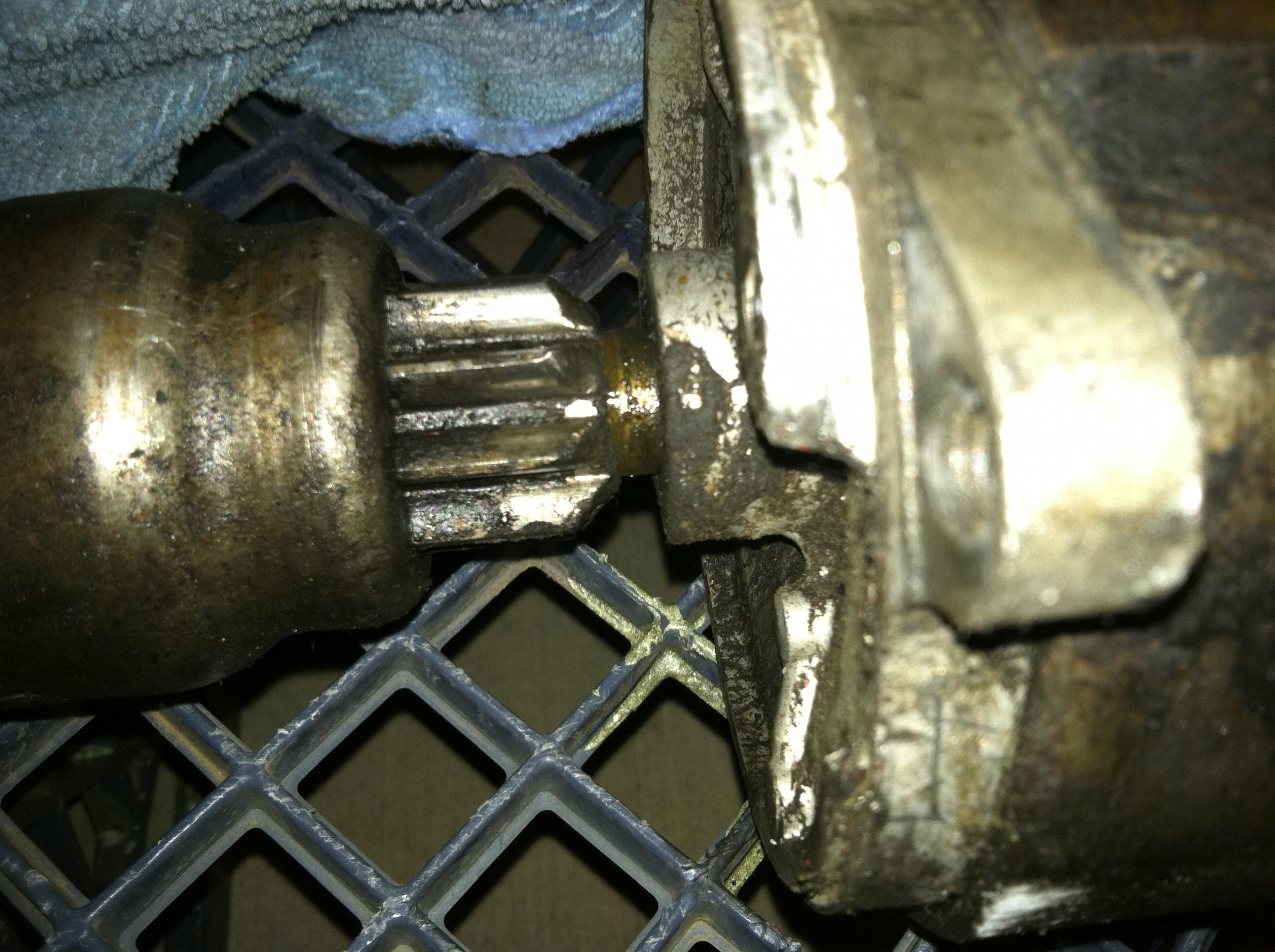

    Hey, thanks for all the replies. So, I pulled the starter, and I really don't know what to look for, but it don't look right. The first pic is the entire starter, is this how the bendix should look? The second and third pic show the play in the starter shaft, it slides in and out about 1/4"...is this normal?? The fourth and fifth pic show scrapes along the bendix(?), I think this could be the source of my "death rattle". Would the play in the shaft cause this? If this is the cause, what would I do to fix it.

    luvzccr: I hope that isn't it, but thanks for the info. Check out my above post, do you think the starter is effed up, and causing the noise? I really don't know if that shaft play is normal, but it seems excessive. The flywheel seems okay, from what I could see (more feel). If I hear the starter play is normal, I will pull the pan, and then start tearing into the engine...yum

    Thats interesting you took the starter off and it looks the way it does. After leaving work yesterday I was thinking a bit more about your noise and how maybe the starter drive is not all the way out and the flex plate is kissing it.

    Is it possible to start the motor, and then loosen or remove the starter to see if that is the problem? Those scuff marks on the starter bendix don't look normal. And I think the drive is in the wrong position, normally at rest the drive is further away from the body of the starter, and when it spins the inertia "screws" the bendix into engagement with the ring gear. Is that screw section of the starter shaft lubricated, and does the starter gear move back and forth easily?

    Get some tool maker dye. Clean the starter off spray it with the dye, reinstall the starter. Start it back up to listen for the noise. Pull start see if marks are in the dye.

    the starter teeth look a little worn, but i'd guess its a separated damper. my mustang did that and it sounded awful.

    I really think that two years of sitting idle just allowed the grease on the starter bendix to dry out a little, now it's sticking and raising hell. You don't have rod bearings go out, cam chains suddenly loosen up, etc. just from sitting. He has good oil pressure, he's already taken the belts off and run it, same noise. And the fact that it isn't related to RPM should rule out most of the stuff that's being suggested as faulty.

    Ebbsspeed: the bendix is bone dry, and takes effort to move. I will be sure to lube it before I install again.
    I pulled the starter and painted the bendix to identify any contact points (as Keep suggested), reinstalled the starter, started the car, took the starter off again (I really need to replace that top bolt with a stud!). The only paint missing is on the gear where it engages the flywheel.
    There is 1/4" in slack in the starter shaft (the shaft can pull in and out of the housing a 1/4"). Is this normal and could this slack cause the starter gear to make contact with the flywheel? Pictures below show the slack I am describing.

    Sounds like maybe the starter gear is not disengaging from the
    flywheel ring gear after the engine starts ?

    hi i fired my 368 with with about the same results. It was the starter not disengaging from the starter ringgear. worth a look

    Hey guys, thanks for responding. I need to know if the slop I described a couple posts above is normal, before I reinstall the starter and move on. Thanks for your help.

    i just swapped a adapter and th350 tranny and just pulled my ford-o-matic and starter that worked fine and just looked at the starter that looks to be in great shape and it has 1/16 to a 1/8 at most play on starter(not like your 1/4) id suggest you just buy a new starter and rule that part out....also on the trouqe converter the tabs that bolt to the flywheel some where rivited on if those rivets get loose they make a horrible racket also. just my 2 cents

    I also think its the starter drive.
