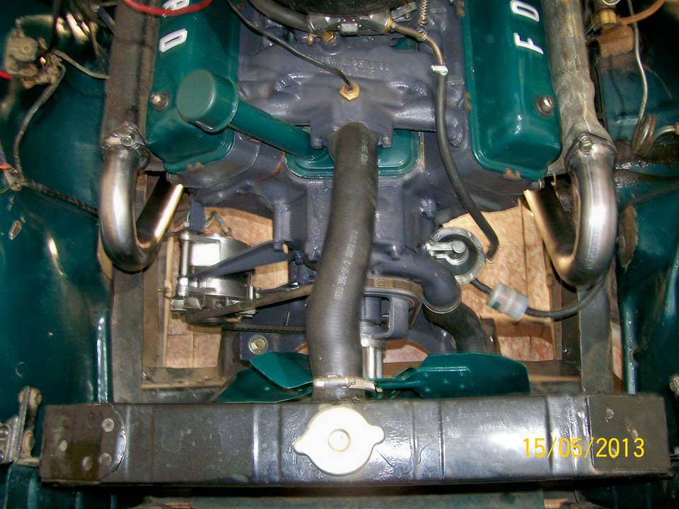

  1. I like the "under the hood" look and wonder if it is something I want to do to my '60 F-100 with a 292.
    What am I getting into? .. does the engine breathe ok? .. any problems associated with the modification like clearing the steering box, etc? ... is there a HP increase?
    I downloaded these pics from a f-100 site. Click to enlarge.
  2. I like the look of that better than one exiting off the front and one off the rear like most people do when doing duals this way on a Y Block. So did they just cap the rear dump on the passenger side?
    Where did you see this posted originally?
  3. Yes, the right side is blocked off .... I am not sure if it is just a plate or what. The site was a facebook site for 57-60 f-100s I believe.
    I never did care for the looks of the crossover pipe on the stock setup and aftermarket rams horns are darn pricey.
  4. find some 56 ford car manifolds, the right ones are big and exit rear
  5. I had a '56 with stock cross over pipe and one with a modified stock into duals exhaust. I honestly didn't notice a lot of power difference. I'm sure it does help some, but not a much as a set of headers or something. Sound is probably the biggest perk. There was no issue with clearances or anything either on my truck.
    I just had a plate on mine.
    Oh I agree. There are several "better" options. The mod pictured is the most economical.

    Passenger car manifolds do not fit on trucks. My opinion would be to save up for a set of ram horn manifolds. Look better and flow better.
  8. As far as one looking better than the other, I would think that would be a personal choice but the flow situation, or lack of is one of the questions I would like to find the answer to. It seems the left manifold would have no change ... the exhaust is going the direction it was intended but the right side is a different situation . The exhaust flow direction in that it is exiting out of a flange the was designed to be the entry point of the crossover gases .... seems there would all kinds of turbulence going on in the exhaust runner on that side.
  9. Yeah, I think it would be a eyecatcher ... sorta like running top dump OT caprice manifolds on a hoodless sbc .... always gets that second look.
  10. You are correct, the steering box gets in the way. But you can swap sides and dump at the front.
    Almost anything is better than the cross-over pipe. I've seen a lot that dump one at the rear (pass) and curve the one down out the front but this is the first time I've seen this set up. I like it! Different look. I doubt it flows real well but it's better than what it replaces. ;)

  13. Thanks for the input McTim. This brings to mind an important point. Since I plan on going with a 2-inch drop axle then I need to have all that in and ride height established before the exhaust is fabbed. The flipped car duals look like they are darn tight to the axle.
  14. To the top ... I need more input.
  15. Its been awhile but I have the f-100 sitting at the stance I want .... exhaust is next.
    I'm still open for comment on the setup I plan on going with ... additionly, I plan on running straight pipes all the way to the rear ... noisy or not? I don't plan on listening to music! LOL

    F600 tilt cab manifolds bolt right on and look a lot better, also known as "rams horn" manifolds with a center exit. They wont work on cars but will on pickups, I had a set on my 63 f100
  17. Yes, that would be an option for dual exhaust ... but I pass. I am after the look of Gabriel's horns when I lift the hood ... I'm after that double glance!
    Thanks for the comments but concern with flow was answered, "Better than what you're replacing it with." , provided by a y-block guru... so I am going with it. I am now after input from someone that has done/seen it .... heat transfer?, tone?, HP increase (if any)? clearance issues?, etc.

    Just about everything would be a step-up from stock, even "split".
    I like the Iron Y-Block ram's horns. They flow pretty well, and don't look out-of-place.
    I put them on my blacksmith's truck. They made a noticeable improvement in power and sound.
