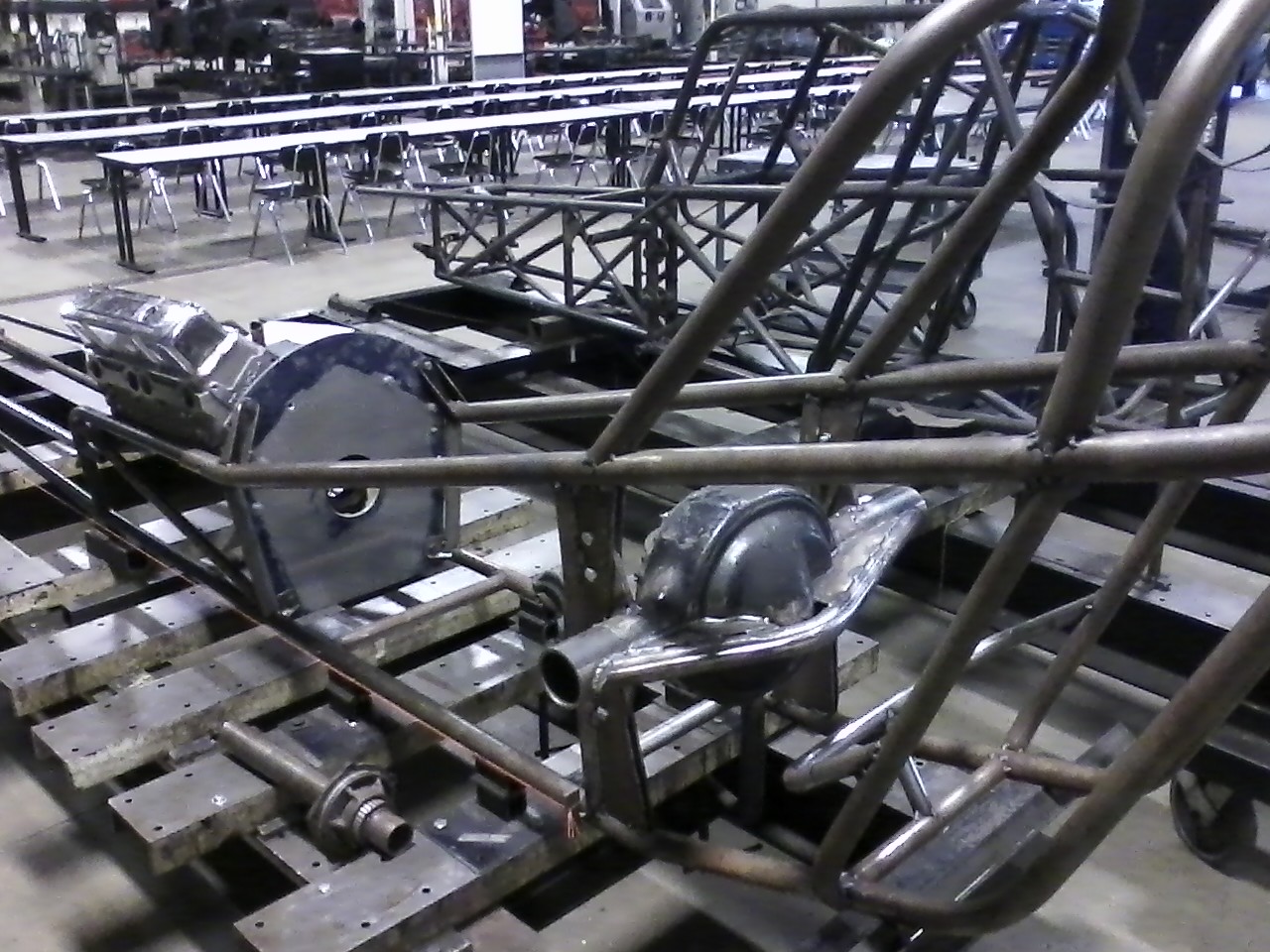

  1. Can't say we're rotating the earth with the progress on this thing; but the "Mild Steel Missile" is a full length chassis now, and the "bar" is out. The block is hanging on it's mounts. There is a lot of work in progress on the front axle assembly as well. Now I get to watch it sit for another 8 weeks until the new class gets around to live work...:(

  12. Well the car looks about the same, but we did come up with a 'Glide case for mockup.
    Also had a Corvair steering box donated. Luckily I have a student in this class who is an experienced machinist, so I showed him how to reverse the input shaft and lengthen the pitman shaft to fit the dragster chassis.
    It turned out pretty nice! Hopefully this week it will be mounted in the car.

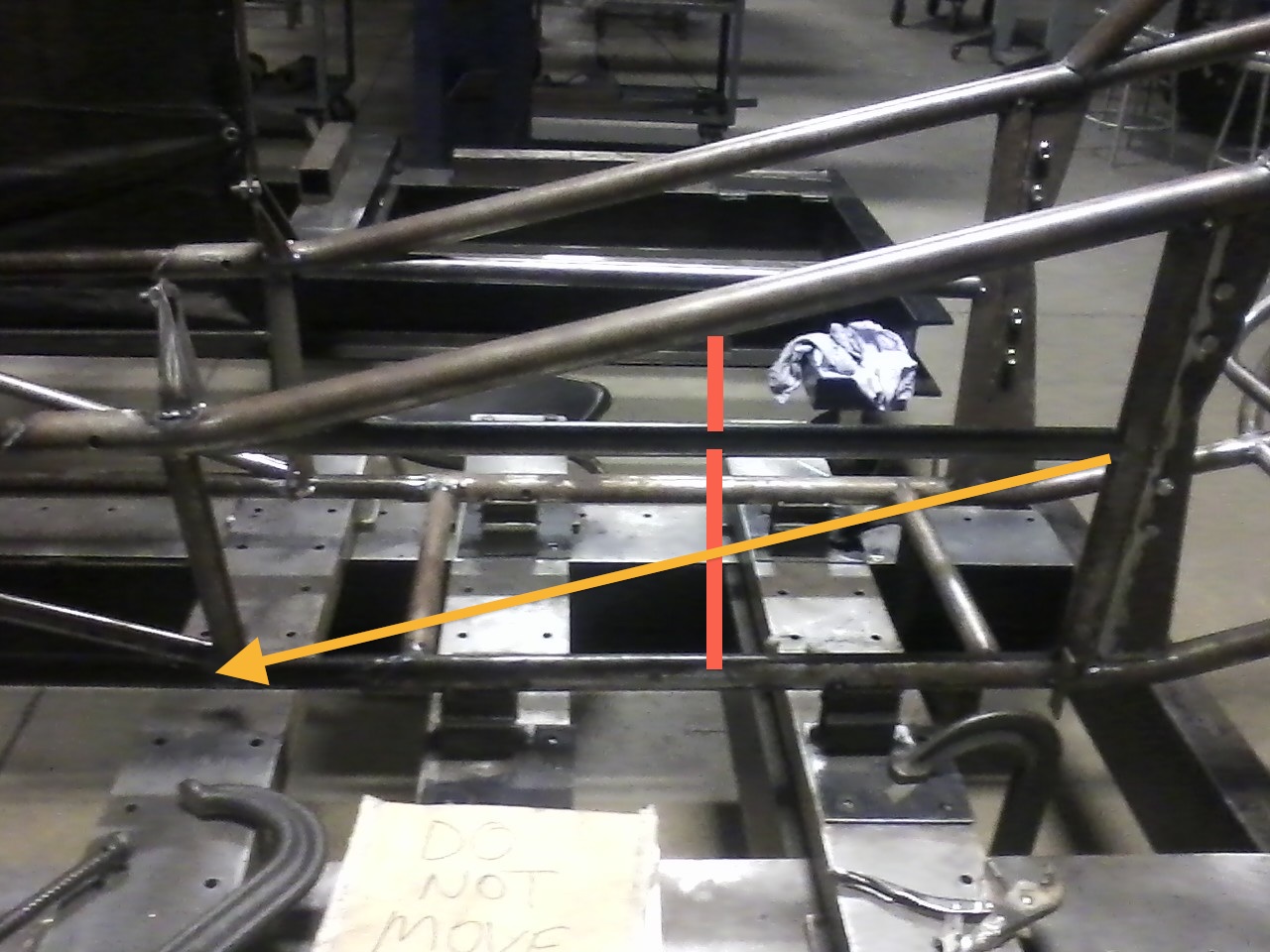

  26. Well, sometimes you (I) just screw up. I have the rules, so there's no excuse... The rules say that the distance from the rear axle mount upright to the next upright tube forward must be 28" or less. Ours is 35". I've looked at literally dozens of photos of FED chassis in the process of designing this thing, but most of them are clutch cars, or use a shorty 'Glide; so it never occurred to me that the tubes at the motor plate were going to be further out than the rules allow.
    We've already started on the "K" braces from the rear axle tube, and I really don't want to cut all that out if I don't have to. Yes, the finish welding was premature, but the guys got "go fever" and I was busy with other projects...
    So, here's my question. Would it be ok to add an upright in 2 pieces as shown by the red line in the picture? That upright would be intersected by the lower portion of the "K" brace shown in orange.
    I really don't think there is a strength issue the way it is now. The "K" braces are much larger than the rules call for (1 1/4 vs. 3/4"). Again, I know it's "different", I'm just wondering if it will get through tech with the mods (as an injected small block bracket car).
