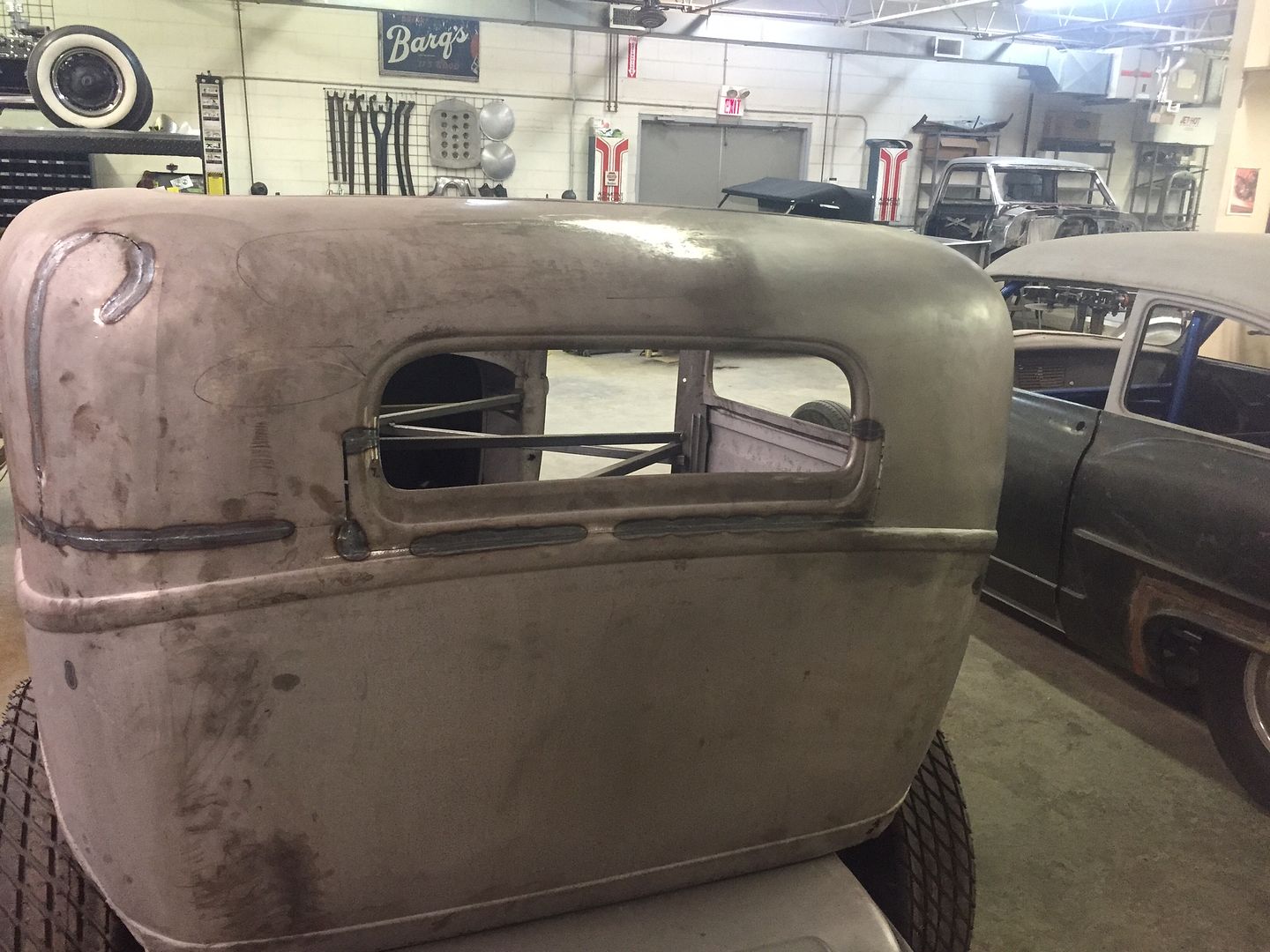

    i have not updated this project in while. things were put on hold on my end for a couple months while i was dealing with preparing to move shops into our new location. didnt want to cut on the car to move it when it was in a good spot to be moved and sit for a little but while we got back up and running.
    so now the fun starts. we started on the chop. 4.5 inches in the rear, and 4.125 in the front. leaning the posts back. we also used my signature curled relief cut in the rear corner to radially shrink the compound curve of the body to get everything to line back up. still lots more to do with the doors, hinges and cowl, but have it all tacked and working my way forward, welding and finishing as i go. here are some pics
    more to come soon

  20. Nice to see a quality build here. The swirl cut on the rear corners is unique. Please explain. Is it a tension relief?
  21. cornfieldcustoms
    Joined: Feb 2, 2008
    Posts: 1,047
    cornfieldcustoms
    the curl cut will radially shrink the compund curve of the top of the roof, which allows you to line the sheet metal back up as it should be. a lot of people will use multiple straight cuts which add more welding, grinding and hammer work. straight cuts will also leave a small knot at the top of the cut that will need a lot more blending work after welding
