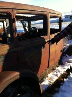

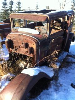

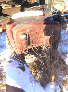

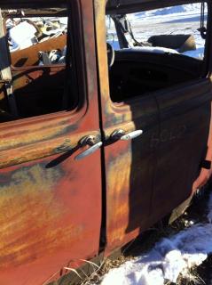

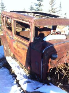

    what do you think about the overall shape? new to 1920's rodding lol its a 29 i was told that was the only year for handle etches? still cant find a vin but its made in philly and has 60176 stamped on the firewall any idea what that number would be for?model i dont have a clue...any info would be greatly appreciated.. wayne
