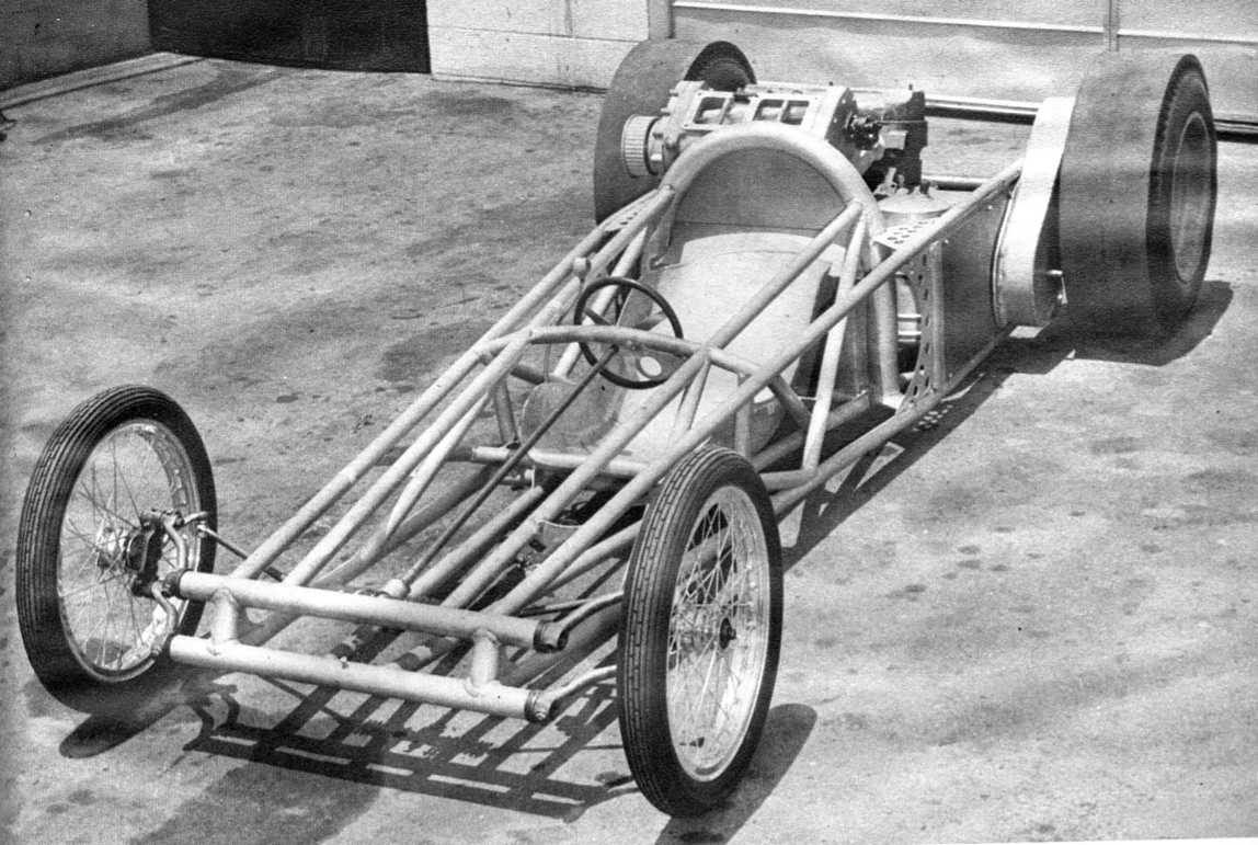

    Something like this:
    Of course the engine must be placed so that its rotation counteracts its trend to wheelstand.
    Would you be able to cut off and throw away the wheelie bars?
    Would this layout actually help traction?
    Lets ignore the added transmission friction and weight for a moment.

    No. traction, center of gravity and torque don't care.

    I think it would make it (infinitesimally) worse. In addition to the torque tending to lift the left side of the motor, the gyroscopic action of the rotating crank and flywheel would provide less resitance to wheelies in this plane than convnetional placement.

    Man, some of you guys are so full of shit...lol. It's a valid question. Somewhat theoretical, but it's an interesting thought. Think about the way a powerful dragster lifts the front-left of the car during a launch. There's a load of torque there. We aint talkin' about a wimpy little motorcycle engine, either. Obviously, it'd have some affect. The breaking trans gears issue aside, the way Mr. Garlits had his set up, it would add to the inclination of the car to lift the front, especially just off the line. To offset that tendency, the engine would have to be situated with the "front" of the engine facing the left side of the car. But I suspect that it might also tend to unload some weight from the rear tires and lessen traction. How much? I don't know. Maybe not an appreciable amount. But you can't deny physics.

    It is a good question---saw a number of sidewinders run, never saw one wheelstand...they had other problems, though. Chain drive breakage was common, but handling was also an issue, because one wheel, the one next to the drive chain, got better traction than did the other, way on the other side of the axle. So early sidewinders tended to plane when they ran, especially when they ran nitro. They vanished a long time ago.
  18. Garlits side winder experiment was an attempt
    to use engine torque to load the rear tires harder.
    Opposite of the original question.

    I agree. Also gotta mention, Garlits wasn't the first to try this, not by a LOOOOONG shot. The Kessler & Gammill Olds powered Crossley comp coupe is the earliest that springs to mind, around '55/'56, but I wouldn't want to bet the farm that was the first. Others that spring to mind are the Paul Nicolini car that Chrisman wound up involved with, the Magwinder that followed that car, there was a later Desoto powered chain drive sidewinder from back east,Art Malone had one, and around 1971, Chrisman had a Mustang funny car with a side-mounted cammer, and there was a sidewinder Challenger FC from southern California around the same time. The first car that Nicolini sold to Chrisman/Joe Mailliard was probably the most successful.

    I think someone already addressed turning the engine around 180 degrees. You'd ratehr lift the fornt wheels than the rear wheels.
    As for the gyroscope-that's highly theoretical on my part and the real effect should be insignificant. Think of the flywheel like the wheel on a motorcycle. As long as it is spinning it wants to stay in the same orientation. I'm guessing the real purpose of the experiment was to reduce friction and power or weight loss through the pinion and convnetional gears. Just a guess.
