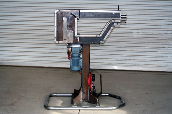

I had. HF bead roller and gave it away! I ended up making my own. The upper shaft moves in/out 1-1/4" the shafts are 7/8" and the ends turned down to 20MM with a 6MM key way ( matches Lazze's bead roller ) I haven't bought any beading dies from him yet, I made my own. View attachment 2004664 It is powered by a 3 phase gear motor 98:1 and a 120volt in 220 3phase VFD. Variable speed, forward/reverse pedals 24" deep. The sides are 3/8" with 1x1-1/2" bar top, back, and bottom then 1/2" on the sides rear half. I can bead up to 16 gage with it!
