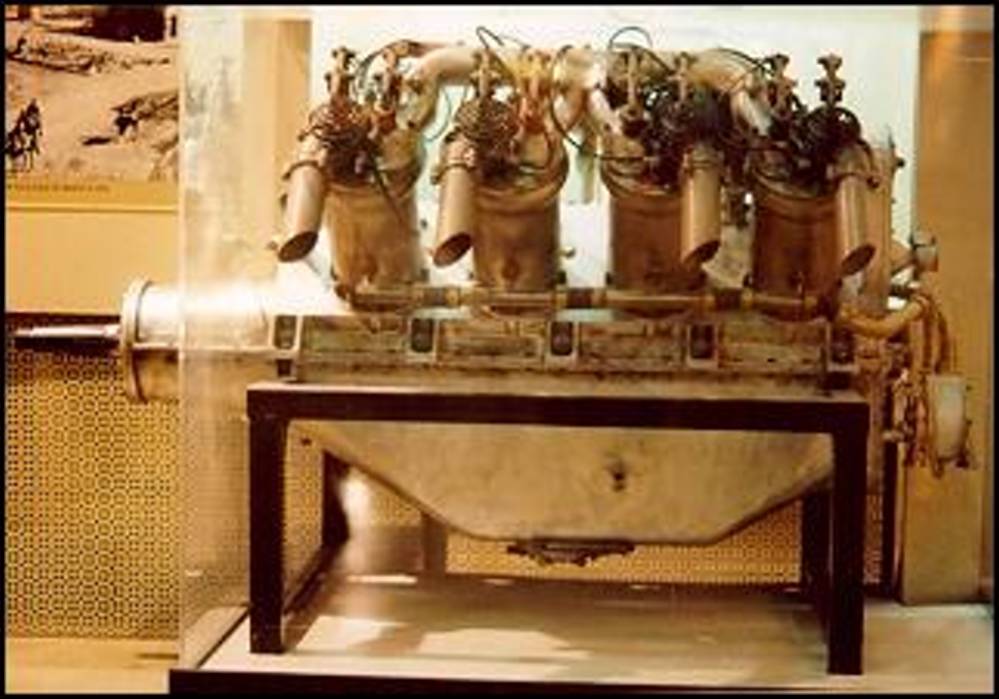

  22. That is a hell of a cool engine with the exposed rockers and all,,,cool looks for the road,,noisey as hell too I bet!
    Judging by the markings I assume the rod is English?
    What kind of engine is it though,,,old British plane engine?
    Or an old industrial engine?

  23. Truckedup
    Joined: Jul 25, 2006
    Posts: 4,660
    Truckedup
    Looks like a pre WW1 V-8 air cooled aircraft engine. Doesn't look like an early Curtiss,must be European?

    Curtiss V2-3 engine??
