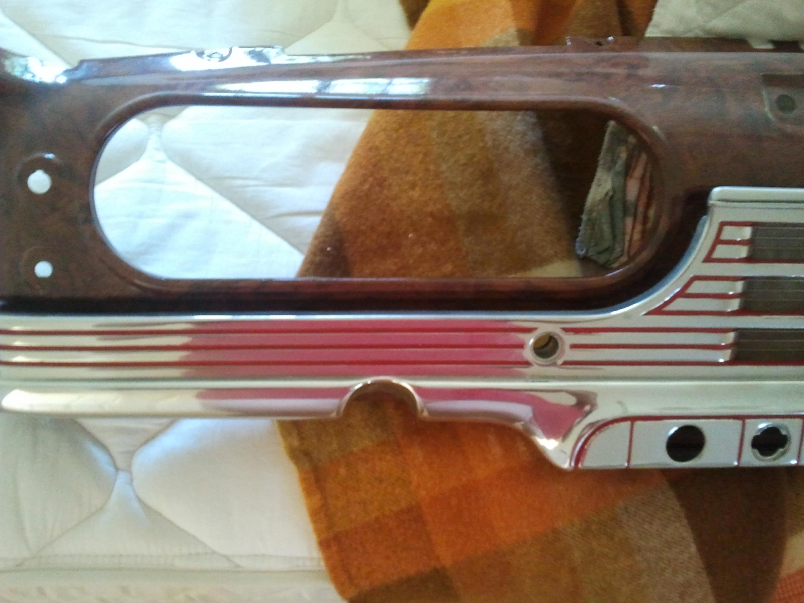

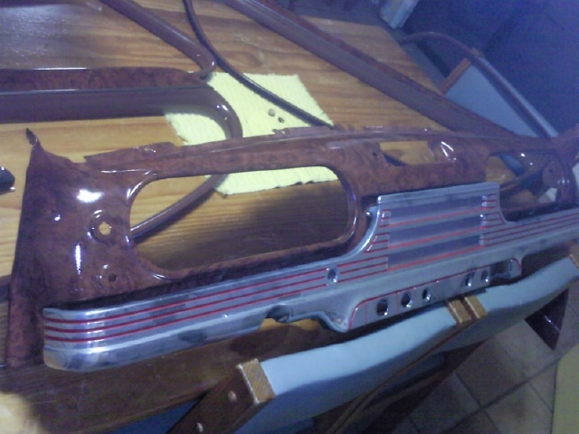

  29. Jdee
    Joined: Feb 19, 2002
    Posts: 482
    Jdee
    The 1940 Plymouth, I found this pic in our files, does this look like it?
    The Burl is nice because it blends so easy and can be used on about anything.
    Jdee
