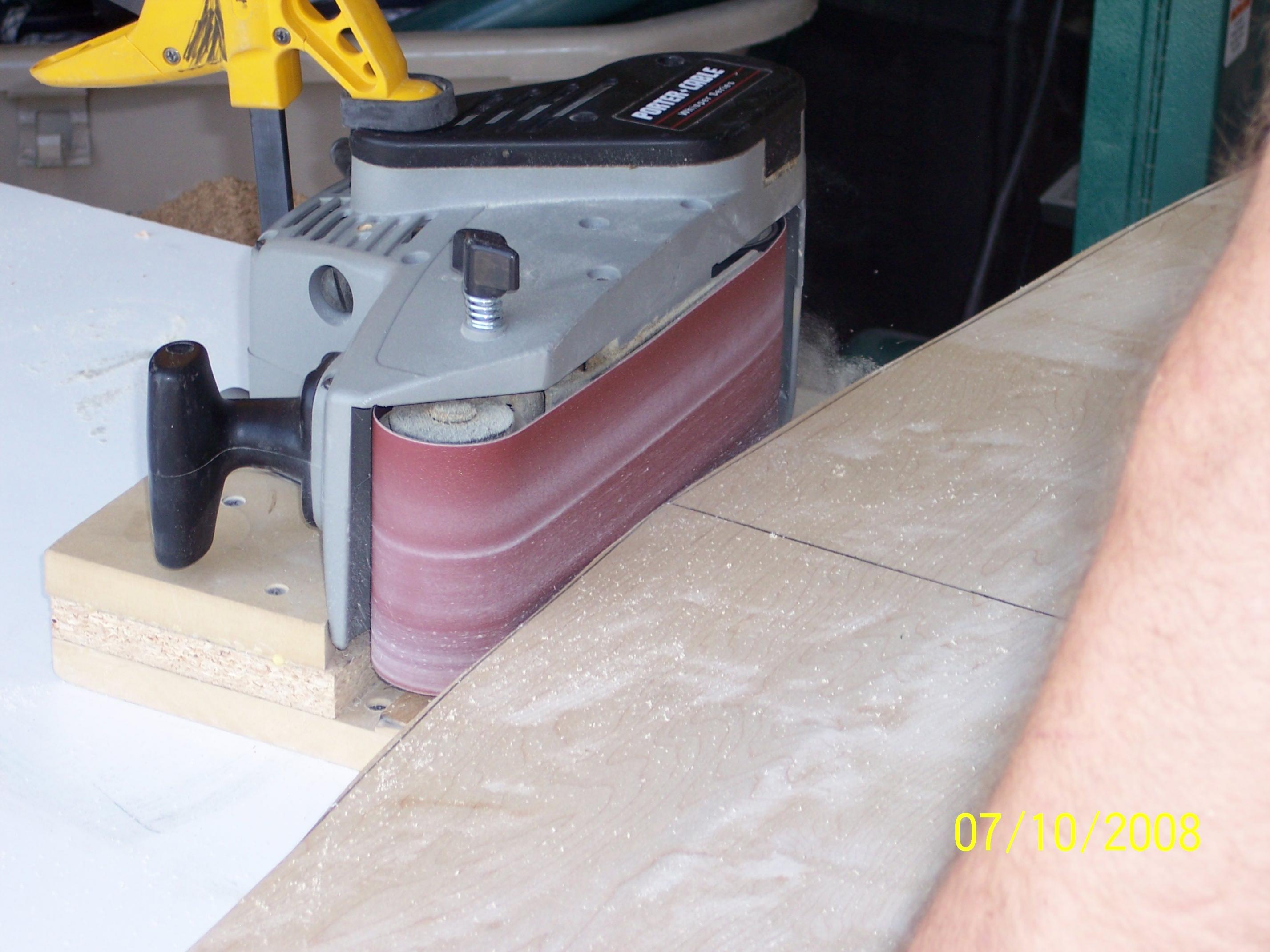

    Now transfer the pattern to the board. Notice it's a bit pointy at the bottom, but that's easy to reshape and ease at this stage.
    A bandsaw or jigsaw cuts out the shape, be sure to cut a little big so you can sand it to final shape.
    I've made a table jig to hold my belt sander at a right angle. It's just right to finalize the shape of the curve.

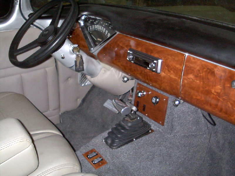

  20. gasserjohn
    Joined: Nov 9, 2008
    Posts: 1,218
    gasserjohn
    did this simple dash in 65.......still doing it's job...
    other 2 photos recent...
    try TONG OIL finish
