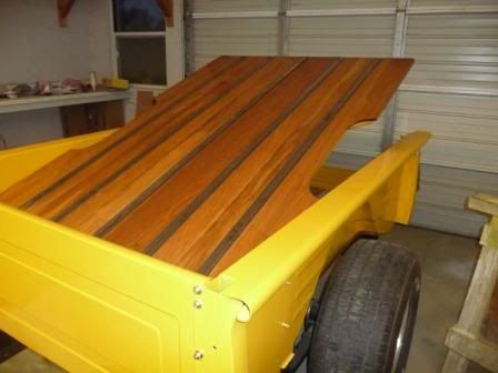

  10. TomWar
    Joined: Jun 11, 2006
    Posts: 727
    TomWar
    This is a Cherry bed with Ash strips that I built for my 58 Chevy.

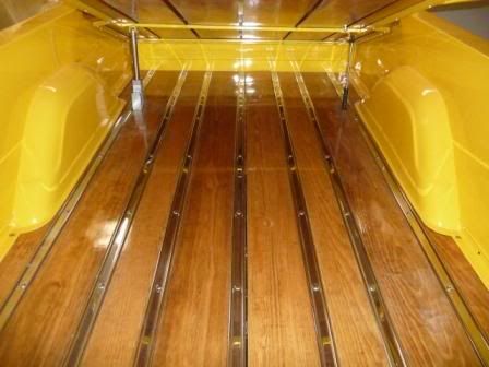

  16. Drive Em
    Joined: Aug 25, 2006
    Posts: 1,748
    Drive Em
    I use un-finished oak that I get at a store that sells exotic woods. I plane it using a Craftsman planer, and rout the edges to accept the strips. I use the stainless strips from Pro's Pick that have the hidden bolts. I stain with whatever color stain the customer wants, and seal it with two coats of sanding sealer. For the finish I use 3 coats of automotive clear on top of the sanding sealer. The automotive clear seems to hold up the best to the elements and weather.
    Here are a few I have done, the first few pictures of the black truck is Bolivian Wormwood:

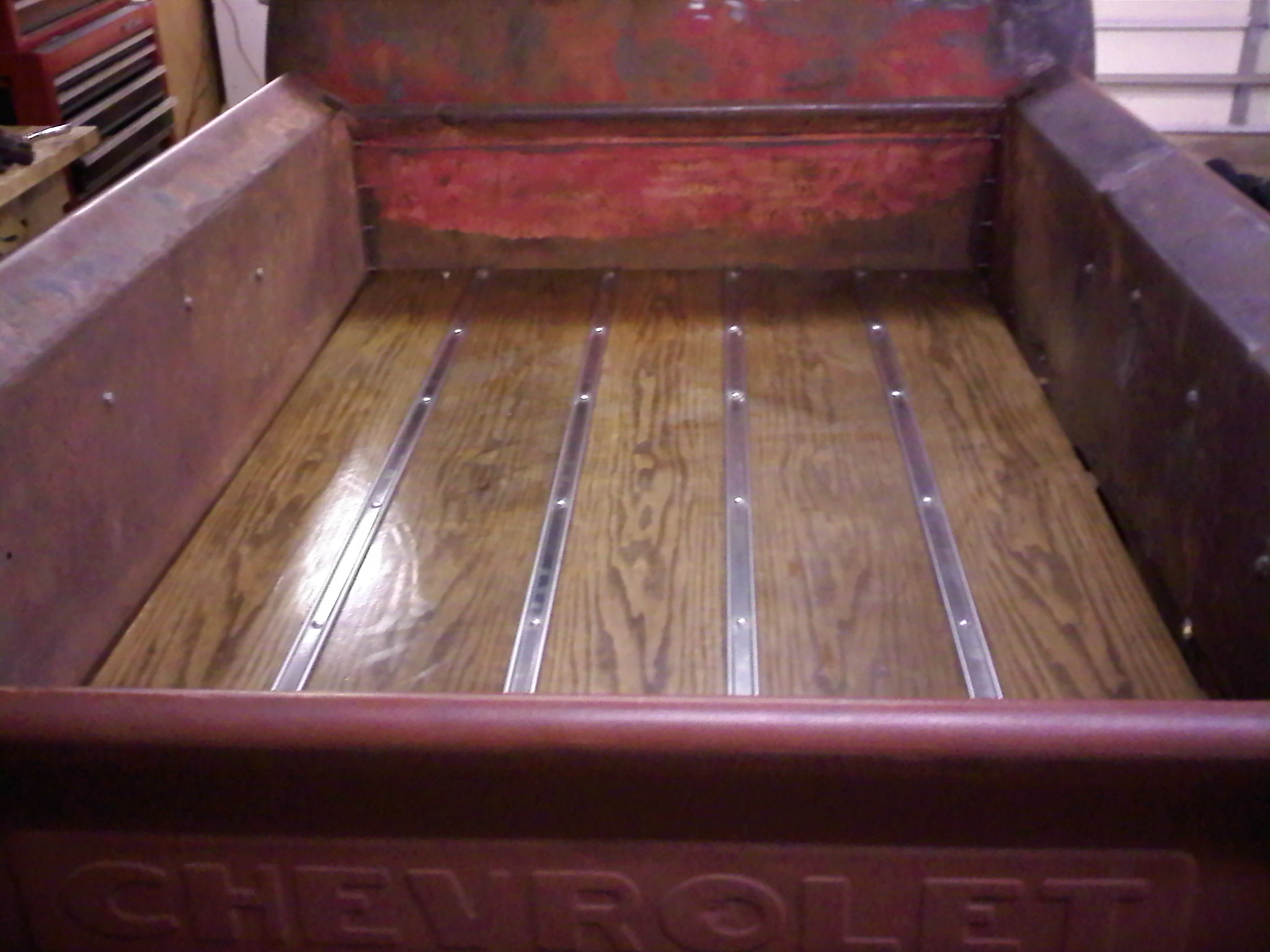

  25. Cymro
    Joined: Jul 1, 2008
    Posts: 756
    Cymro
    I'm building a bed for my chevy, I used 1" par (planed all round) yellow pine cut to the appropriate width and grooves routed for the bed strips, my finish will be Danish oil, possibly tinted to age it, i'm toying with the idea of scorching the wood first with a blow torch, running a wire brush with the grain prior to finishing, I think I'll do a test piece first, or I'll simply let nature take it's toll. It should look better than the decomposing Sterling Board (OSB) i had been using. Incidentally this was the cheapest timber I could find.

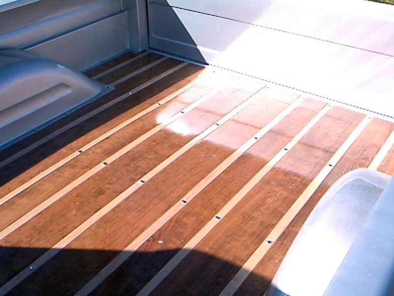

  27. dan sutton
    Joined: Oct 21, 2008
    Posts: 196
    dan sutton
    Here is my choice...oak wood, cabinet grade, stained and sealed with epoxy, SS strips
