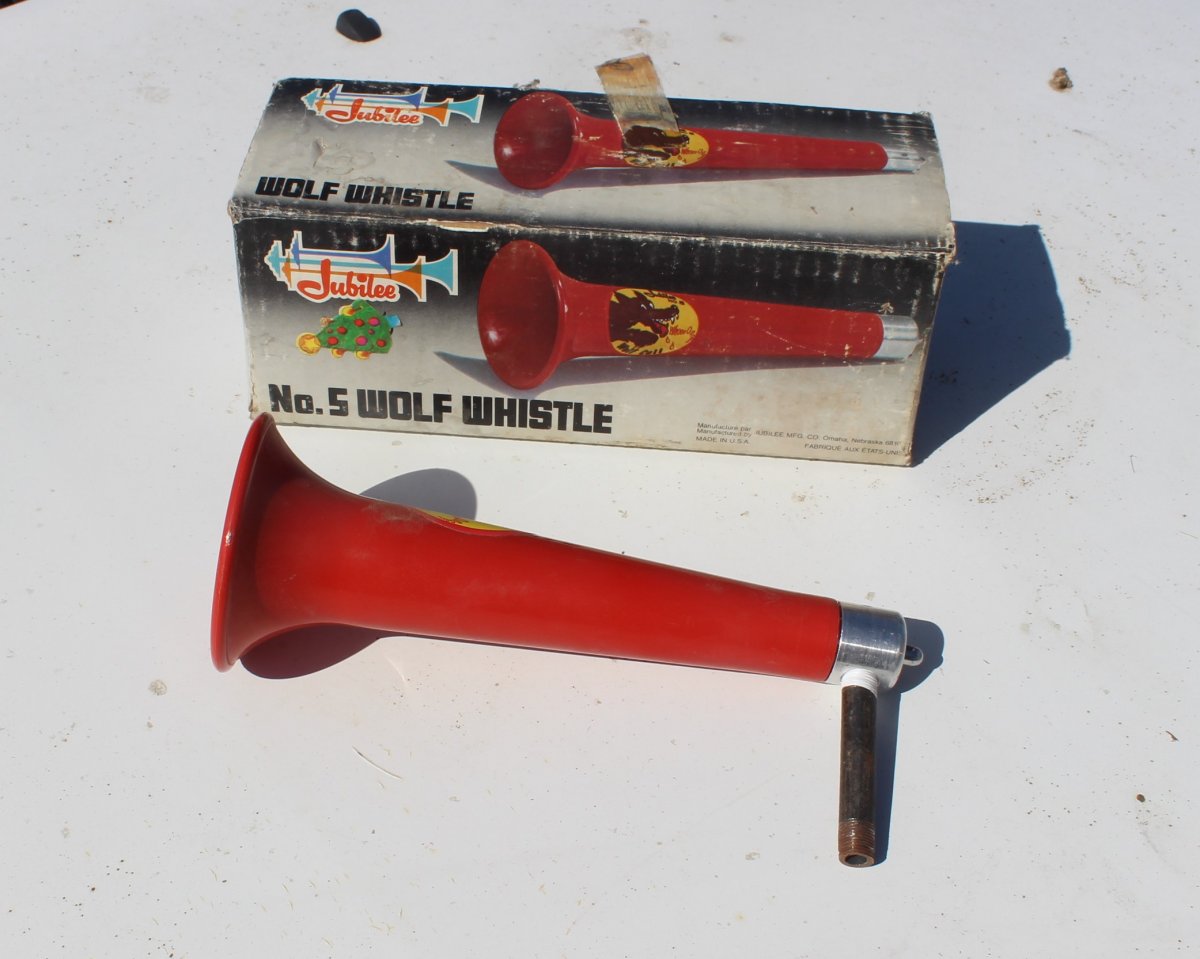

    I didn't find the twin to that one (yet) did find the Jubilee Wolf whistle that I got at a swap meet a few years ago. !/8 pipe nipple out the bottom to connect to a fitting on the intake on it.
    That makes me think that all you need are the correct fittings to connect yours to your intake. That is going to be a bit different from one engine to another anyhow. IMG_9136 (2).JPG
