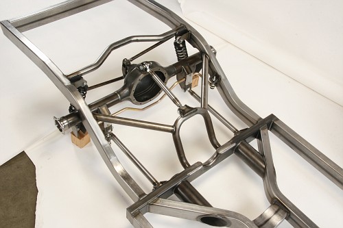

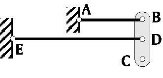

    I am chasing info and guidance on a wishbone 3-link rear suspension setup I would like to try (if it is possible and will even work).
    Bottom wishbone link (1 of) attached inside frame on each side and under the middle of diff centre. This would effectively be a triagulated link and negate the need for a panhard bar (???).
    Top links (2 of) attached outside frame running back to mount above axle tubes at outer ends.
    The following images are the general idea, but I want to switch the top and bottom arm setups. Is this able to be done? Application is for low to mid power street use. Must handle well and be a reasonably comfortable ride. Info on arm geometry and lengths would be appreciated, especially with regard to recommended anti-squat and roll characteristics.
    So, what is the concensus. Really hope we can keep this on track and informative. There are lots of us out here that are all ears and ready to learn.
    grumpy65

    Having the triangulated link pointing rearwards [1st photo] will keep the roll centre height consistent regardless of ride height [ the RC is attached to the rear end ]
    Having the triangulated link underneath lowers the roll centre which will soften the rear and induces some understeer but stiffening the rear roll stiffness would remedy this [or softening the front].
    Having the roll centre low increases traction on the outside tyre during cornering [overturning moment] so this is generally more desirable.

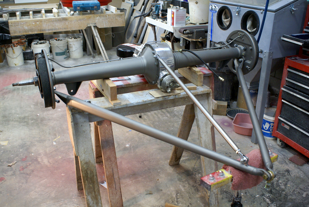

    _MG_3265-vi.jpg DSC02471.JPG Doesn't sound like any traditional build going on here. The closest would be a arm running from a banjo center section forward to strengthen rear end when removing torq tube and going with a open drive shaft. This will get you in the ballpark.

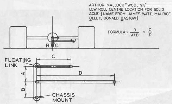

    A triangulated link isn't favourable with racers, because it is either above or below the rear-end.
    A popular method is the Watts-link [with a 4 link] but they cannot be mounted too low because of the Bell-crank.
    There is a modified "Watts-link" called a "Wob-link" that can get very low RCH's [designed by one of the greatest suspension guru's..........Arthur Mallock]
    Attached is a drawing of the "Wob-link" [the short arm has a greater Arc than the long arm, which is cancelled out by the bell-crank causing a vertical path]

    Thanks 1946caddy. Pictures are food for thought and the link is definately useful. No, I guess it is not very "traditional", but the info Kerry and others are supplying is relevant to all builds and if we all learn and benefit from it, it will make everyones rides more pleasurable and maybe safer. A good thing surely, traditional or not.
