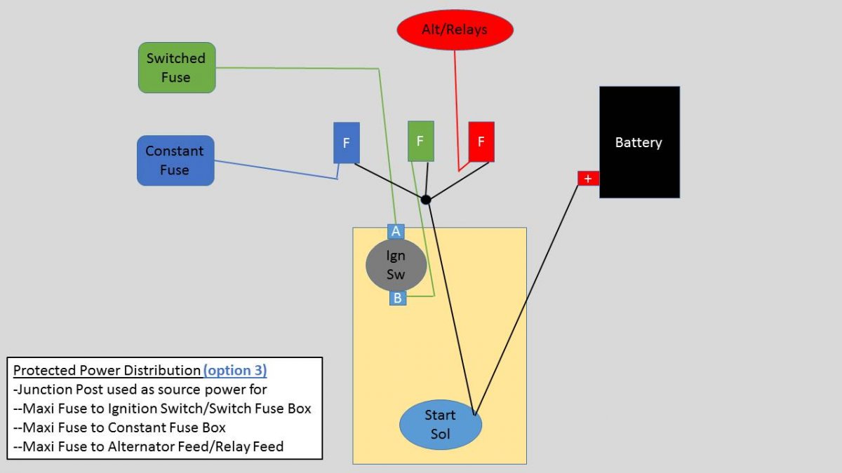

    I have been planning out how I want to wire this project with off the shelf components but not as a kit and decided to start a topic here to serve a couple purposes. First, I have several questions concerning best/most efficient way to run certain circuits and to gets second opinions/fact check my diagram/schematics before I run wire. Second reason for takin up your time with this post is to hopefully be a resource for others to reference as well. I plan to go circuit by circuit here.
    I’ll state that while I feel competent when it comes to wiring, I have never wired a car from scratch. At first I was going to buy a kit harness but none that I researched had what I was looking for without giving me excess that I didn’t need or would require me to have to add quite a bit to. I picked up a couple books on automotive wiring that turned out to be a pretty good review and gave some info I had not thought of before. Honestly, some of the best education I have found is right here on the H.A.M.B notably from Squirrel and Crazy Steve. There are other members that give good pointers/advice but these guys have been helping folks out here for years continuously on this topic.
    My project to wire is a fiberglass bodied T roadster that I am working to build to replicate the look of a 60’s Altered. Issue with this car is space, it does not have any. This build does not require a lot of powered accessories.

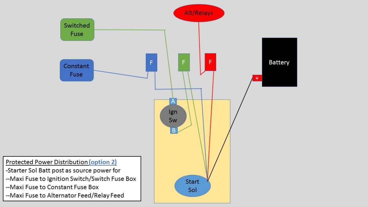

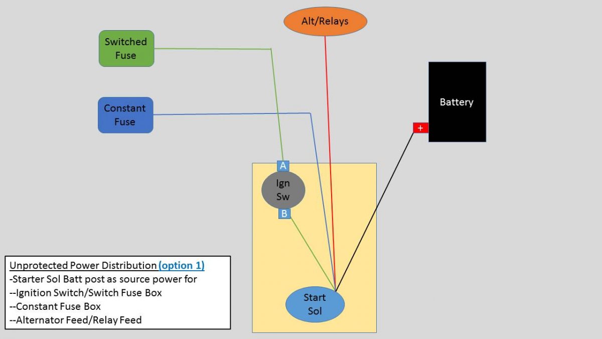

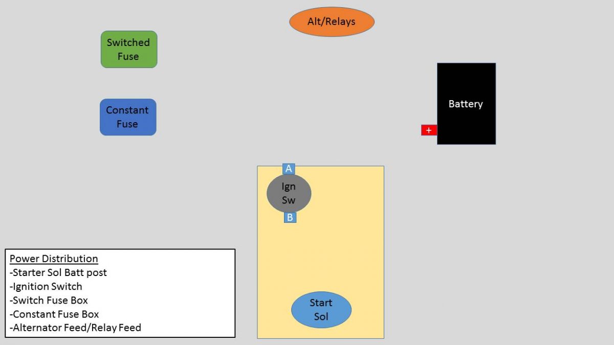

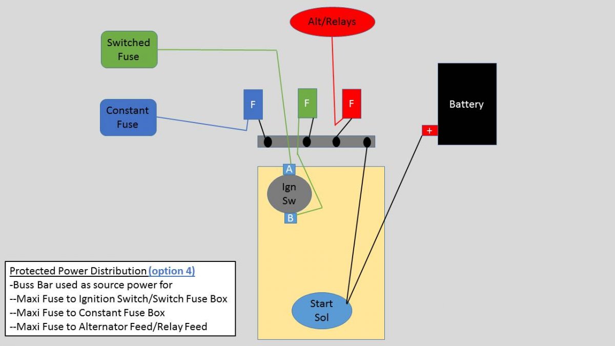

    I hope to continue this thread with a brief explanation of what I hope to accomplish, a diagram of how I would like to/or think is a good way do it, and hopefully feedback as to if it is a good plan or if I should consider a different approach. Warning: I tend to “overbuild” sometimes and feel I am starting to overthink this part of the build so pull me back if I need it.
    Power Distribution
    I am using two 6 circuit fuse panels (one constant and one switched power) both on interior on firewall, a Ford starter solenoid in the console, a universal 4 pole ignition switch in the console, an AGM Battery on the interior on the firewall, 10SI GM 3 wire alternator, 3 standard relays to feed.
    -Switched Power Fuse Box powers Fuel Pump relay trigger, Radiator Fan relay trigger, Trans Cooler Fan relay trigger, Gauges, and Tach.
    -Constant Power Fuse Box powers Horn, Headlight Switch, Haz/Turn Signal, Brake Light
    -Relays powered off of Battery/Alternator feed.
    -My question is how much over current protection does the power distribution part of the system need and what is the best method to do it. I would think I need to protect the feed to the Ignition Switch in turn protecting the feed to the Switched Power Fuse Box, protect the feed to the Constant Power Fuse Box, and protect the wire to the Alternator which feeds relays as well. Problem is what do I use for protection. Fusible Links inside the car would be a bad idea I think. Maxi Fuses are kind of bulky but I could hide or cover them. Below are a few ways I saw to wire this. Let me know your opinion.

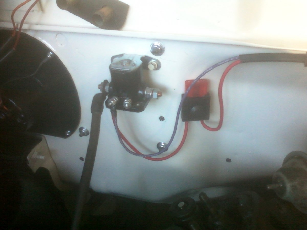

  2. My head hurts at the thought of a project like that. I have more money than time, so I went with a kit for my Ford. There were a lot of upgrades within the kit over what I had. I have a 50 amp maxi fuse in my wiring. Pretty basic and it protects everything from the solenoid back through the car.

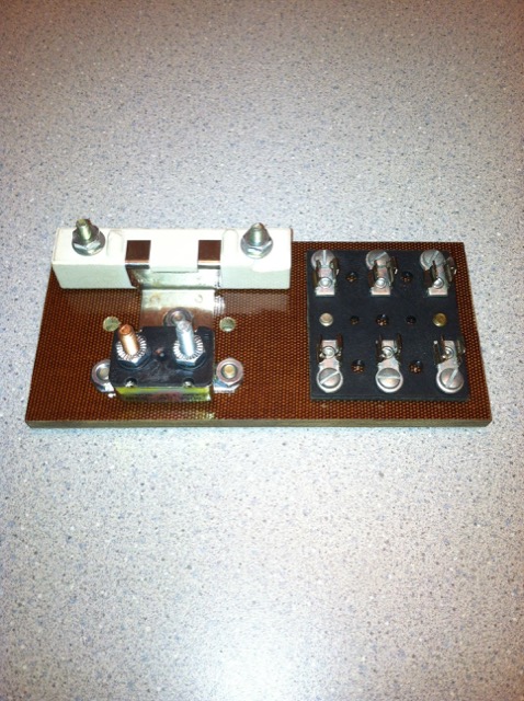

  11. Here the fuse panel I made for my '35 along with the wire harness "kit". Basic hot rod with a simple electrical system. Only modern stuff are a horn and ignition relay along with some relays to make a four wire signal switch work.

    Determining fuse sizes are based on wire size #10 wire=30 amps
    #12 wire=20 amps
    #14 wire=15 amps
    # 16 wire=10 amps
    These are just guide lines to protect the wire feeding a given device.
    The main thing is don't burn the car up because of the wiring.
    Use a circuit breaker for the headlights.
    KK

    Big question I have right now is what method did you use to (kit or not) protect the wiring to the fuse box/alternator/ignition switch/relay power feeds. Did you use fusible links, Maxi fuse, MIDI fuse? Did you use one of these methods for each run? Keep in mind this is all inside the car and I'm leaning away from fusible links for this reason. I'm tempted to use a MIDI fuse since its smaller than a Maxi in size but is still a slow blow like a fusible link.
    thanks

    To answer your original question, I would go with option 1. I don't see any reason to fuse protect a fuse panel! The other options add complexity and additional chances for component failure. I'm a big believer in the KISS theory of keeping things simple.
