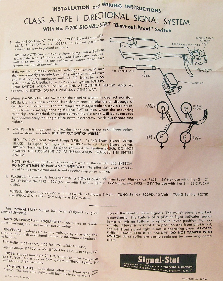

    Sorry to bring an old thread back from the grave, but I have to thank Zombie for the attached diagrams. I started on my turn signal wiring today and it took a couple of seconds of searching to find the diagram I needed.

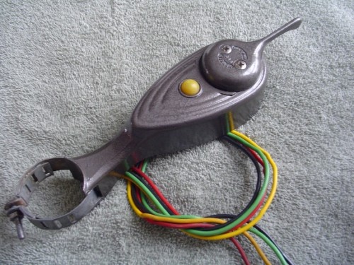

    I've got a Signal-Stat 900 with a FoMoCo tag on one of the wires, but the wire colors don't match up with the diagrams I've seen.
    I've got wires colored:
    green
    red
    blue
    yellow w/brown stripe
    green / white stripe
    white w/ blue stripe
    Anyone able to help with this?

    time to knock the dust off this one,i grad a signal-stat 800 from a scrapper.any diagrams for it? it has 8 wires
    2X grey
    2X red
    also 1 of each-color of wires- green, with black,blue & yellow going to flasher & a brown away from flasher {to dash?}

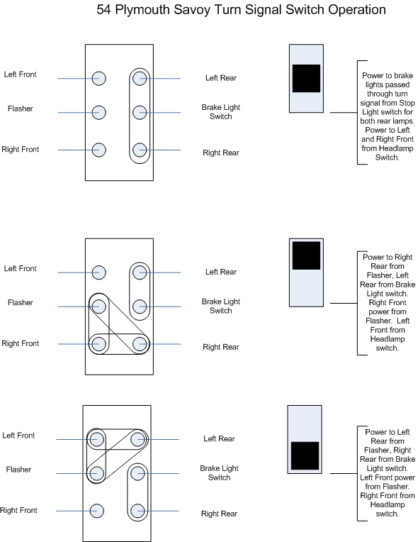

    When I pulled my steering wheel off the factory turn signal switch had all the wires cut so there were no colors to match back to a wiring diagram. Also, the diagrams I had did not show wire positions on the switch so I had no idea what terminal did what.
    I had to use the meter to do a continuity test to figure out how it worked. I'm an idiot so it too me a lot longer than it should have but the same theory should apply to some other 6 wire signals. Here is the "logic" diagram I drew up after I tested all the terminals on the switch...

    Add one to the list. I found this one for a Signal Stat 700.

  24. I'm trying to wire up an old Signal Stat switch to an American Autowire harness...the guy at AAW was no help at all, and I am no electrician. I found a diagram on a Jeep forum, but it shows two wires to the flasher with no delineation about which one goes to what post. Is there a diagram that shows the adaptation of an 800 to a mid-80's GM switch like AAW uses, or would Squirrel's info work? If I tried hooking up power and trying to find out what's going on, I just might burn the whole mess down. :)
    brEad likes this.
  25. Well, I'll try. :) I'm no electrician, and some of the terminology is lost on me, but I'll see if I can get through it. This Signal Stat 800's wiring diagram isn't very detailed. Thanks for your going to the trouble of explaining this!
  26. I got this from a gentleman at AAW... customer service is still alive and well, it seems. :)
    "Since you are using the Dash Indicators, the BLUE wire will remain UNUSED.
    To break it down for you:
    Sig-Stat GREEN goes to AAW Light Blue (Left Front)
    Sig-Stat RED goes to AAW Dark Blue (Right Front)
    Sig-Stat YELLOW goes to AAW Purple. (Flasher Feed)
    Sig-Stat GREY goes to AAW Yellow. (Left Rear)
    Sig-Stat BLACK goes to AAW Dark Green (Right Rear)
    Sig-Stat Black w/ GREY TRACE goes to AAW White (Brake Feed)"
    When asked about the red/green wire, he said "That would be if you were running single filament bulbs in the front, and needed to supply power to them for your park lamps. Since the park lamp circuit is already installed in the new AAW harness, this wire will remain unused. "
    Here's the diagram...the one posted earlier seems to have a broken link.
    brEad likes this.

    Since this subject keeps getting drug up, here is how to wire a turn signal switch that you don't have a clue as to the wire colors. First, get a VOM meter or continuity tester of some sort. Mine has a buzzer that indicates continuity. With the switch in the neutral position, find 3 wires that have continuity. Now switch to left turn and see which of these are connected. Switch to right turn and see which is connected. The wire that shows up in both these tests goes to the brake light switch. Label it as such. When the switch was turned to the left, the other wire in this test should be labeled right rear turn, the remaining wire of these 3 is left rear turn. Go to the remaining wires and switch to left turn and test for continuity. Test again for right turn. The wire that shows up in both tests you label as flasher. The one that tested on left turn is left front turn and the other one is right front turn. If you still have one wire left over, it goes to another flasher for the 4 way. If you are dealing with an OEM switch located under the steering wheel there will be another wire for the horn. I hope that this helps.
