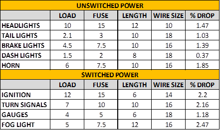

  29. Thank you all for taking your time to look at my diagram and provide feedback....I am very humble and would like to learn everything I can...
    As I mentioned earlier, I am electrically CLUELESS but doing my best to learn, understand quickly and hoping to put together a good/sound harness for my roadster.
    I went back to the beginning of the thread, as Steve suggested, and started reading every post.....Glad I did! I think I understand some of this stuff a bit better.
    If understood correctly, I learned that I have 24.1 amps on the unswitched side, of which 13.6 is the continuous load making 18.4 the total of the unswitched load.
    On the switched side, I have 28 amps, 16 amps of continuous load and with a total switched load of 28.6 amps
    Went back to the car and decided I would place the fuse box and battery under the seat, for easy access. Measured my lengths and this is what I ended up with....wire and fuse sizes changed from my original diagram
    Does it look correct?
    Bowtie Coupe likes this.
  30. Only two things I'd change, and they're minor. One, I'd bump the head/tail/brake/dash light fuses up one size. The wire you have specced is big enough and that will help prevent nuisance tripping if a lamp shorts/burns out. Two, I'd bump the horn wire size up to 14 and use a 15 amp fuse. A horn is technically a 'motor' and can have considerable current inrush when first energized. Other than that, looks good.
    Great voltage drop numbers; you'll have nice bright lights!
