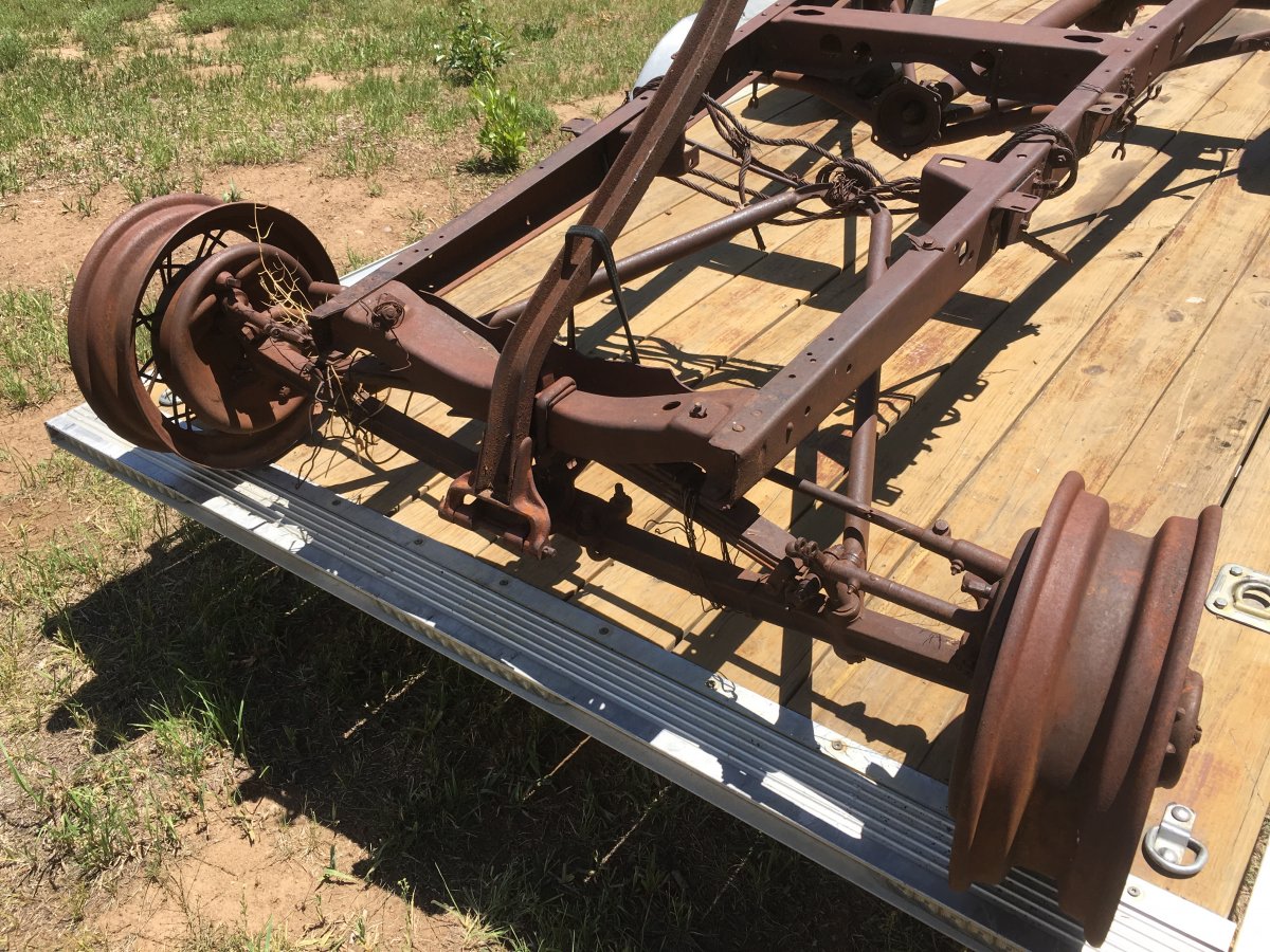

    Used a Warn 8000 pound winch to drag this A chassis On my tilt trailer. Winch is inside tool box and is equipped with a wireless remote. I can back my trailer up to the four post lift and using a snatch block and the winch, I can put a dead car on the lift. Changed from a cable to a rope last year

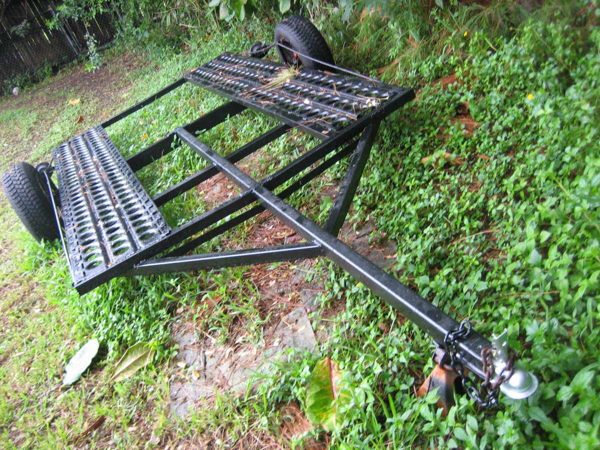

    1. Y-blocks
    Nope,just a come-a-long,chain n rope some rags an a trailer I built in the 1960s out of scrap I could find at the time,towed all kind of cars,race cars,hot rods n buddy's that needed help. Replaced the come-a-long a few times. That has been handy many time for a lot of things,even engine lifting. It all still works,but tail lights come n go. 002.JPG
