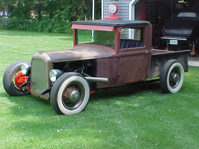

    10-12 years ago I built a channeled hot rod truck from a $400 '29 Plymouth 4 door sedan. I sold it to a guy who "had to have it" when it was only about 80% completed. In fact, I had never driven the truck. Last year the guy sold the truck at an estate sale and I bought it back. I am in the process of changing a few things I did back then and one of those issues is the location of the master cylinder. It is tight quarters in the cab, especially in the feet area, so I had located the master cylinder on the left side of the steering column and intended to brake it with my left foot. There is also very limited room on the firewall. Now that I have the truck back I dont like that set-up and want to move the pedal onto the right side next to the gas pedal. The only set-up I can find that is small enough to fit in the space is the Wilwood aluminum master cylinder and pedal assembly. Speedway sells them and they are not much $$. But I am concerned about using a race-intended m/c on the street. I know its a single resevoir unit and I understand the ramifications of that, but it is the only thing I can see working on the right side. Sorry for all the background, but here is my real question...some of the Wilwood brake stuff is marked "Not Intended for Highway Use". Is that just a liability statement or is there something I dont understand here?

    I can't help you out with the M/C, but that turned out a lot better than I thought after reading what you started with.
