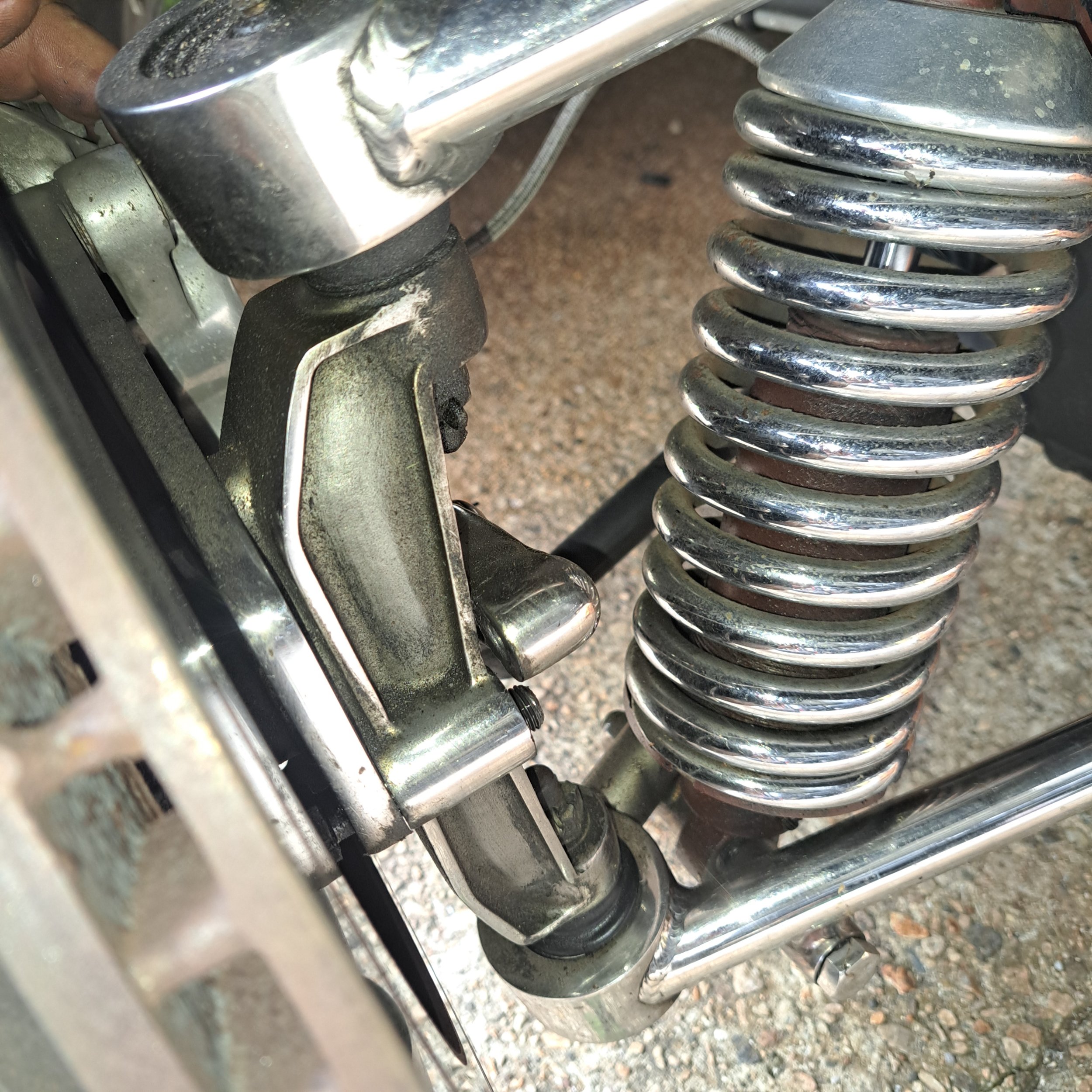

    I have the older Wilwoods that had the external line connecting the halves on my 28 A PU with power brakes on GM 11" rotors on a mustang type II suspension.
    More brakes than the 205/60-15 tires can support .
    They look nice on a fancy chrome and SS suspension but you can't really see them .
    Lot of muscle car guys run them hard for many miles.
    the lighter unsprung weight is nice , aftermarket rotors would be even better.
    I didn't need power brakes and im even considering removing the booster as there a bit touchy and easy to lock up
    Here is the suspensionthr day a bolt to the arm came off :(
